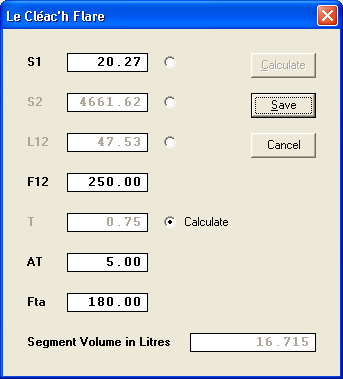

Well, my plan is to make a LeCleach horn for a JBL 2" driver.
Hi Chris,

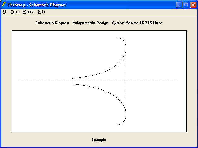

All you really need to know are the exit area, exit angle and low frequency limit of the compression driver. If the exit angle is unknown then simply make an educated guess - it will be close enough.
Procedure:
1. Use the Hornresp Horn Segment Wizard to determine the required horn given inputs S1, F12, AT and Fta. For the example shown I have assumed a 2" diameter driver exit area, an exit half-angle of 5 degrees, and a required horn cutoff frequency of 250 hertz.
2. Calculate the results for Ang = 4.0 x Pi and Eg = 0. By setting Eg to zero, a constant velocity driver is assumed - it doesn't matter what driver parameter values are used.
3. Export the exact axisymmetric profile and use the data to construct the horn.
Kind regards,
David

I am going to use a JBL 2441. I think I have read somewhere that the exit angle is 10 degrees on most of the JBL drivers, so this shouldn't be to difficult.
Thank you very much, David!
Yeah, I hoped it was pretty simple to design a horn using a compression driver. I think the difficult part comes in with the crossover. At least that's the case with me.

Hello Dirkwrigt,
From Hornresp you can export the impulse response of the horn you designed in .wav format then you can import it in another software to play with crossovers on that impulse response.
I use often (depending on the computer) either CoolEdit Pro or Adobe Audition to perform such simulation of a crossover on the horn response.
