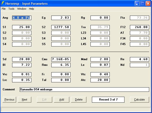

I have a Bruce Edgar tractrix horn made for a Dynaudio D54 driver from 20 years ago. I'm trying to model it in Hornresp. I've used the datasheet for the D54 driver to model the horn, but it sure does look bad in the SPL simulation. The directivity is horrible as well, being omnidirectional below about 1 KHz and becoming more and more directive above that. I've attached the input screen I used. What I did was enter the driver data, then use the system designer to make a 311 Hz full size horn. I'm pretty sure this Bruce Edgar horn is actually a 300 Hz tractrix, but intended for 500Hz to 5KHz response. So, I changed the throat size to the 25 sq cm since I know that the throat is 2" square for the 2" D54. There is no throat adapter. It's a round dome stuck in a square hole. I've used my TrueRTA software real time analyzer and on axis the response looks good but I didn't do much more with it at the time. I'm wondering how I can improve this horn system. Should I make a throat adapter? Should I get a different driver, like a 2" compression driver? Should I just toss all of it and start over? Ideally, I'd like constant directivity over the pass band of 500Hz to 5KHz, if possible. I guess I should measure the horn better to see if there's another driver that would give better results.
For constant directivity over that range, look at an OS flair. You'll also need a larger mouth as you've found out to get the pattern control at low frequencies. However what might be a better idea would be figuring out the necessary mouth size to match the directivity of the horn to whatever driver or horn you'll use to reproduce the frequency band below this horn. If you're using a direct radiator, the mouth should be around the same size as the driver's cone.
I dug out the horns and measured them and put the parameters into Hornresp. It's actually about a 260Hz horn. The results are still terrible. Should I look for a different driver? What features would I look for if I wanted to do replace the D54 with something else? I'm not sure the T/S parameters are much use for midrange and higher frequency horn drivers, since I have read that at these frequencies the suspension dominates the response, as Bruce talked about in his article.

So basically, the consensus is to toss this Edgar tractrix horn and start over? Jeez, I hate to do that. I'd rather find a better driver for it, or modify it somehow, or both.
I assume that compression drivers cannot be modeled in Hornresp since their T/S parameters are generally unknown, is that right? Also, how can someone predict the response of putting a particular compression driver on a particular horn? Would I just look at the FR provided by the manufacturer and assume that the horn + the driver would be the same or similar?

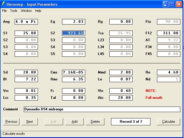

Thanks. I think I'll do some actual measurements on the horn and driver I've got before doing anything else. I did a brief real time analysis using TrueRTA and it looked good from 500 to 5KHz.
http://www.diyaudio.com/forums/atta...8919-hornresp-dynaudio-d54-corrected-horn.jpg
Hmm, haven't actually compared measured to simmed, but seems to me that when simming a sealed back driver that Vrc/Lrc should be left blank since the rear chamber's affect on the driver's T/S specs has already been accounted for.
GM
GM
GM
Thanks! That makes a huge difference. It's more in line with what I measured now.
