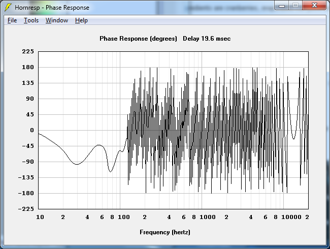

Phase is 180 degrees different in new version?
Has anyone else noticed this?
New version of Hornresp on the right, previous version on the left.
This is my T-6 tapped horn, the exact same record was used in each version. My actual measurement of this design (acoustic phase, groundplane, 1 meter) looked a lot more like the plot on the left.
It looks like there is a 180-degree change between versions here.

I think that there has been an update on the update!
The version I just downloaded shows 23 at the end.
Maybe we have a fix?

Hi littlemike,
The phase reversal is due to the second change advised in my Post #2332.
Could you please post a screenprint of your input parameters window so that I can investigate further. Thanks.

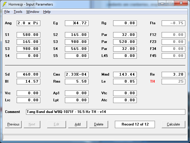

Inputs below.
It is not just this model, everything I have worked with lately shows a 180 degree shift. I selected this one because I have measurements of SPL and phase.
Here are the measurements, the speaker and amp were wired in phase. Note that the phase stays near zero, consistent with the older models.
