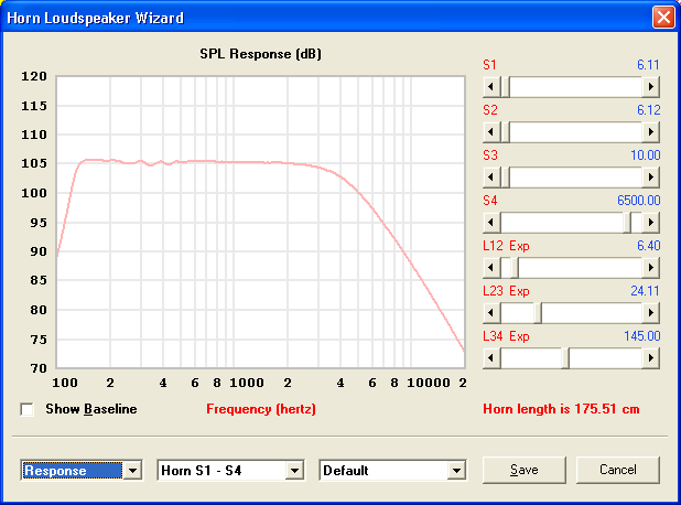

The Loudspeaker Wizard tool chart frequency range
Hi David,
Must have missunderstood😱. Can´t make it work. Give me a hint.
Must have missunderstood. Can´t make it work. Give me a hint.
Hi Lars,
Display any one of the Loudspeaker Wizard charts and then move the mouse pointer over the "Frequency (hertz)" label beneath the chart. The font colour should change from black to red to indicate that the label has been activated. Now double-click on the red label, and the chart frequency range should change.
The screenprint below shows the response chart with the frequency range changed to 100 - 20000 hertz. (The impedance and displacement chart ranges are also changed automatically).
Could you please confirm that the functionality works as described above. Thanks.

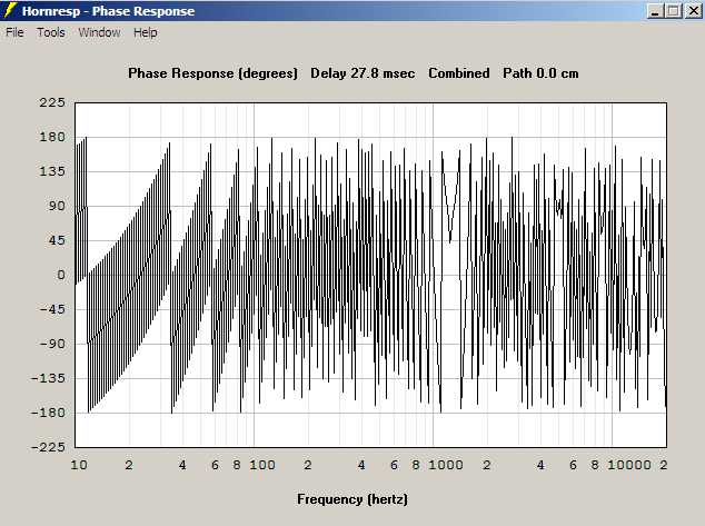

I may have found another minor bug (Version 2870-111003). The sensitivity of the phase screen plot seems to need a little tuning, this is especially obvious on vented (bass reflex) enclosures, or so it seems. I found a particularly nasty looking one, I'm attaching a screen plot of the phase response with the default delay (you have to go to delay=0.0msec before the excessive "wrapping?" goes away) and the Hornresp export file.
Hi Oliver,
Thanks for this feedback. I had noticed the same thing myself, but never got around to investigating it - I had assumed that the phase of the combined signal would be pretty weird anyway 🙂. It is interesting that changing the path length difference from 0 cm to 1 cm tidies things up considerably.
I will have a look and see what I can find - at this stage, I am not really sure where to begin though 🙂.

Hi David,
Yes, changing the path length tidies things up considerably, hadn't noticed that.

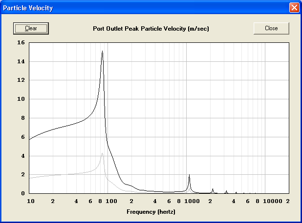

I have been fooling around with some vented subwoofer designs. I think there may be something amiss in the vent air speed velocity calculation. When I increase voltage input the velocity does not increase accordingly.
Hi Mark,
Could you provide a specific example, please?
The test I did seemed to work okay - I simply took a copy of the default record and changed Fr to Ap, then compared the port air velocities with Eg = 2.83 volts and Eg = 10.00 volts. In the attached screenprint the gray trace is for Eg = 2.83V and the black trace is for Eg = 10V.

I think that I am unable to simulate the vent air particle velocity. I'm able to easily simulate the driver particle velocity.
It is quite possible that I am just not doing something correctly.
I see that you have a screen heading that indicates vent particle velocity.
I must admit to not being able to figure out how to get there.
Hi Mark,
To chart the port outlet peak particle velocity first use the Combined Response tool with a blank entered to display the port SPL response, and then select the Particle Velocity tool.

I will have a look and see what I can find.
Hi Oliver,
I found the problem - it will be fixed in the next release. Thanks again for the feedback.
