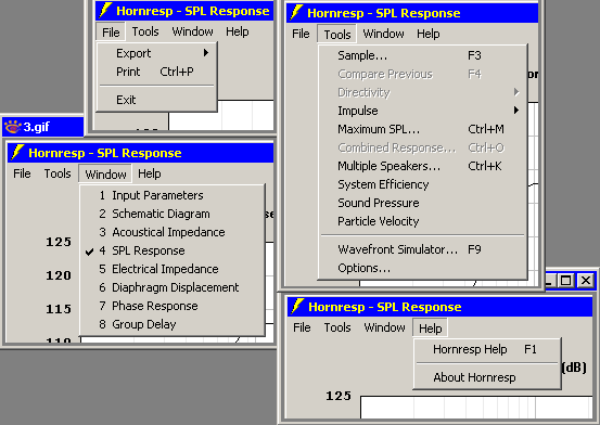

Please see my screenies. I can't see how to launch LW from the Menu Bar ? Also that & several other options are Greyed out in the default design ?
Hi Zero D,
The Loudspeaker Wizard tool works with single segment conical and parabolic horns, and all multiple segment horns. The tool can be accessed from the Input Parameters window when in edit mode, by selecting the Tools > Loudspeaker Wizard menu command.
See page 11 of the Hornresp Help file for further information.
To quickly see how the tool operates, simply display the input window for default record 1, press the Add button to create a new record, and then select Tools > Loudspeaker Wizard.

Hi & Thanks for posting, & the program, i'm now able to locate the sliders etc 🙂

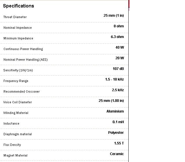

Can anyone point me to how to calculate a horn using a compression driver, and how to eventually calculate the throat angle of the horn (using Rta?)? My apologies if it has been discussed earlier in the thread.

Compression drivers have mechanical parameters just like any transducer. That means you can calculate T/S parameters for them if you want. However these parameters are not typically published. For some of the new JBL drivers, you can get a lot of the parameters from the data sheets published on the Audio Heritage website.
OK, here are the specs for the B&C DE10 1" compression driver. Is it possible to calculate T/S parameters from this data? I'm sorry I'm not expert enough to know how myself.
