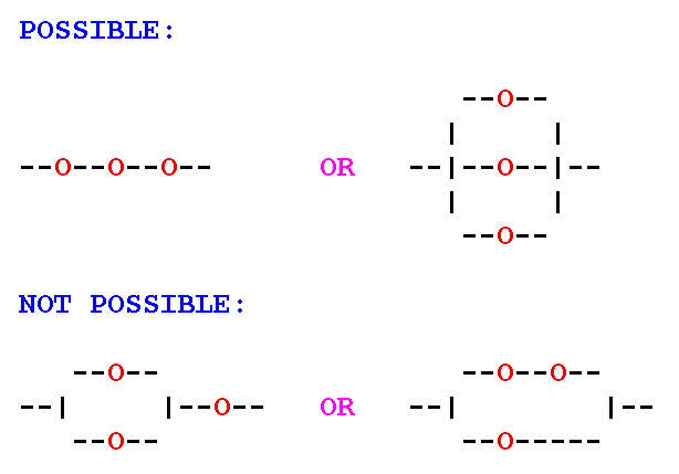

Is it possible to setup series parallel simulation on three drivers? I have tried but keep getting bumped back to one driver or two drivers. But not three. I'm trying to work on a 2.5 way enclosure.

Hi Mark,
In Hornresp, three drivers can be connected in either series or parallel only. It is not possible to have two drivers in parallel connected in series with a third driver, or to have two drivers in series connected in parallel with a third driver.
Kind regards,
David

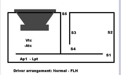

1) I am still little confused with my offset horn, with two drivers and throath chamber, I am not sure about volumes, so I make little example. Please tell me if it is correct. I am not sure if I have two paraller speakers in two rear chambers, if I put volume of just one, or two chambers, etc with Vtc, Atc...
2) To the volume Vtc I have to include a volume of Cone, or hornresp count with this volume automaticly ?

Hi Pendapon,
1. Hornresp assumes that the two drivers share a single rear chamber and ported throat chamber as specified by Vrc, Lrc, Vtc, Atc, Ap1 and Lpt. For your example, set Vrc = Vrc1 + Vrc2, Vtc = Vtc1 + Vtc2, etc.
2. Vtc needs to include the front 'cone volume' of the two drivers. Hornresp cannot calculate this value automatically as the geometry of the diaphragm is unknown.
Kind regards,
David
Hi David,

Hi Bill,
You are correct - assuming that you really mean areas rather than volumes for AP1(1) and AP1(2) 🙂.
Just to clarify for the given example - chamber volumes and areas are doubled, lengths remain the same.
This will result in the following input parameter values:
Vrc = 40 litres
Lrc = 23 cm
Ap1 = 1000 sq cm
Lpt = 13 cm
(Volume Ap1 x Lpt doubled from 6500 cc to 13000 cc)
Vtc = 12000 cc
Atc = 1800 sq cm
(Ltc remains unchanged at 6.67 cm)
Kind regards,
David

Thanks David.
And, right, area not volume.
