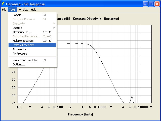

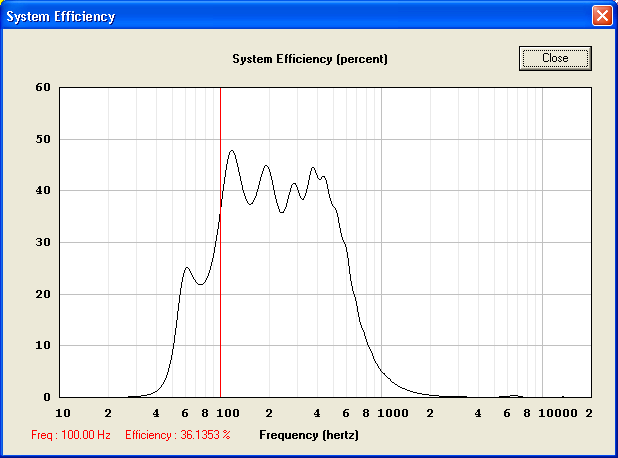

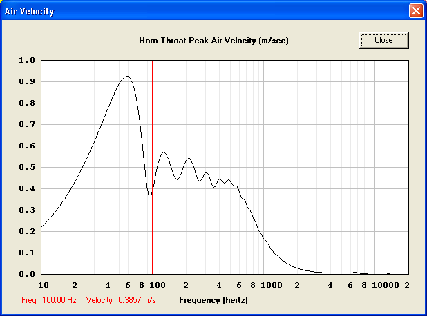

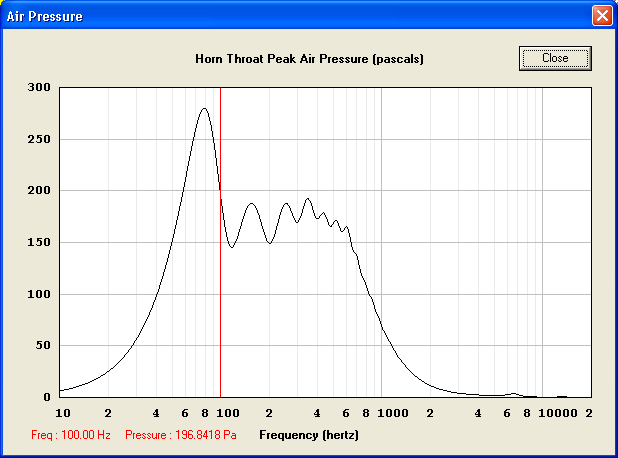

Hornresp Version 28.60
Hi Everyone,
Tools that enable system efficiency, sound pressure (previously called air pressure) and particle velocity (previously called air velocity) charts to be displayed have now been added to Hornresp. The tools are available under the SPL response window. Click on the charts to sample at a specified frequency (press the Esc key to remove sampling).
Please let me know if you find any bugs.
Kind regards,
David

I have been playing with the new version for a little while.
This is really interesting.
I have been comparing a horn path shape I have optimized versus the same horn done through best calculation methods. As in Hornresp spits out an ideal horn.
The differences are very informative.
And I have a couple of ideas of where the greatest difference can be made in the horns usable pressure bandwidth.
Particle velocities are amazingly fast depending on the horn's area. So I think that is where I will start off simulating the differences.
