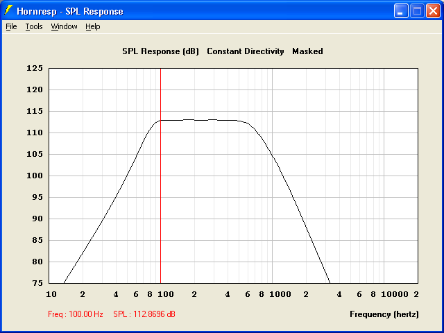

The new sampling functionality requested by littlemike has now been added to Hornresp. Simply click on any chart to sample at the selected frequency, drag the red marker line to sweep frequencies, or press the Esc key to exit.
Note that the original Sample tool has not changed. It can still be accessed by either:
1. Selecting the Tools > Sample... menu command.
2. Pressing keys Alt, T and S.
3. Pressing the F3 function key.
4. Double-clicking on the chart window area.
Product Number 2860-110805 refers.

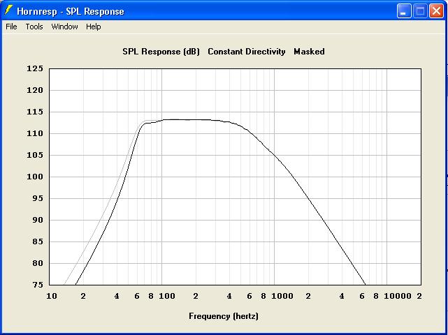

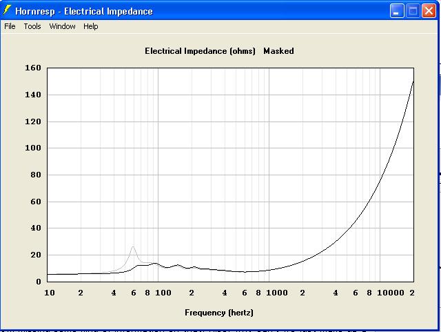

Hello, I have a question or two about reactance annulling in tractrix horns as simulated in your software. Are we supposed to adjust the rear chamber volume to flatten out the electrical impedance peak? It seems that if I use a value for Vrc that is calculated from one of the existing formulas, like Leach's, the electrical impedance curve still shows a peak, but the low frequency SPL response is really good, whereas if I change Vrc (by making it smaller), the peak goes away but the low frequency SPL response goes down a few dB. If I make the rear chamber larger than the calculated value, above a certain value of Vrc, the low frequency response (-3dB point) is not affected any more but the long cut off curve changes slope. It seems to me that the calculated value for Vrc is about right for the -3dB point, but the electrical impedance peak remains. Why do we worry about the electrical impedance peak in horn loudspeakers anyway? I'm missing some kind of information on that. Also, why can't we just make up a passive RLC notch filter to cancel out the electrical impedance peak?
I've attached two images that show the SPL and electrical impedance curves for a horn where the only difference is the size of Vrc. The dark curves are for a small Vrc and the light ones are for a large Vrc.
