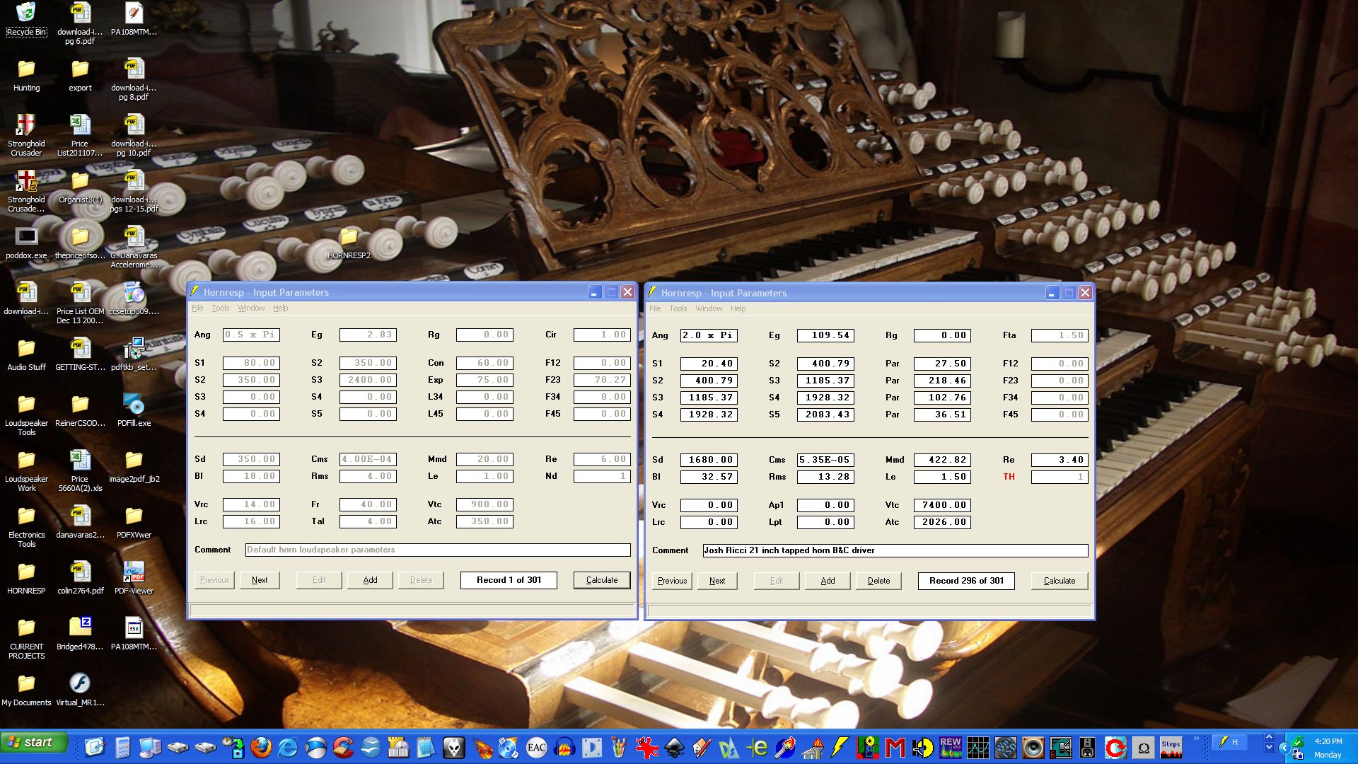

Could this be written into a little DOS routine?Make a second copy of the 3 Hornresp files in a different folder. (Hornresp.exe, Hornresp.dat, msvbm60.dll) You can then start both copies.
You will need to use import/export to keep the two copies of hornresp.dat in sync. Or you can make any changes you want to save in one copy, then exit both and copy the hornresp.dat from one to the other. Be careful and keep backups, sooner or later you will mess it up...
One thing I often do for comparing graphs in Hornresp is to use Paint, the basic image editor included in Windows.
- Produce a graph in Hornresp.
- Capture it to clipboard (Alt-PrintScreen).
- Start Paint, paste (Ctrl-C).
- Produce another graph in Hornresp.
- Turn off Draw Opaque in Paint (Image --> Draw Opaque, untick.)
- Paste (Ctrl-c)
How could that DOS program be called up by clicking on a windows icon " second Hornresp"
Nice tip by Don. If you put it into a program make shure you use "CTRL-V" for pasting (CTRL-C is for copying).
You also can do this multiple times, so you can compare a number of e.g.: curves.
