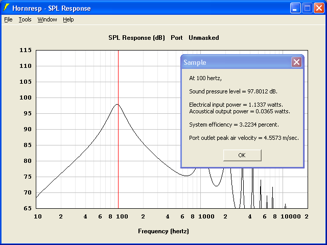

Is there a place where Hornresp list vent air velocity when simulating a ported enclosure?
Hi Mark,
Currently Hornresp does not provide details of port air velocity. I guess it would not be too difficult to add the information to the Sample tool results when the port SPL chart is displayed, if the need was considered great enough.
Note however that Hornresp port air velocities would in most cases be higher than WinISD values because losses are not taken into account in Hornresp, as Bjørn has mentioned.
Kind regards,
David

Hi Mark,
Air velocity details will be included in the SPL response chart Sample tool in the next release of Hornresp, due in the next few days.
Kind regards,
David

Hornresp Update
Hi Everyone,
Air velocity is now included in the SPL response chart sample results. Product Number 2850-110727 refers.
Please note that for a valid comparison with WinISD port air velocity results, Hornresp should be set to the unmasked resonances option and the WinISD enclosure leakage loss value Ql must be made very large - typically around 999999.
My thanks to Mark for raising the issue of air velocity.
Kind regards,
David

I'm thinking that this will end up being a very powerful piece of Hornresp.
Hi Mark,
Could you please let me know in due course if you do find the information to be useful, and if so, how it influences your horn design considerations. Many thanks.
Kind regards,
David
