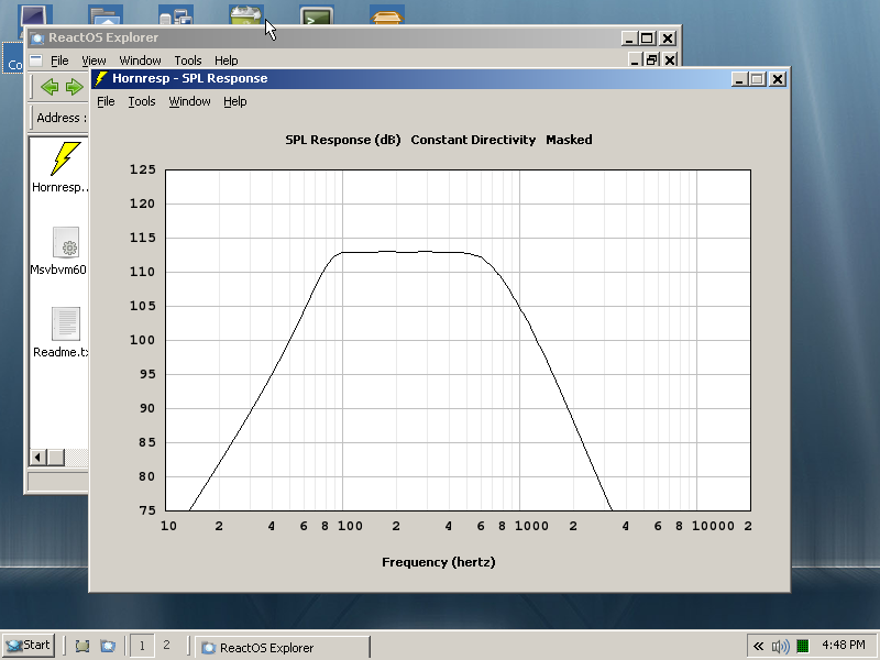

try using one of the virtualization methods like vmware fusion on a mac to run windows. This will work for sure but requires at least a windows lizense...
Wine seems to be somewhat ported to the mac from linus, so there myght be a possibility, too, I didn´t try it out though.
One last alternative I tried a few weeks ago is reactos, wait a second, I try again...
Oh, recent reactos running under vmware seems to work with recent hornresp, at least I could simulate the default project... Interesting. This sure is something worth investigatin further - I am surprised, it didn´t work last time...
If you like, I will compile something in order to bundle a package "hornresp on any PC without any windows-license....".

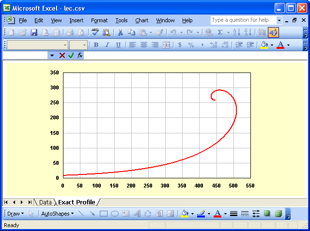

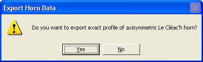

Hi Everyone,
Hornresp Version 28.50 has just been released. Changes are:
1. An option has been included to generate the "perfect axisymmetric profile" for a Le Cléac'h horn. See http://www.diyaudio.com/forums/multi-way/140190-jean-michel-lecleach-horns-114.html#post2619419 for further details.
2. Port tube end corrections are now included in exported AkAbak scripts, when appropriate.
Kind regards,
David
