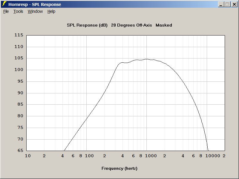

Well, I want to understand it. One problem I have is that the Vas isn't listed for this driver, so I can't use the spreadsheet I have to derive the tractrix horn shape. Also, if I put in the throat dimensions, which I assume are close to 2" square, the response in Hornresp is awful. If I reduce the throat size substantially, the response improves. I'm using:
Ang = free space
Expansion is Tractrix
S1 = 28
S2 = 368
F12 = 500
Sd = 28
BL = 8.1
Cms = .0004
Rms = .01
Mmd = 2.78
Re = 4.6
Le = .07
Vre = .01
Lrc = .1
Fr = 1
Tal = .1
Vtc, Atc = 0
The response doesn't look anything like what you showed. Thanks for your help!

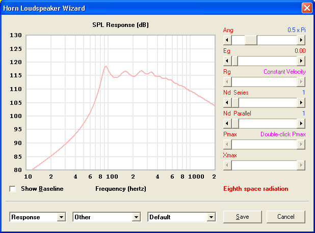

Hi, idont know where to post this
it is for david, ive found a bug, get this error simulating a rear vented horn, at the wizard, selecting the Ang to 0 PI in the slider...
my HR ver 28.40 prod # 2840-110505
thanks for such a great tool!!

Hi polakenfold,
Many thanks for the feedback - you have posted it in exactly the right place 🙂. Amazingly by sheer coincidence this very same bug was reported to me via e-mail on 2 June 2011 by another user. The fault was fixed in Product Number 2840-110603 released on 3 June. All you need to do to overcome the problem is to download a new copy of Hornresp 🙂.
The latest version is Product Number 2840-110609.
Kind regards,
David
Hi Everyone,
I can’t resist tweaking things - the latest Hornresp release is 2840-110619.
When the Eg slider in the Loudspeaker Wizard is set to zero the Rg slider is now disabled and a "Constant Velocity" reminder message is displayed, as shown in the attached screenprint.
Kind regards,
David
