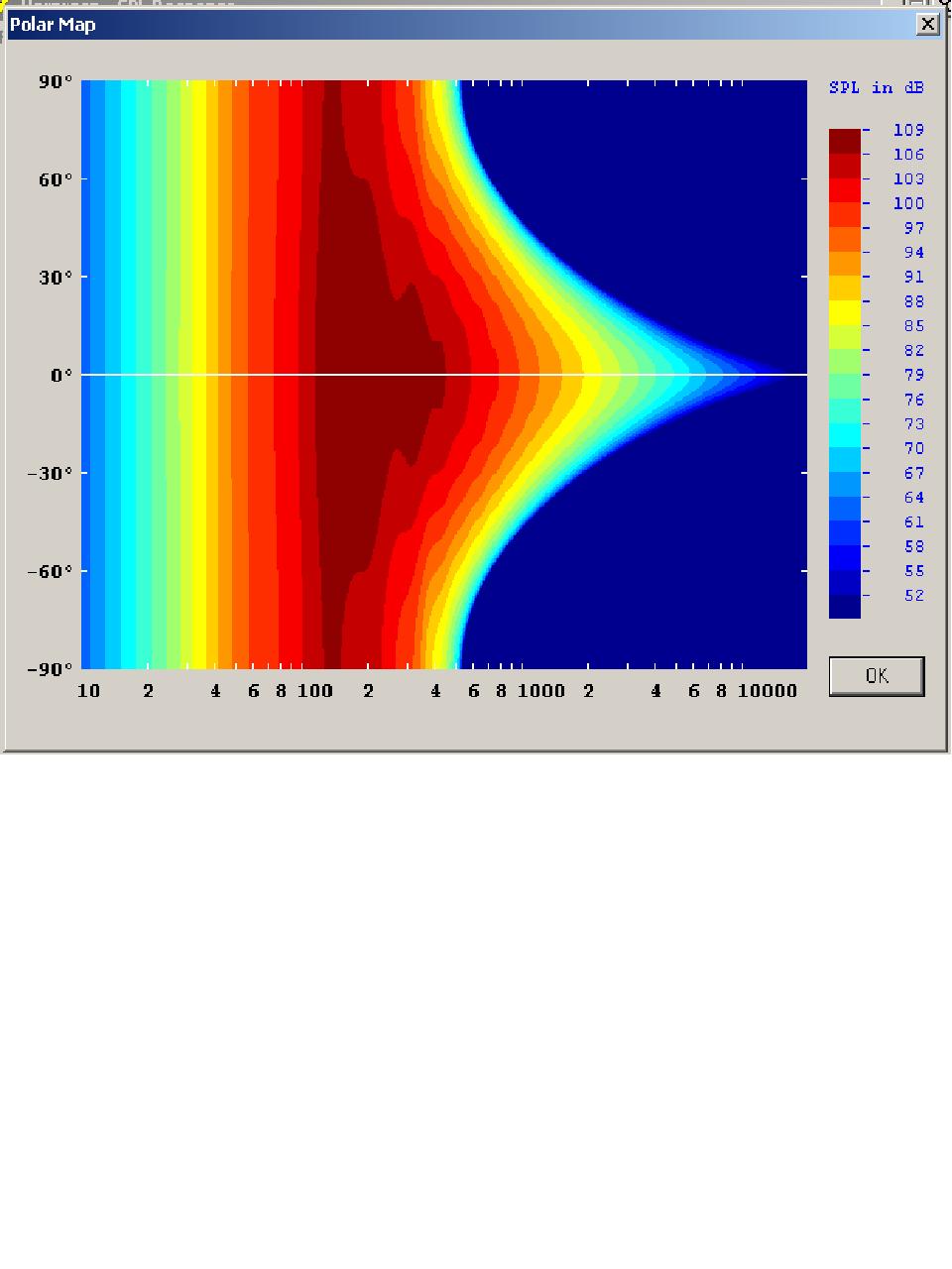

Here is the Polar Map for the short Altec horn. I never really looked at Polar Maps so I took some time this morning to figure it out. So, is this map saying that if I am on the 0 axis, the responce will be strongest from 150hz to 450hz? Then 3db down from that from 100hz to 600hz? I want to use these horns from 100hz to 500hz or so and they will be pointing right at me in my listening chair. So these look like a good fit....right?
For on axis, just look at the 0° FR plot and use it to compare to the color chart to see how to interpret it...........
If you get a newer version of hornresp, there will be an option to normalize the polar plot. That will let you look at just the pattern. It's what the pattern would be if you eq'd the response flat (which is what it should be in the frequency range that you're using the horn in). This makes it easier to match up to other speakers.
