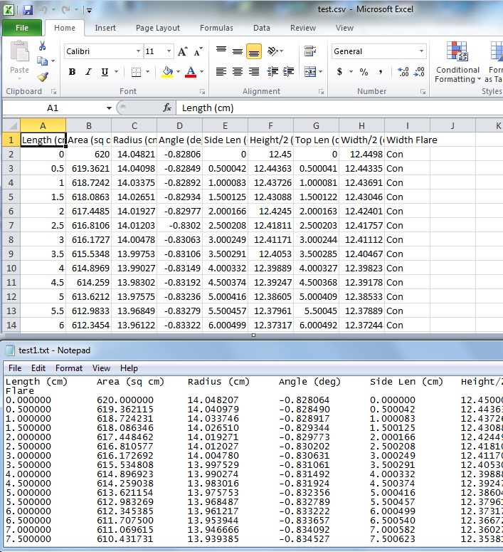

Yeah, I've got that spreadsheet as well, but my issue is I've got an enormous text file and I'm not even sure where to start. I have a basic design in my head, but I'm not sure where to go about translating this:
Code:
Length (cm) Area (sq cm) Radius (cm) Angle (deg) Side Len (cm) Height/2 (cm) Top Len (cm) Width/2 (cm) Width Flare
0.000000 620.000000 14.048207 -0.828064 0.000000 12.450000 0.000000 12.449799 Con
0.500000 619.362115 14.040979 -0.828490 0.500042 12.443634 0.500041 12.443353 Con
1.000000 618.724231 14.033746 -0.828917 1.000083 12.437262 1.000081 12.436906 Con
1.500000 618.086346 14.026510 -0.829344 1.500125 12.430883 1.500122 12.430459 Con
2.000000 617.448462 14.019271 -0.829773 2.000166 12.424498 2.000163 12.424013 Con
2.500000 616.810577 14.012027 -0.830202 2.500208 12.418105 2.500203 12.417566 Con
....*snip* this goes on for about 4 pages....
into something that looks like a TQWT. Someone in my original thread was kind enough to help me with what a basic design would look like, but I'm still a little lost.

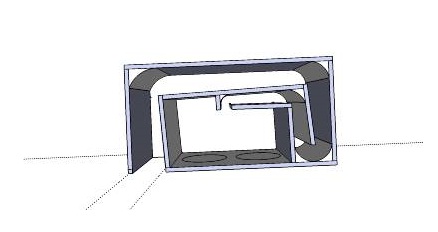

My original intention was to suggest perhaps Hornresp could benefit from having an export to something other than text, such as .3ds or .skp which would make it a lot easier to fold it up and see what I'm looking at. I guess the basic idea is I'm not comfortable enough with my hornresp skills yet to trust that I'm reading this export data properly enough to start marking wood.

Hornresp data values can optionally be exported as 'comma separated values' or *.csv files, rather than 'text' or *.txt files, if this is preferred. Comma separated values files can be opened directly in Excel. Note 15 on page 20 of the Help file may also be of interest.

I was also considering the csv export. It does make hiding columns and copying data a little easier, however I'm still confronted with a wall of text, I.E: attached image.
I do understand that these numbers can be worked with by those used to it, and I'm sure if I read note 15 a few dozen more times and quintuple check my work to make sure I haven't fat fingered a number I can eventually make it work, but as this is my first foray into using Hornresp, I'm absolutely terrified that I'm going to make a mistake.

I love the program so far, and I'm trying my absolute best to use it properly, however it just seems that exporting a 3 dimensional object into a format that can be directly utilized (Second attached image) could be easier.

I wish I had the programming expertise to make a conversion plugin for Sketchup that could handle a hornresp csv/txt.
