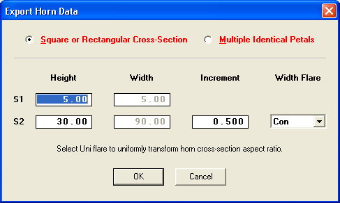

When exporting the horn data, simply set the Width Flare to 'Con'.

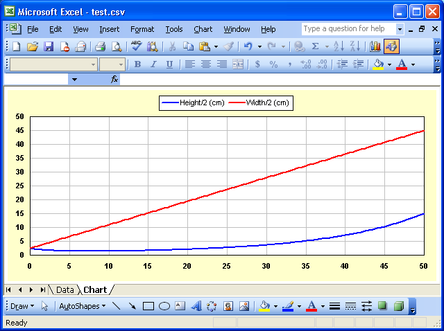

The attachments refer to an exponential horn having S1 = 25 sq cm, S2 = 2700 sq cm and L12 = 50 cm.
The flare profiles shown in attachment 2 assume S1 = 5H x 5W and S2 = 30H x 90W.
If you want curved wavefronts to expand at an exponential rate however, then that is a different story :).

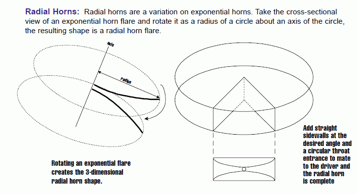

Hi David,
The question was how to get a profile that is the same from side to side in a Con horn. Is this a feature I have missed? What I get is a varying profile that is to long(stretched) at the sides.
It is not a curved wavefront I want, it is a curved(radial) hornfront making the profile the same from side to side. This also mean the area is measured radial in the horn. It is, as I understood it right, how a radialhorn is defined. It might though be acoustically wrong.

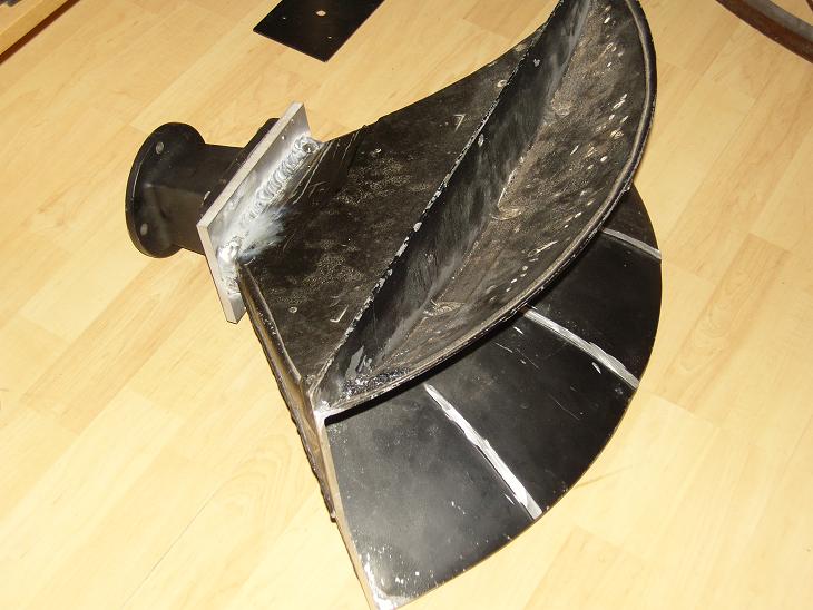

Just for fun, this an (not so typical) example that I still haven´t finished: An Altec 511 Exp rebuilt for taking a 2" driver with help of a JBL 2328 adapter.
