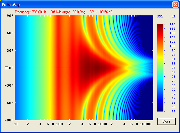

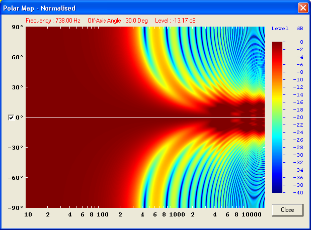

Hornresp Update
Hi Everyone,
A check box has now been added to the Hornresp polar map to enable results to be shown normalised to the on-axis response, if required.
My thanks to John Sheerin for raising the issue.

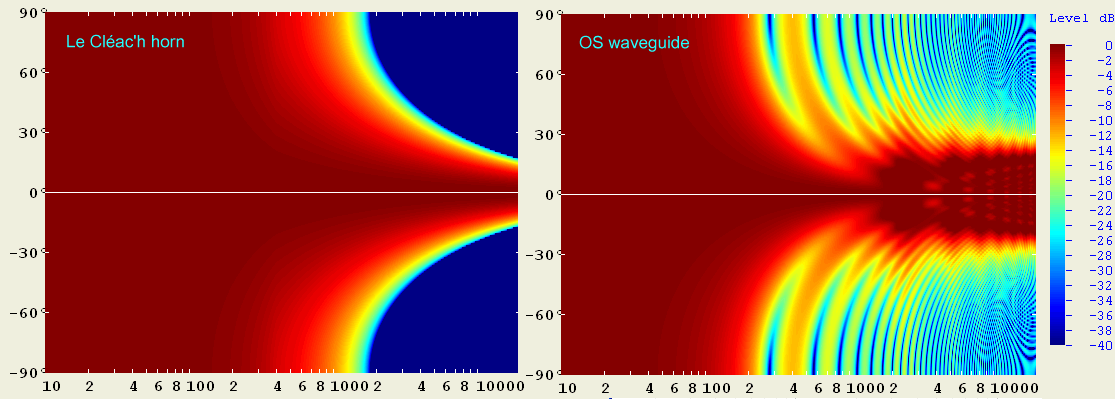

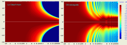

The on-axis normalization button is a great tool!
Here attached a comparison between a Le Cleac'h horn and an OS waveguide of the same dimension.
Doesn't need any coment...
Best regards from Paris, France
Jean-Michel Le Cléac'h

That's a bit misleading - you're comparing an OS horn with no round over at the mouth to your flair which does have a round over. Of course the polar map will be smoother for the LC flair in this case, but if you actually build an OS flair with a sharp corner at the mouth you are missing the point. What is obvious is that the OS even without a proper mouth termination has pretty much constant directivity within its usable bandwith while the LC flair has continuously increasing directivity.

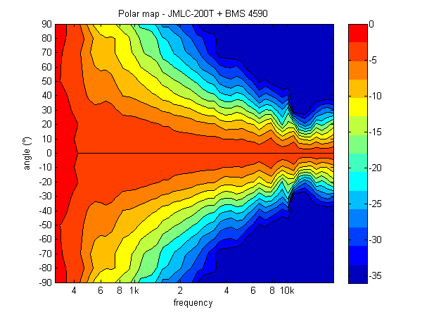

Hello John,
I agree that's a little bit misleading so the comparison between Hornresp results and real mesurements should be more interesting:
Real measurements for a Le Cléac'h horn:
http://www.horns.pl/images/horns/jmlc200t.jpg
polar: http://www.diyaudio.com/forums/atta...376-waveguides-horns-jmlc-200t_dir_matlab.png
real measurement for an OS waveguide having the recommanded round over at the mouth
http://www.diysoundgroup.com/images/large/OSWG_12.jpg
polar: http://www.diysoundgroup.com/images/large/OSWG_Sono.jpg
No comment again...
