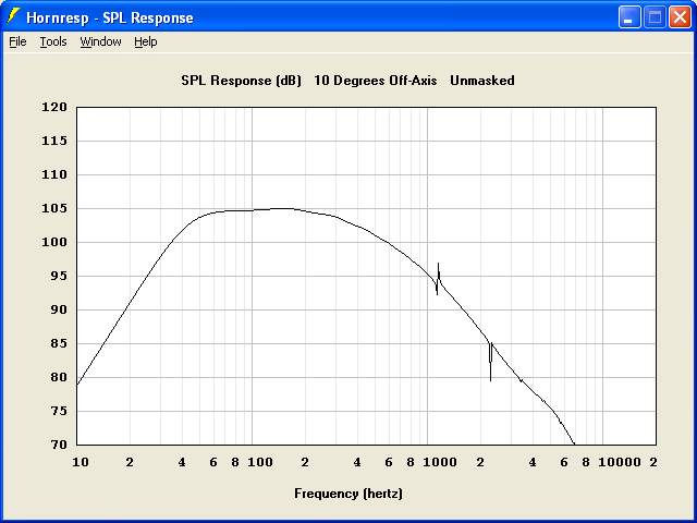

Doesn't look that impressive to me. I've gotten better results with an 8" in a smaller cab. It really only goes down to 40 hz at decent volume and doesn't get that loud period.
If your design is so impressive why don´t you show it. Notice this one is not for a "Liliput" system.
The drawback with this large box and cheap driver is max SPL of 120dB at 40Hz. Good enough! The Altec-414-8A I also have will unfortumately be more limited.
Some input from David would be appreciated.
I didn't mean to sound like I was bragging I just meant that nothing about it looks to good to be true. It looks like a decent design. I don't share my designs on this site anymore because ignorant naysayers insist apon tearing them apart with ridiculous misinformation and I'm sick of being pissed off. If however someone wants me to help them with a design or design something for them I am always happy to do that. Give it a couple hours, David always responds pretty promplty to my questions.
If true it could be something. Take a look if you have the time, and say what you think.
Hi Lars,
The Hornresp simulated SPL response looks nice and smooth, I agree. The only way to know for sure though, would be to build a prototype and measure the actual performance.
I have no practical experience with Le Cléac'h horns so I am not particularly well qualified to comment 🙂. Jean-Michel would be in a better position to know whether or not such performance could reasonably be expected to be achieved from such a system.
Kind regards,
David

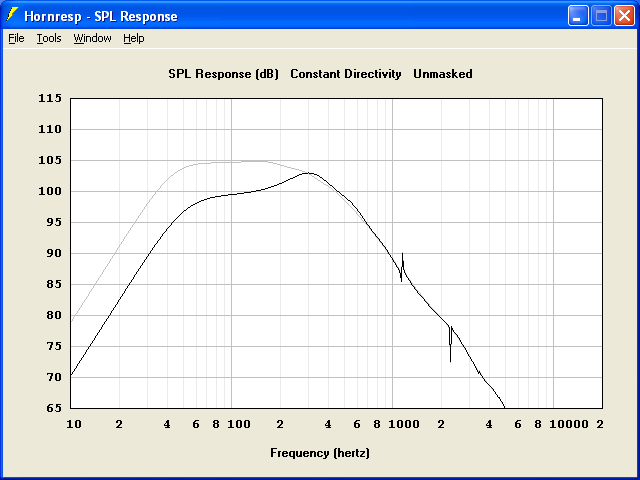

Unfortunately the magic disappears when going from 180 to 90 degrees Le'Cleach horn. Grey=180, Black=90.
