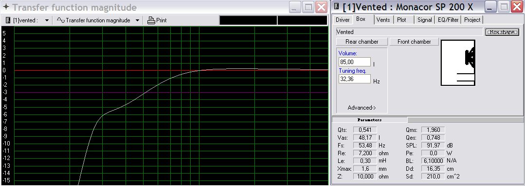

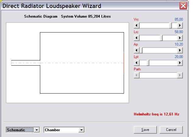

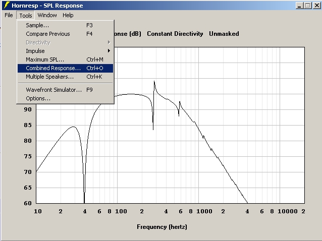

I guess that what you are missing is that hornresp initially shows the output from the driver, without the output from the port.Hi Everyone,

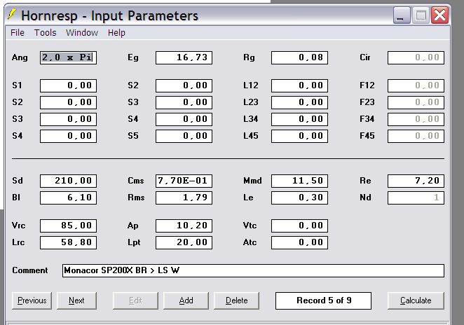

I'm beginning with Hornresp, trying different things.
When simulating a Bass Reflex and comparing the result with WinISD's (to be sure I'm doing ok), I don't get the same response... Could you tell me why ?
I model the same box with the same vent and get two different Helmoltz freq and two different response curves...
In HR, I did it with the Loudspeaker Wizard (wonderful feature by the way !!)
Perhaps all of this is already explain in this tread, but there's # 2000 messages ! If so tell me where !
Regards.

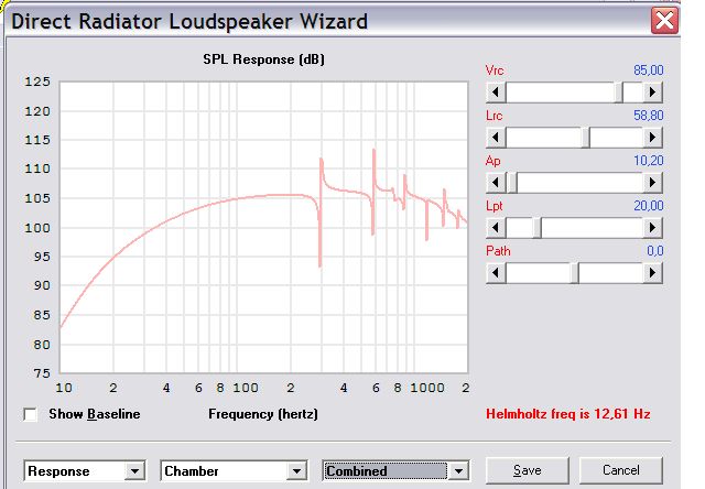

To see the overall system response you need to select the combined response from the tools menu in the SPL window.😉

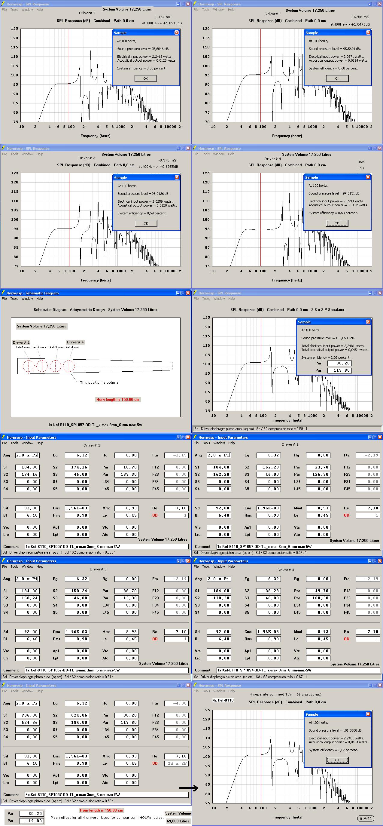

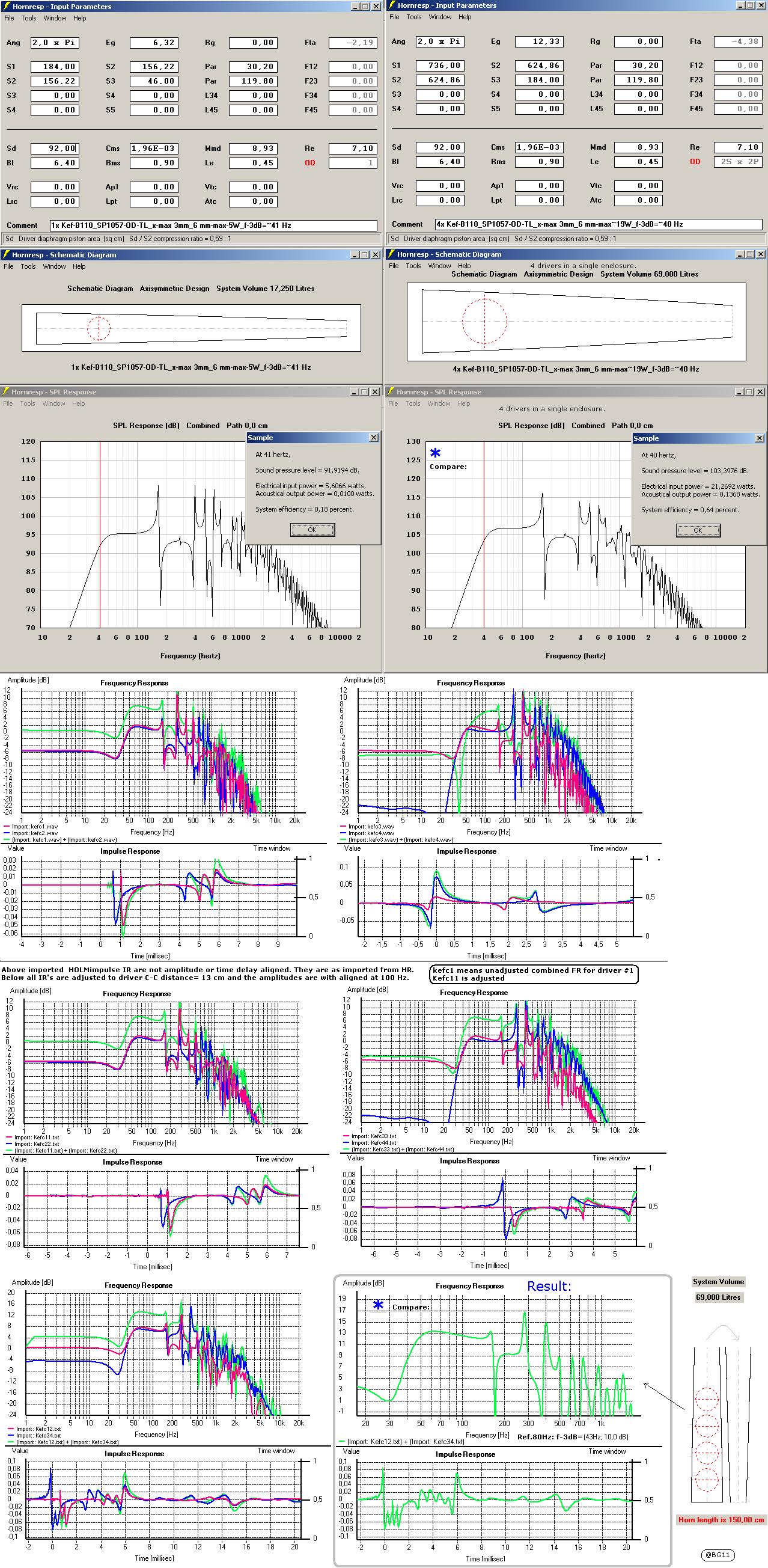

What I am looking at is a quarter wave pipe (TL) with several identical drivers distributed along a portion of the pipe, not for smoothing necessarily but for convenience sake. I realize that HR can not simulate this directly (nor would it be reasonable to rewrite it to handle it) but what I am wondering is if one could not get a close enough approximation of the total response by simulating each position and averaging the results.
You've stuck an idea in my head:
What if Hornresp could crunch the numbers of multiple records? That is to say that if you created a file for each position along the path where a driver is located. It would also be interesting if you could use another mode of the multiple record technique for comparison. I think it would a need a check box to indicate if you wanted to sum or compare them and a row of buttons to load files that would allow you to also pick a color for the graph output...
...You've stuck an idea in my head:
What if Hornresp could crunch the numbers of multiple records? ...
Why not DIY. 😀..There are endless use if taking advantage of HR's export files.
Here is an example:
b🙂

Why not DIY. 😀
That's quite the undertaking, but I do wonder if hornresp could do a better job than HOLM? I was thinkning of this as a logical alternative to giving Hornresp a workover to make it aware of multiple driver locations in one record.
Hi Xoc1,
I'm taking about the combined response. It doesn't look like the WinISD's.
For the close box, it's close but not the same, for the BR it's sometimes far away, specially for the low part.
Regards.
I'm taking about the combined response. It doesn't look like the WinISD's. For the close box, it's close but not the same, for the BR it's sometimes far away, specially for the low part.

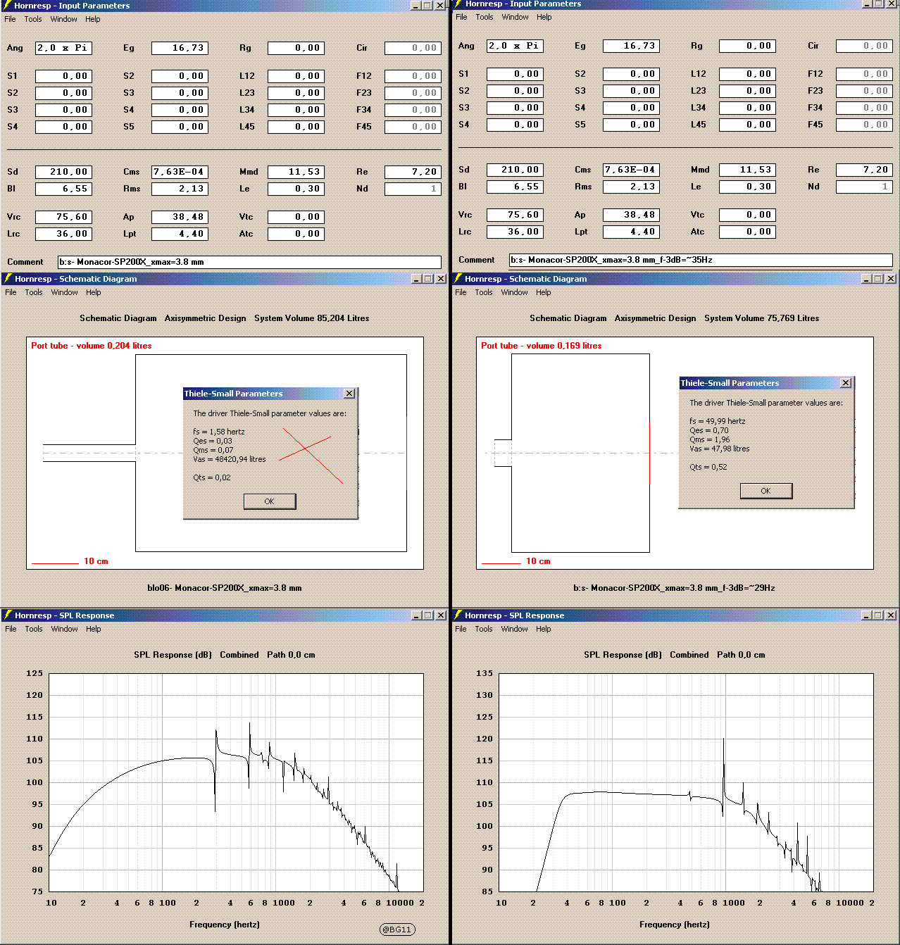

Hi blo06,
Can you please post a screenprint of your Hornresp input parameters window, and also provide details of the WinISD Driver, Box and Vent values you are using for the purposes of the comparison. Thanks.
Kind regards,
David
Hi blo06,
Kind regards,
David

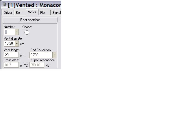

Hi David,
here they are.
Regards.
blo06
Your AP figure is incorrect.
The AP Parameter is the cross sectional area of the port.
For a 10.2cm diameter round port this would be radius squared X pi = 81.71 sq cm.🙂

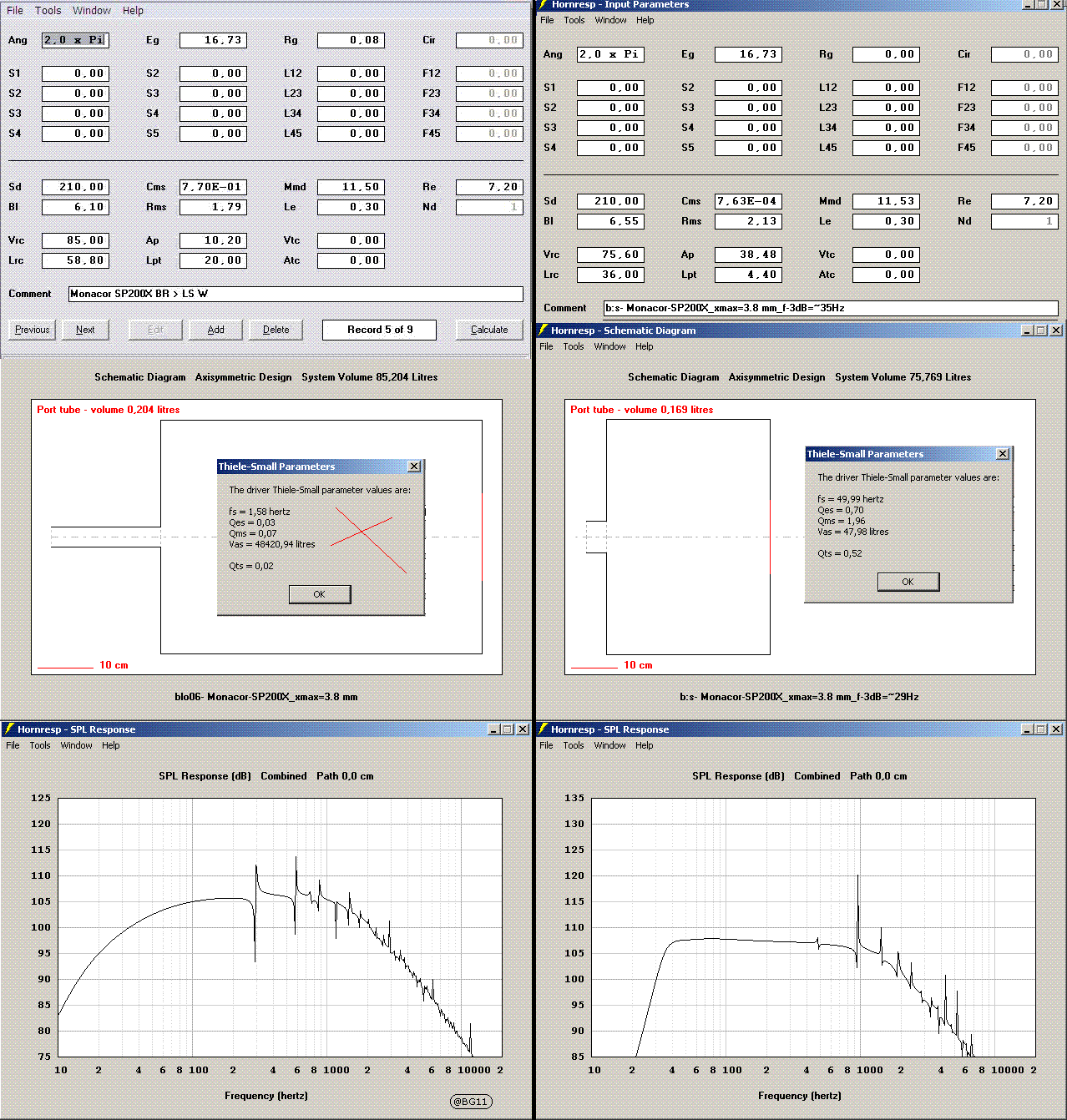

I saw that too but more important is that the T/S parameters are way off.
Reason for this is probably from the advertised Cms value that is not consistent compared to other driver data.
b🙂
b🙂

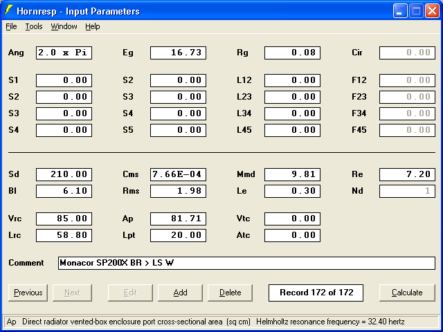

Hi blo06,
Thanks for the additional information. The following changes are required to the Hornresp input parameter values to make them equivalent to the given WinISD values.
Cms - From 7,70E-01 to 7,66E-04
Rms - From 1,79 to 1,98
Mmd - From 11,50 to 9,81
Ap - From 10,20 to 81,71
With these changes the Hornresp Helmholtz resonance frequency becomes 32,40 hertz compared to the WinISD value of 32,36 hertz.
Kind regards,
David

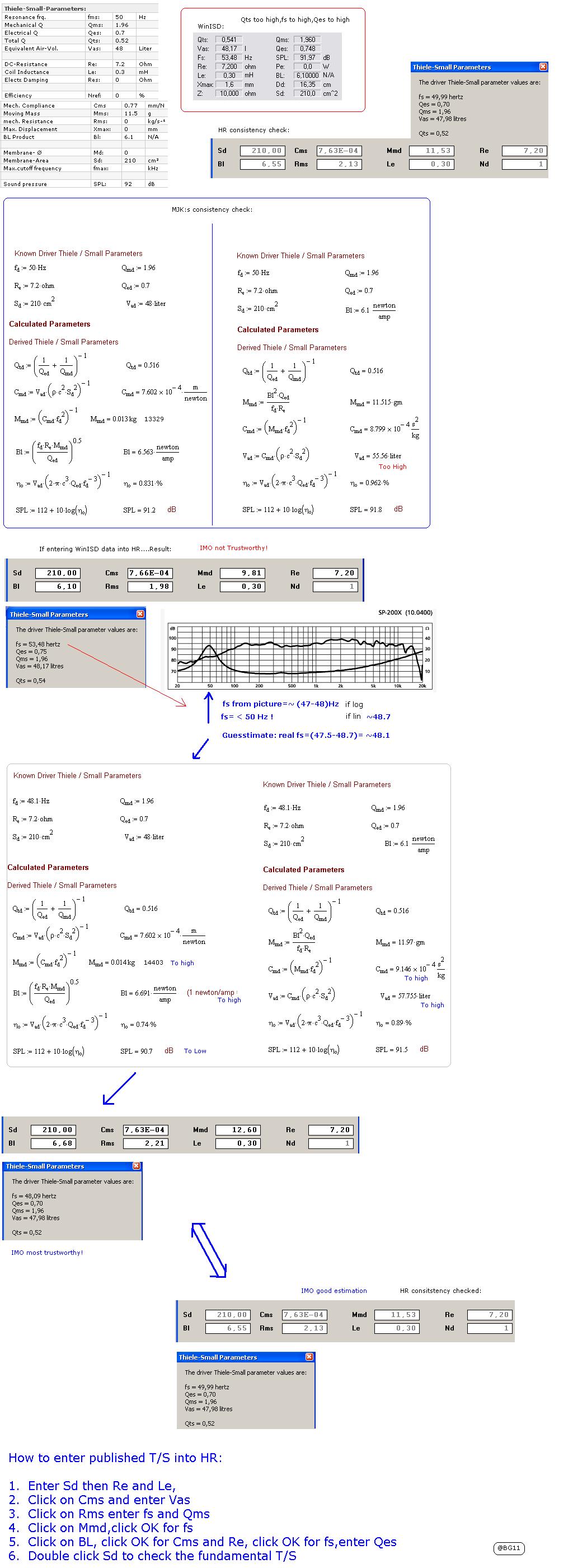

..The following changes are required to the Hornresp input parameter values to make them equivalent to the given WinISD values.
Hi,FYI
No doubt that HR is a good and reliable predictor of ported boxes and IMO surpasses WinISD too but I think the provided T/S is off. See the picture:
b🙂

and of course the SPL response looks a bit different than with your numbers... How did you get them ?
Hi blo06,
Using the WinISD driver parameter values you provided I simply generated the unknown electro-mechanical values from the equivalent Thiele-Small parameters using the Hornresp 'Calculate Parameter' tool.
I used the following given values:
Sd = 210,00
Bl = 6,10
Le = 0,30
Re = 7,20
And calculated:
Cms from Sd and Vas.
Mmd from Sd, Cms and fs.
Rms from Cms, fs and Qms.
Kind regards,
David
