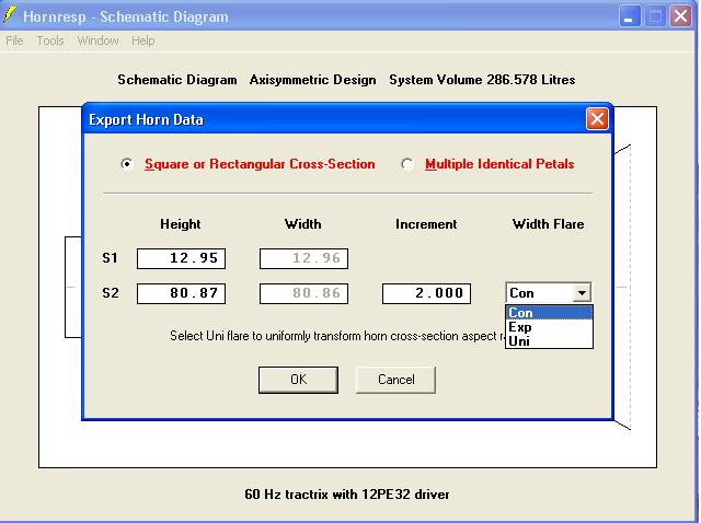

Width Flare is the type of horn Con Trac Hyp or Uni. Uni is a horn where you set up Hornresp to make a horn having two parallel side walls and the rest changes. In other words you are specifiying the horns width.
Mine only has Con Exp or Uni, there is no Trac option in that box. I have version 28.40 of the program.

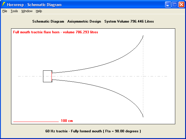

Hi dirkwright,
Because with your design, the mouth is severely truncated, as indicated earlier 🙂.
Using your values of S1 = 167.80 sq cm and F12 = 60.04 Hz, a fully formed tractrix horn would have a length L12 of 202.31 cm and a mouth area S2 of 26123.15 sq cm. See the attached screenprint.

Why doesn't the schematic show the horn ending in a 90 degree flare?
Hi Mark,
Just to clarify - the 'Uni' width flare option uniformly transforms the horn rectangular cross-section area aspect ratio from the throat to the mouth. The horn will have two parallel side walls only if the S1 and S2 height values are specified to be the same.

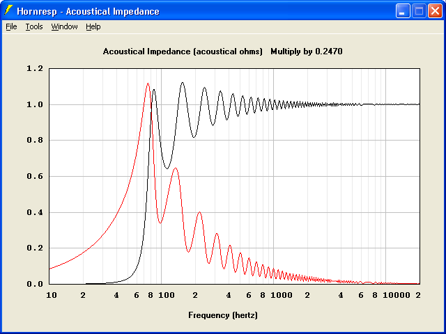

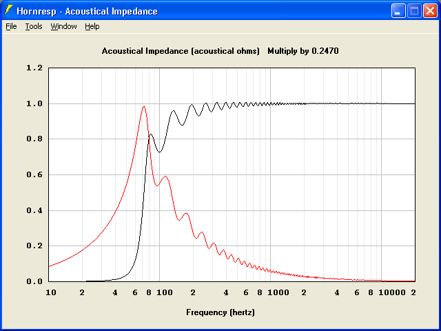

Hi dirkwright,
The throat acoustical impedance of a fully formed tractrix horn will be "smoother" than that of a truncated one because of the better matching conditions at the horn mouth - there is less of a discontinuity as the wavefronts leave the horn.
The first screenprint shows the predicted normalised throat impedance of your design (radiating into 1 Pi space). The second screenprint shows the predicted normalised throat impedance of a full-mouth 90 degree tractrix horn having the same S1 and F12 values as your design (radiating into 1 Pi space).
