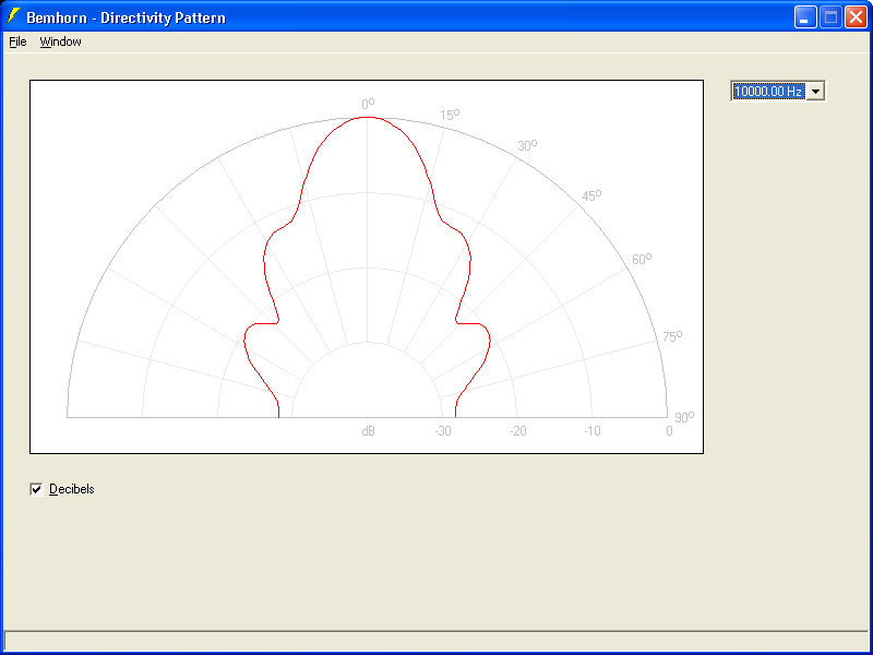

Select the Tools > Directivity > Response... menu command to show the pressure response.
Note that the tool only applies to finite single-segment non-negative flare horns.

I kwow the single segment trick, but is there a reason that it is impossible to use with multiple segments or reflex design ? Too complicate to be programmed? thank.
Hi julienb34,
To accurately simulate the directivity of a multiple segment horn or the combined response of a bass reflex loudspeaker would require a completely different model to that currently used in Hornresp. Boundary Element Method (BEM) techniques could be used, but the downside would be the very long calculation times. For that reason, I have no plans to change the Hornresp directivity model - even though I have done some experiments calculating directivity using BEM techniques (see attached example).

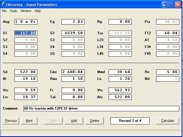

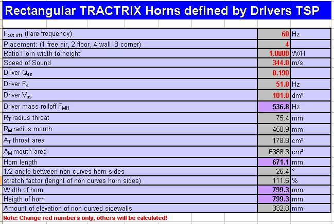

Does anyone know why Hornresp gives different results than this spreadsheet:
Download Section
for tractrix horns? I was inspired by the spreadsheet because a 60Hz horn was so nice and short, but Hornresp made it much bigger. One shows a length of 67.1cm and the other shows a length of 161cm! The expansion curve of the spreadsheet has the 90 degree flare at the mouth whereas the generated by Hornresp does not.
I don't know which one is correct. A lot of people use the spreadsheet, from what I have seen. I gave up and anticipate building a 100 Hz hyp-ex instead. It's 105cm long.

You must run placement 1 in the German spreadsheet to get realistic figures.
Is that because he made a mistake in the spreadsheet? The mouth areas are the same, the throat areas are close, but only the length is different. I used the system designer tool in Hornresp to build the horn there.
Even if I set it "1", I get a horn length of 1.96 meters, which is different than Hornresp.
Hi dirkwright,
Have a look at the formula in the spreadsheet used to calculate Rm (mouth radius). The velocity of sound value used here is 340 m/sec. Change this to 344 m/sec and you will now get effectively the same results as those calculated by Hornresp - allowing for the very slight differences in mouth area and length due to rounding.
Spreadsheet:
Fc = 60 Hz
Placement = 1
At = 178.8 sq cm
Am = 26158.0 sq cm
Length = 199.63 cm
Hornresp:
S1 = 178.80 sq cm
S2 = 26157.99 sq cm
L12 = 199.62 cm
F12 = 60 hertz
Kind regards,
David
