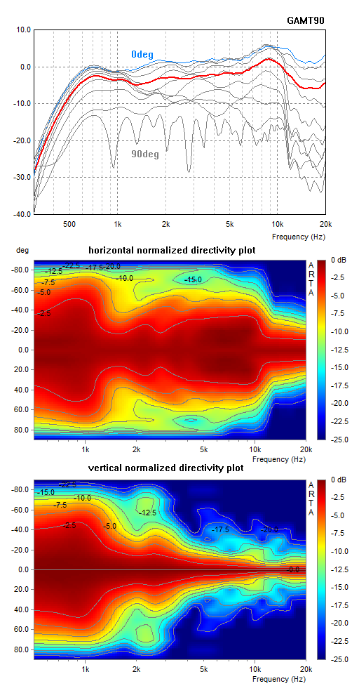

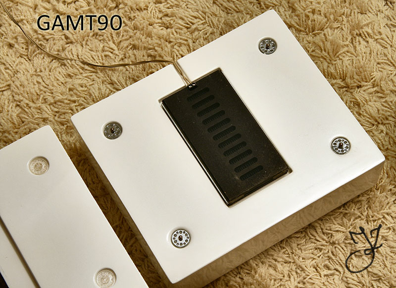

Promised measurements.

do you have a better photo of the driver w/ horn , it seems like it shows only one half ???
Take a look at post #72 😉
My question is that this does not look to be an AMT1 driver but more like a Beyma AMT TPL150??
Hi Jack,
Thanks for sharing the measurements with the horn loaded AMT. Relative to the graph posted by the manufactor of the AMT you are using, the horn loading seem to make the driver usefull quite a bit further down in freqency (e.g. falling of around 650 Hz vs. 1000 Hz without the waveguide).
How does it sound in the 700-1000 Hz range?
Thanks!
Best regards
Peter

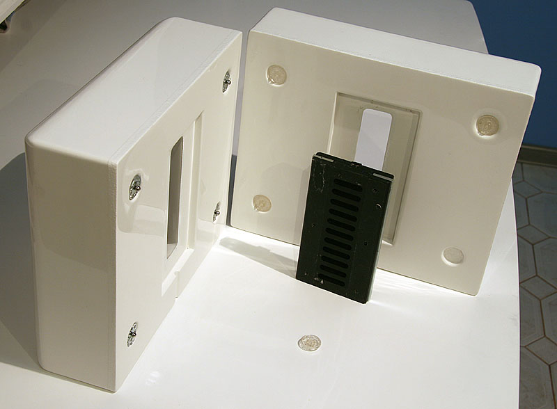

Hawthorne audio has a new AMT w/ horn in development:
seems to be only a front horn playing down to 500hz !!!
i am not sure if the back is open ?
more info here:
Hawthorne Audio • View topic - SI10/BG ribbon full dipole 2-way speaker project/pics
Hi hum4good,
Wow, they look truly great! Having the Beyma TPL-150H, I have been wanting something similar for some time now. Thanks a lot for sharing!
Best regards
Peter
Is there a price yet for these new Hawthorne Audio AMT drivers w/ horn? According to Hawthorne Audio's website the horns are made from man-made marble and won't be cheap! In fact Darrell Hawthorne himself hinted at the expected expense when he said "At 53 I need to keep one eye focused on my own personal retirement. I hope to keep doing this for a long time but one must be realistic and prudent. So, perhaps out of the price range for many but not without benefits for many."
Please don't misunderstand me I'm not suggesting that what Darrell is doing is wrong. Even vintage large, dipole, Heil drivers --{of which I have 3 pairs and I'm looking for a 4th}--- sell for over $300pr and the new large, dipole, Heil drivers are selling for $700pr! I'm just saying don't be surprised by a price that's higher than many want to pay for a pair of drivers. That said, "if" they are a sonic improvement over the original, vintage Heils and really go down to 500Hz ---{Heil claimed their large Heils went down to 800Hz, but Dr Von Schweikert, who worked directly with Dr Heil, informed me in an email that the large Heils MUST be crossed over at 1.2KHz @ a 24dB slope or else it goes into distortion}--- they'll be worth some serious bucks indeed!
