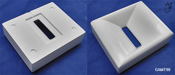

I've been talking about prototypes today with Autotech. I think before Christmas first prototypes should be available. We are waiting for some parts needed - this is a modular system.

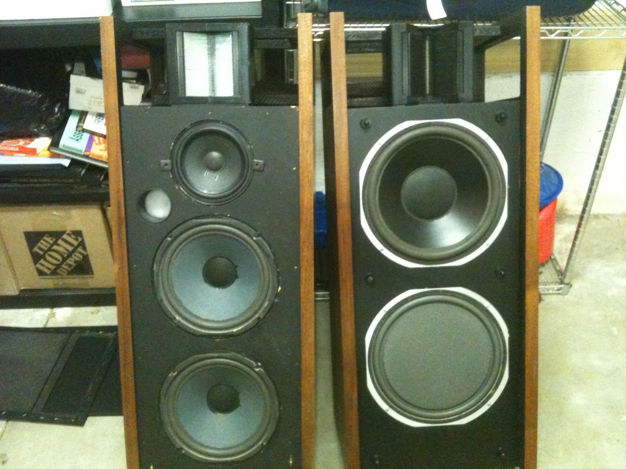

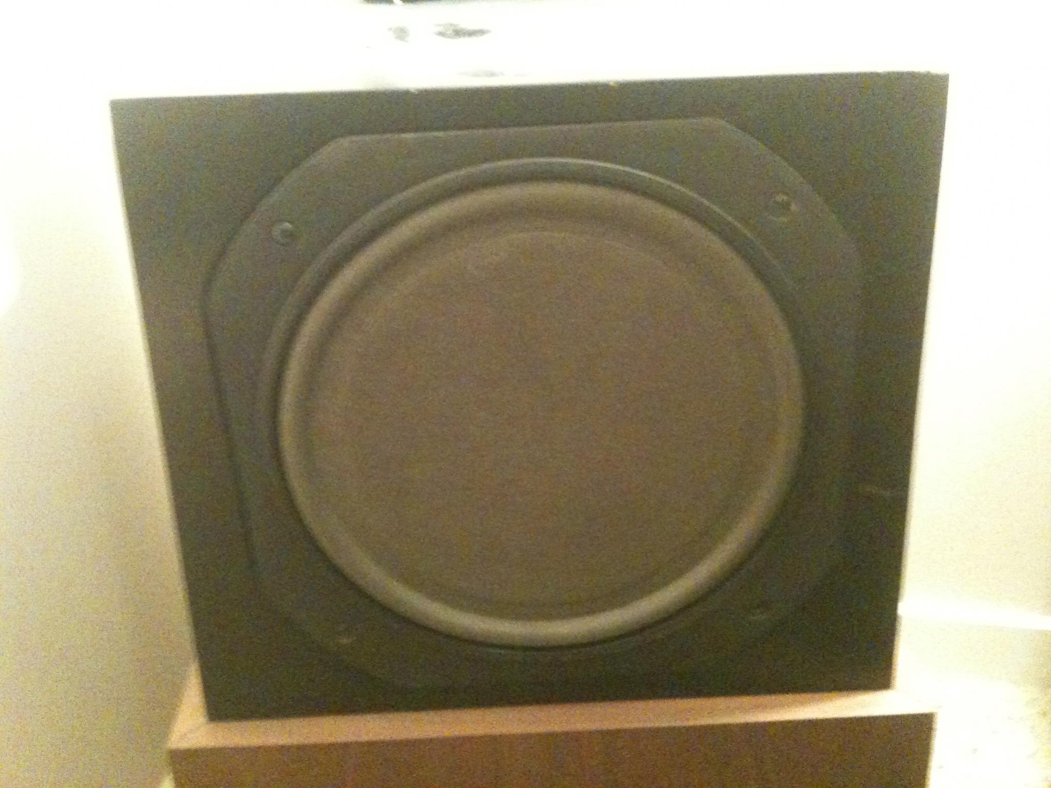

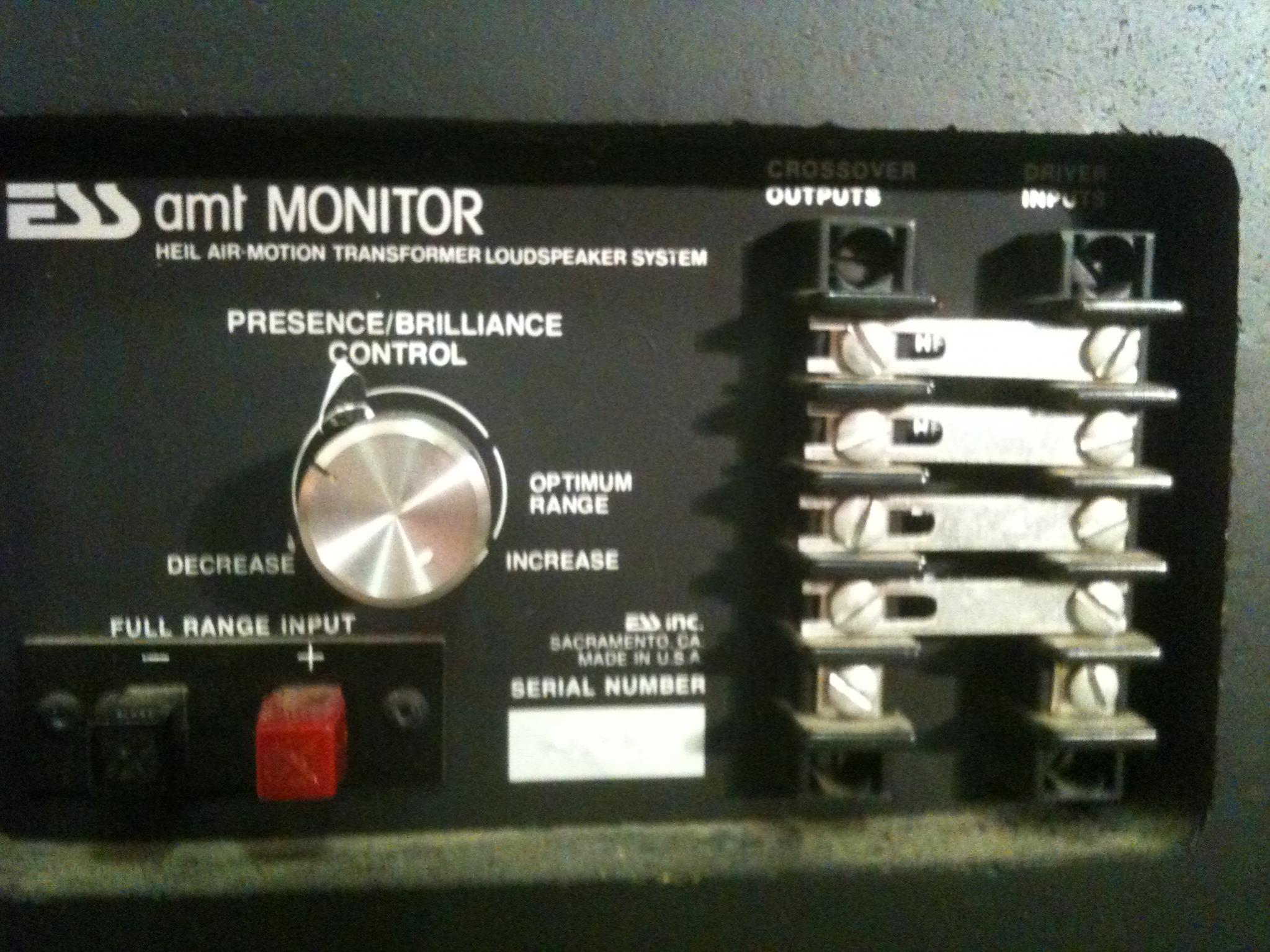

Thank you for the thorough reply!!!! I posted questions here many moons ago when I first started to "rebuild" speakers….. my first project was just refoaming the surrounds on the AMT3 rock monitors…… the refoaming led to replacing the original capacitors and the resistors to the best of my ability because I noticed that the insides had already ben changed in one of the cabinets…… I learned about soldering and wire gauge and the beautiful frustration of this hobby…such as having to do everything inside the cabinet because the crossover won't come out without being destroyed…..and I learned that I must know some yoga because i was able to contort into some wonderful positions while doing this!
After all of that…… When I compared the speakers that I was so damn proud of building to my purchased ones (Dali Euphonia MS5) I was disappointed….
The high end was actually better for the ESS, but there was a missing midrange punch….. and the low end is not tight or low enough…….
But, there is something about the high end… something magical so clear and true to life….but the rest of the speaker just falls so far short….
I thought that making it better would just be to simply replace the woofers with new ones, but it is so much more complicated than that…… So i have been reading and reading and trying to learn… but with a 18 month old boy and a 8 week old daughter the "projects" and hobby is quickly disappearing…. but my desire has not……

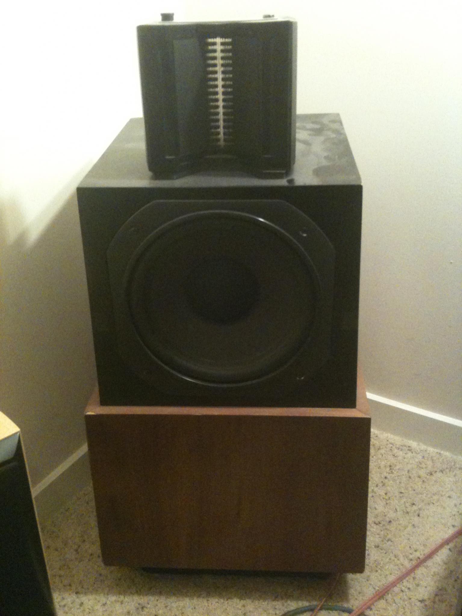

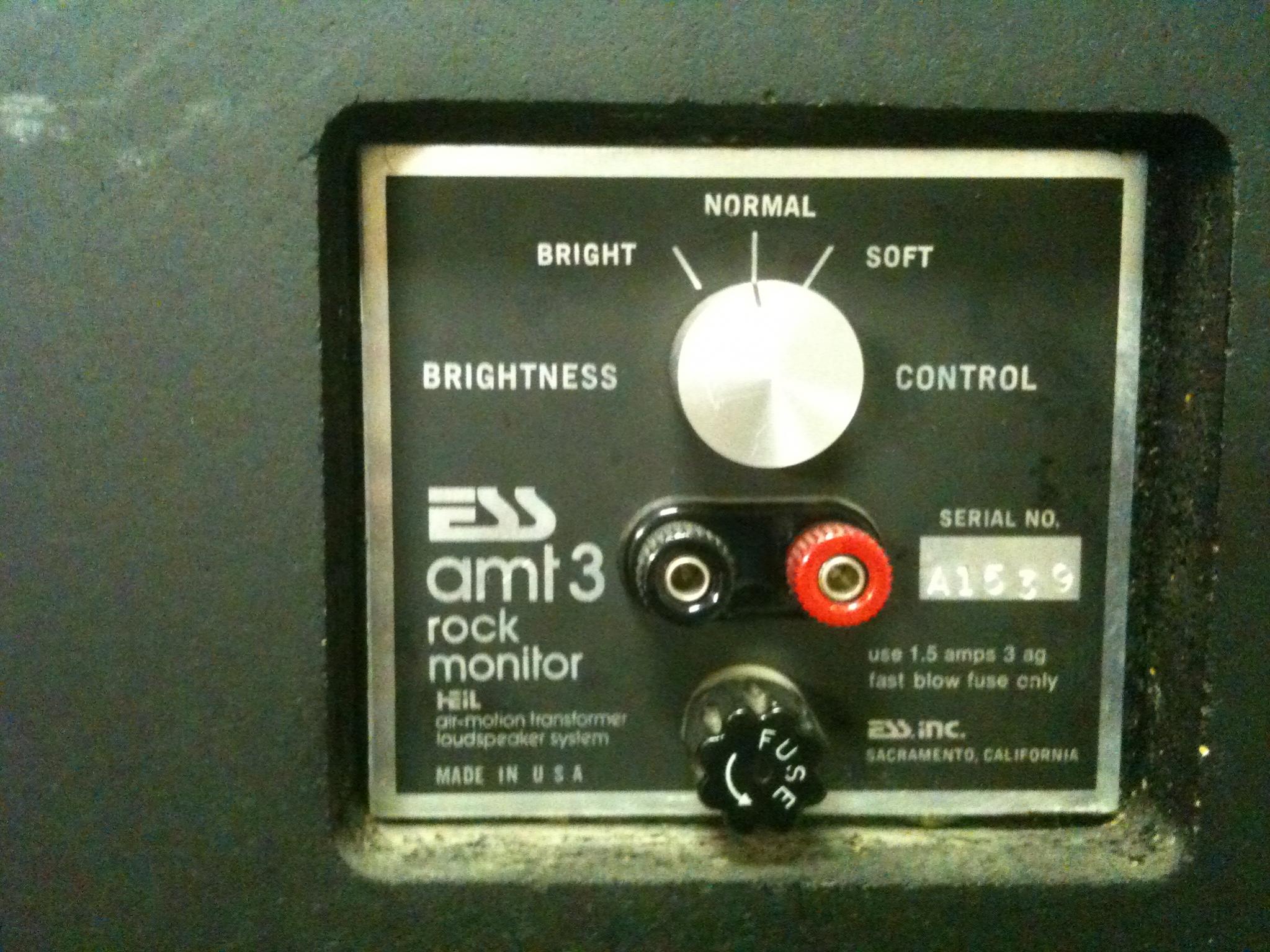

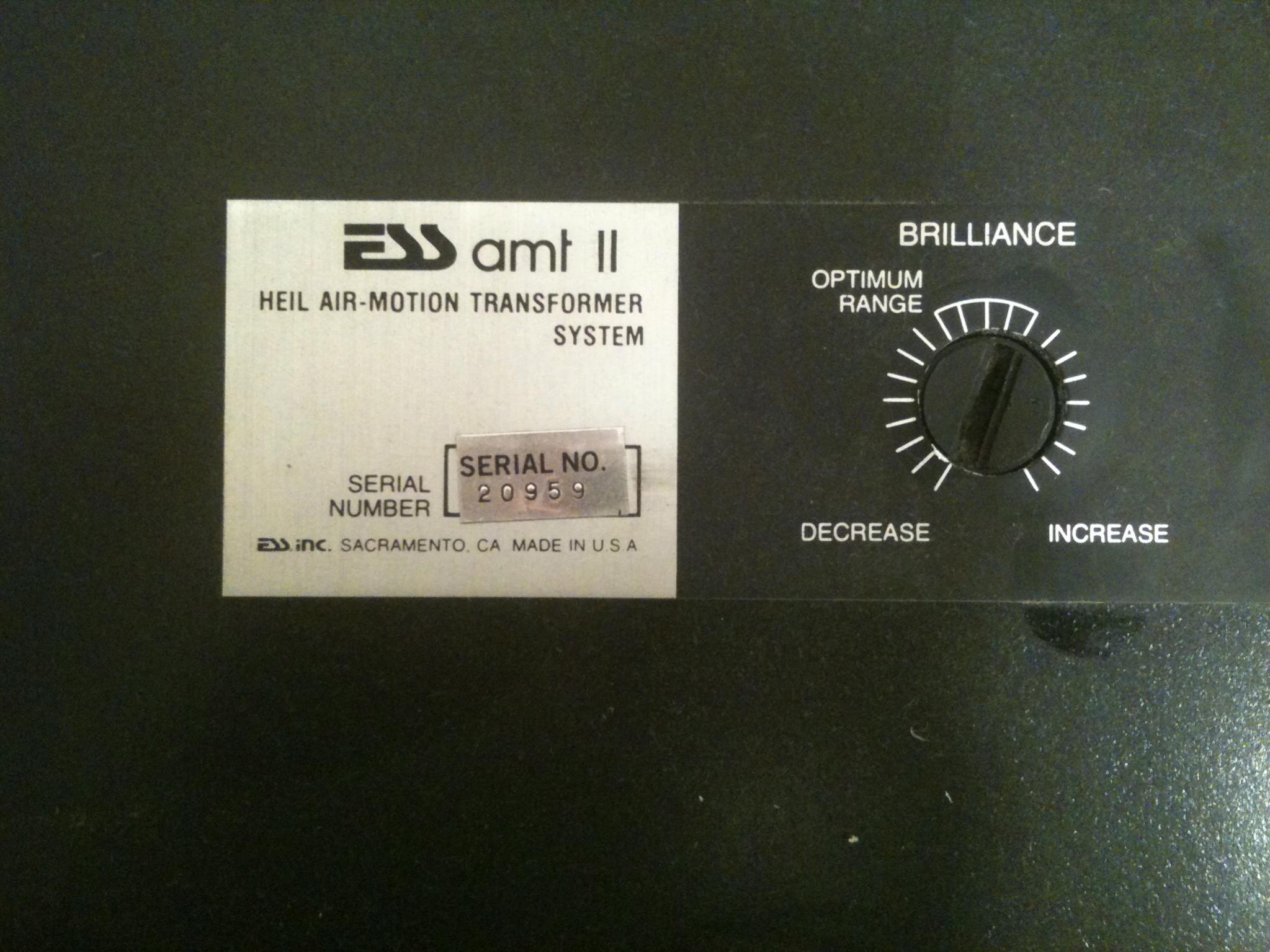

I have the AMT Monitor and the AMT3 Rock Monitor, I also have the AMT II and a newly purchased AMT Tower…… So I obviously love the sound…. I just want to know how to make it better….
My quest started when I was looking for my first speakers after making some money… I went around and around Los Angeles listening and trying to learn what I liked…. I found a lot of very pompous people… and some very humble people (who I tended to go back to)… I first learned about the Heil driver from this man What?s New | Paul Squillo Music Systems
and I was smitten, but I did not buy his speakers because I knew nothing about speakers and now am stuck with a brand that has no name recognition in the US. Rather than eat the whole thing I listen happily to them because they are pleasing and better than the ESS speakers in terms of mids and bass… but I still wonder if I can make the ESS speakers sound better….and or equivalent to my professionally made speakers….. here are some pics of the speakers…..
LOL
AMT speaker blend well with OB speakers - but - you will *also* have to learn about XO design - having mastered yoga, no problem for you ...

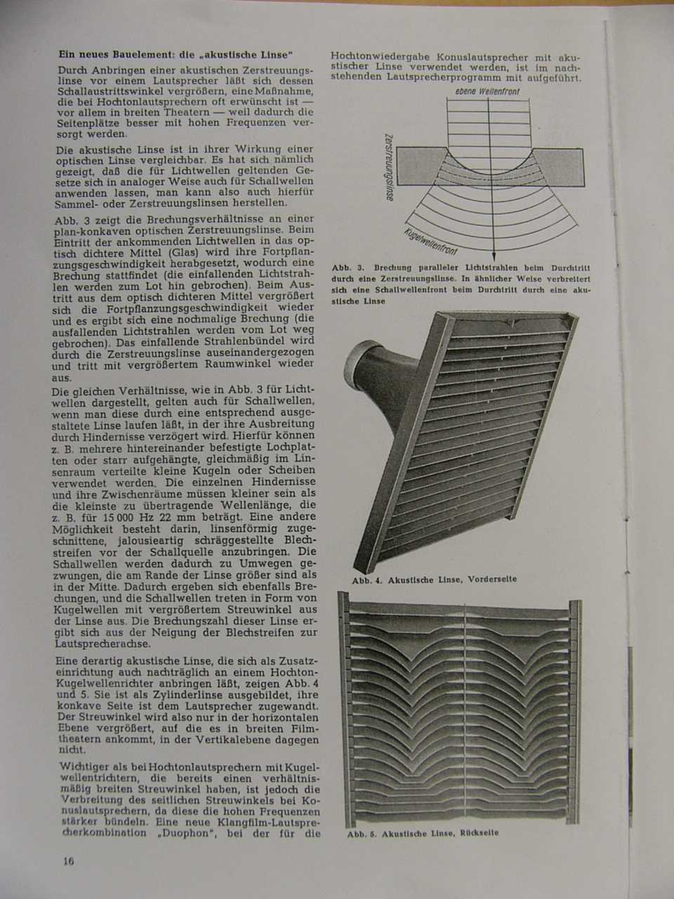

Not a Heil, and they call it an Acoustic Lens not a horn...................just adding to the mix for context.

Hi jzagaja
just what i was waiting for.
any data on how they perform on beyma tpl150?
what are the dimensions of these ?
what is the price?
what is the price?
I'll get samples on 12-FEB and perform measurements with Harwood AM35. I don't have Beyma TPL150. It's labor extensive waveguide.
http://www.diyaudio.com/forums/multi-way/161627-horn-honk-wanted-16.html#post2391121
If you send over a sample, I'll do the measurements with the TPL150 for you - if you like
Michael
Michael ,
i would really like to see your measurements and evaluation of the beyma with jzagaja's dipole horn.
