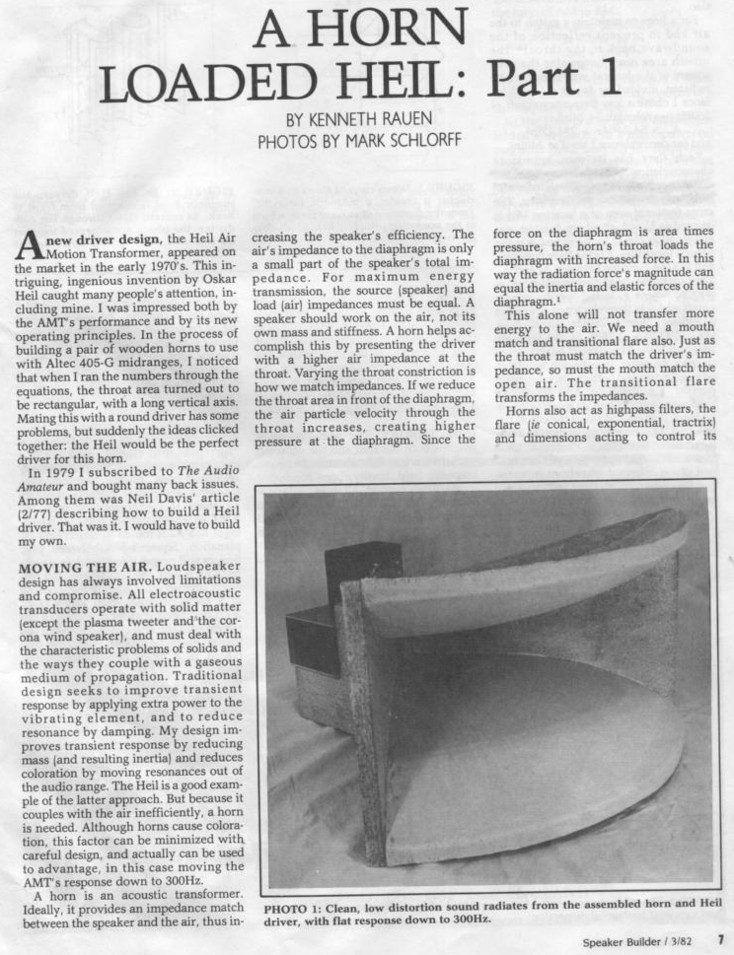

Did anyone see the project in Speaker Builder magazine "Horn Loaded Heil" ?
It looked great with loading down to 300hz. Would liked to have heard it.

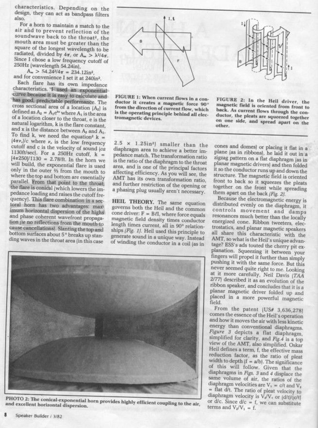

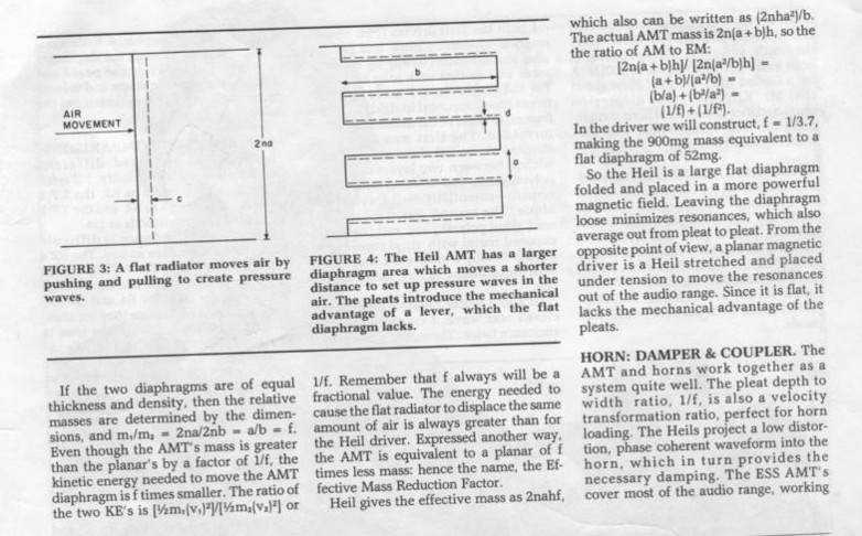

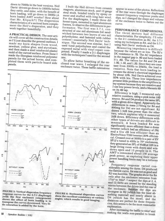

Author is Kenneth Rauen -- A super article/project
Have located two-part series & am scanning tonite!
I'll start adding rest of project here so that everyone can evaluate🙂
pages two & four (page three in next post)

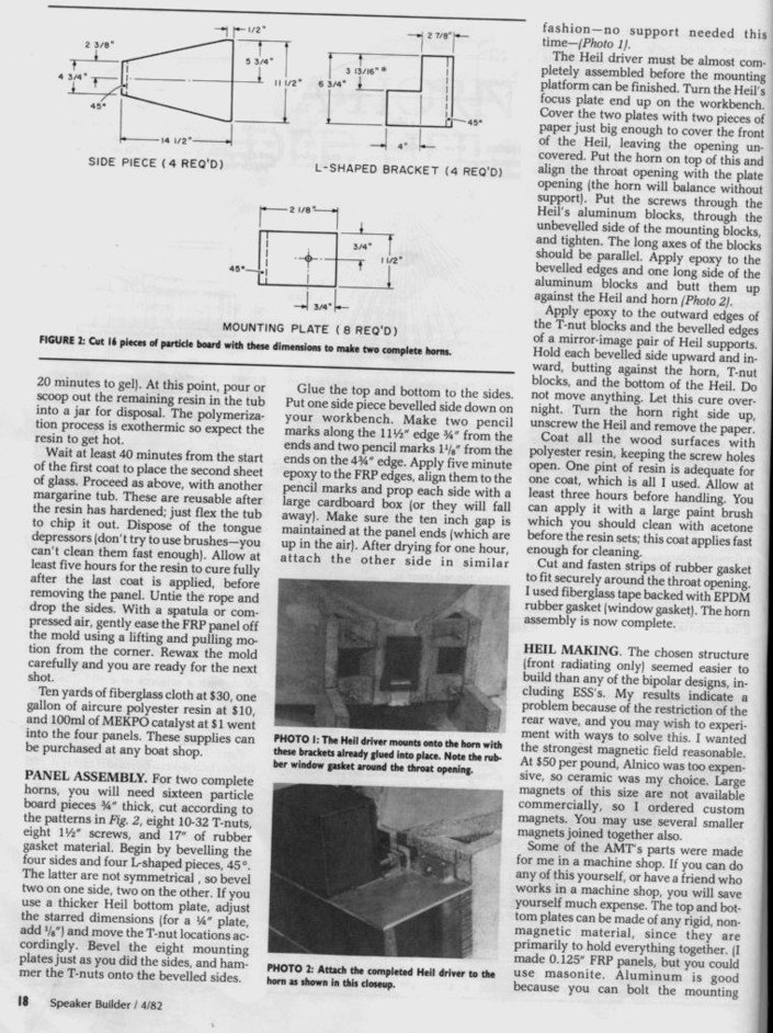

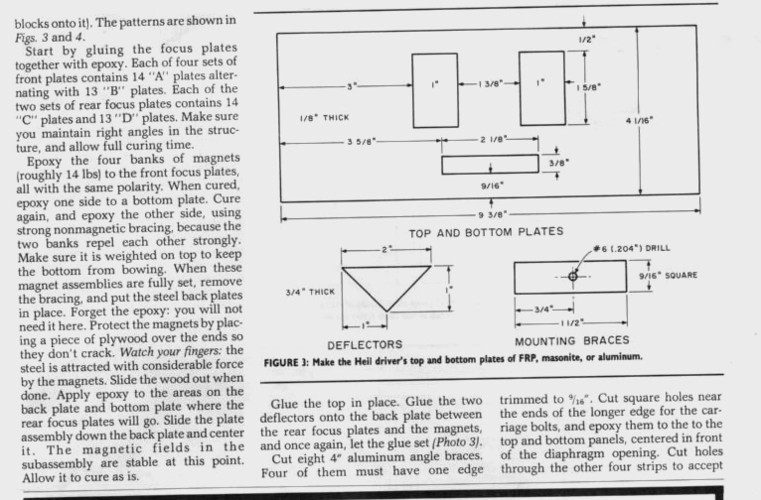

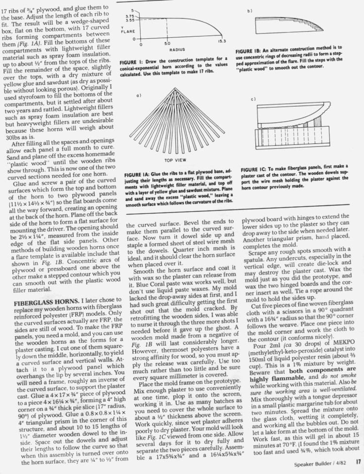

Now to Part 2:
Here the author describes his construction of the Heil 300hz horn and an actual AMT driver (difficult)(most experimenters would rather work with an existing commercially manufactured AMT driver I would imagine)

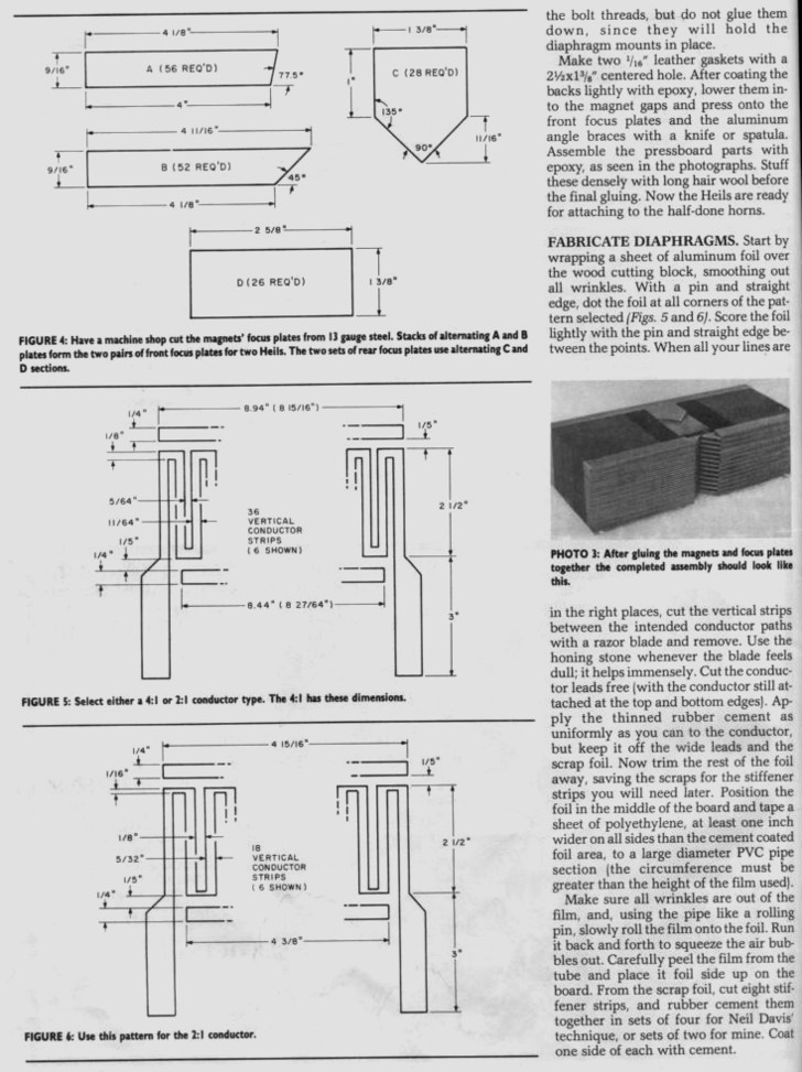

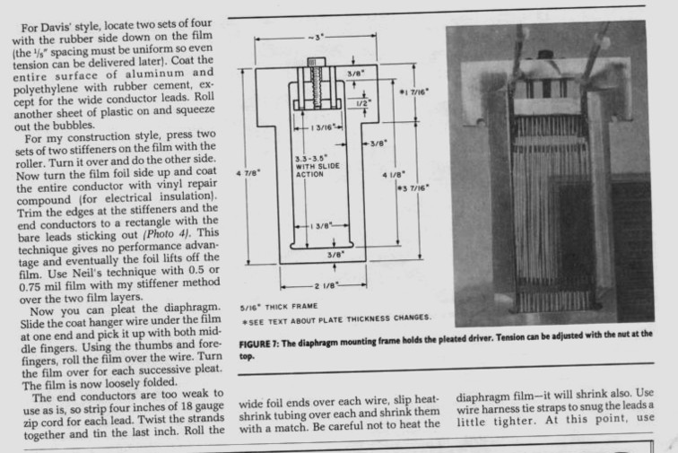

Part 2 cont.
