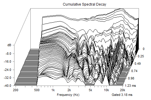

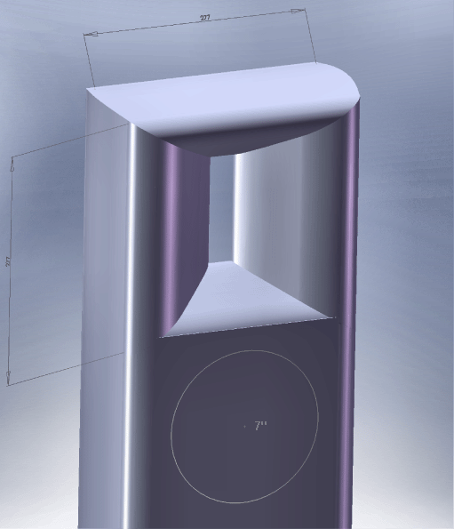

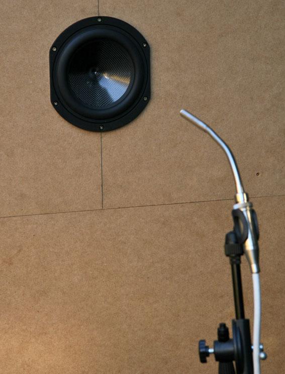

Typical arrangement - quadratic mouth, 7" long throw woofer, nano-carbon for example.
Thanks for the polar/CSD!

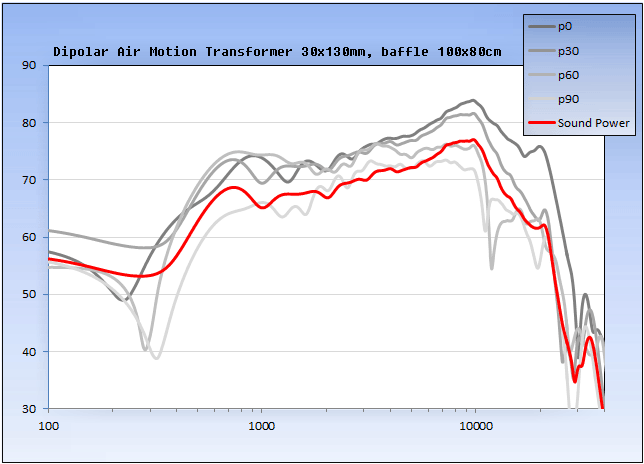

Quick polar pickup of a bigger AMT.
I think the idea of horn loading a big AMT drivers is great! I have been using the Beyma AMT TPL-150H (the horn loaded version) for some time now, and to my ears it sounds incredible - much more natural and detailed than the compression drivers I have tried so far (e.g., no more over-pronounced s- and t-sounds on female voices). The drawback is that the Beyma TPL-150H only loads with controlled directivity down to 1300 Hz. I would really like to take the qualities of the TPL an actave or so down in frequency (e.g. down to 600 Hz). I wish Beyma would make a Giant TPL!!
jzagaja: How does the AMT driver you are using sound down low (it seems to load down to 6-700 Hz)?

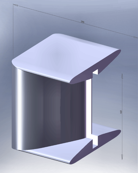

Funny things is now I see my design is exactly as wide as Beyma. Coincidence. Roundover seems larger in GAMT90 Customer asked for low CTC spacing and 120deg coverage. Actually it is 110x65. Throat isn't OS type but mouth is from JMLC. Differences:
1) Premium finish
2) Dipole
3) Snap-in (easy disjoint)
1) Premium finish
2) Dipole

Yes Beyma TPL-150 can work with GAMT90 - she's a bit thicker (3-4mm).
Modular - two snap-in halves for the AMT and bass modules at the top or/and bottom mounted in a same way as those halves.
