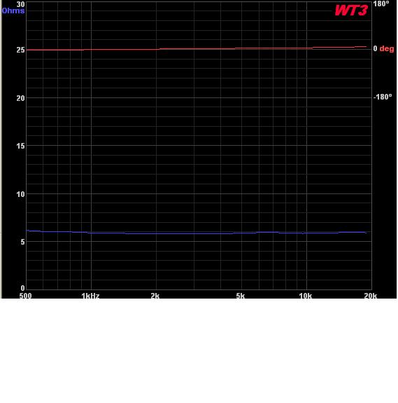

New Math
First I have to get the crossover right, before my fidelity improves. When does 8+6=10? In weirdie heil AMT town!
For some reason none of the icons are working for me on uploading images/linking images, or I'd show that I'm not getting impedance summation from a 20uF blocking cap and the amt1, the 6 ohm (very flat) heil and the near-8 ohm cap value (at 1kHz) are summing to... 10.

Duh, forest for the trees.... forgot to treat it as a reactive impedance not a resistance.
So, some more shaping and testing- 10uF was too small, (might have worked with the top sections of the horns reinforcing the 1-2k region though, that's more work for later), 20uF works real trick. Then we just have that 5kHz bump to deal with, which is notched out with the .22, 3.33, 5R network. Very smooth response but with a top octave rolloff. Who'd have thunk that heils might need a supertweeter!
But the highpass isn't steep enough yet, I'm looking at possibly overlaying a 3rd/4th order 1k active filter. The shaping/protection cap will remain as I'm not trustin my active system to keep my 35 year old phragms alive.

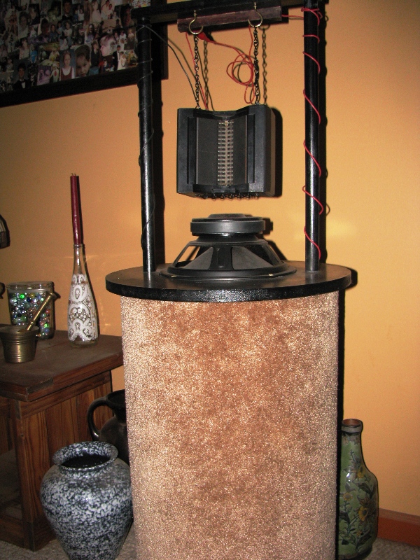

You can see the way the top is shaped to allow the use of a flat top panel below:
They're now higher up (better at ear level) and things are much improved with the 7" or so height increase. Hard to know how much of the improvement is due to the height and how much is due to the new bass cab (still deciding on finish options) is hard to say, the cab is certainly improved over the old one (bigger cab, better bracing scheme, better absorption, and the driver is ring-mounted, giving it several layers of damping in the mounting)

Thanks 🙂 I'm very happy with their performance, hard to say how much the sound is better from the cabs vs. from the heils/woofers being at a better height, but whatever, this camper is happy!
The bracing was CNC cut, to allow the use of a clean shelf bracing method inside the complex shaped cab. There is a bottom chamber below the vent (if/when they become vented) which serves as a top-bottom mode killer, that portion is fully stuffed. The top panel is 1.5" thick with holes, with rounded edges, in the inside layer (.75"), as well as some additional bracing/diffusion. There are ribs, with variable spacing, between each shelf brace. A lot of damping is used at the driver/cabinet interfaces as well as the front panel mountings.
