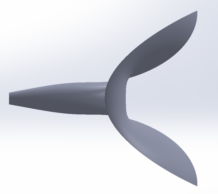

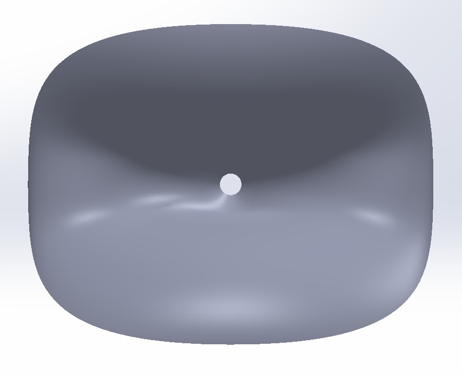

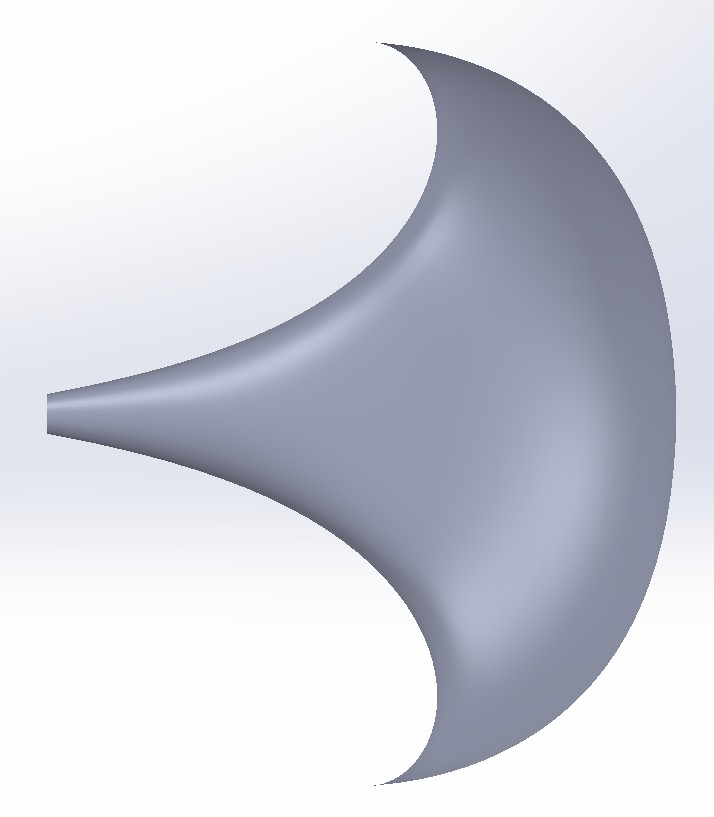

I was asked to design Iwata 200 for Radian 950. This is my proposal based on JMLC spreadsheet with built in adapter. It makes horn longer.
