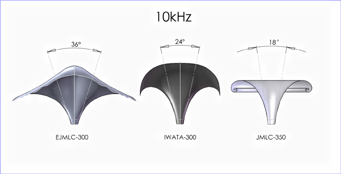

Here is what i’ve got about dispersion from autotech
As I understood jmlc, iwata and e-jmlc have not only different shape, but also different opening angle
I think the new "Iwata" designed by J.M. Le'Cleach is better in terms of reduced diffraction and will likely sound "cleaner". OTOH, I like the looks of the old one better ;-)
And, beware: those angles in that picture that you posted refer to the horizontal beamwidth (probably -6dB w.r.t. on-axis) at 10 kHz; they are NOT the throat angles.
What they mean is that the symmetrical JMLC horn will "beam" the most, the E-JMLC the least, and the "Iwata" somewhat in-between.
