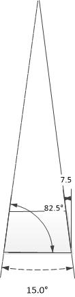

The Radian 475bpbe has an include angle of 6degrees, ie 12 degrees when both sides of the exit is included. (Info received from Radian)
I've had this question for a long time: when a CD exit angle is quoted without clarification what is meant - the included angle of the internal cone or the half-angle formed by the side of that cone with a line parallel to the axis?
Is there a standard practice?
