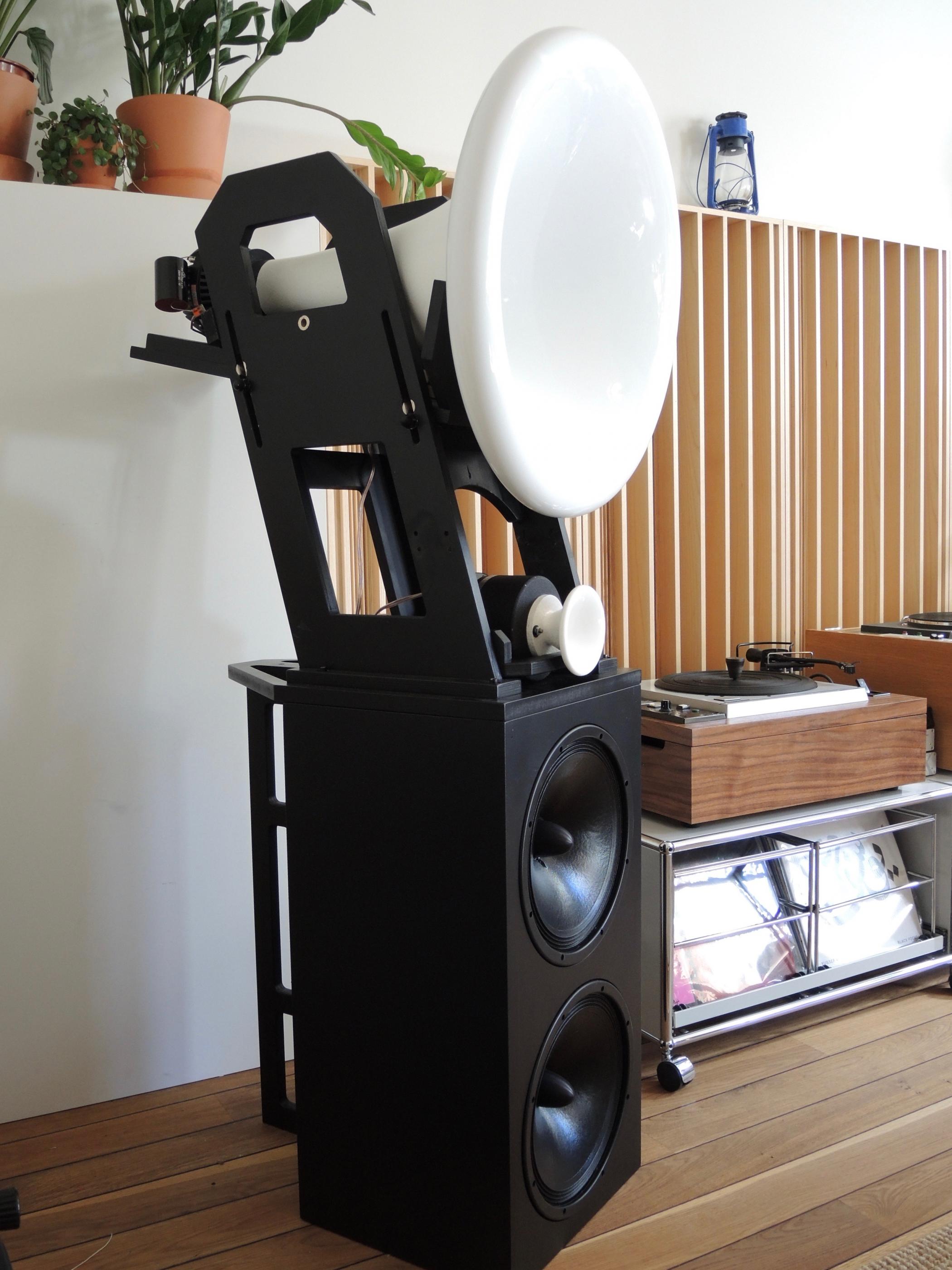

i personally cross at 400hz between the AE td12 woofers and tractrix 200 horn (with a B&C DM50)
i tried crossing over higher but i prefer the lower XO due to the increased clarity and physicality, even though the woofers play just fine on the same frequency (just a bit more diffuse and soft)
(note: i use audiolense, so getting a good XO is easy peasy. if you are using a different method, the crossover frequency might be dictated by what is easiest to achieve with what you got)

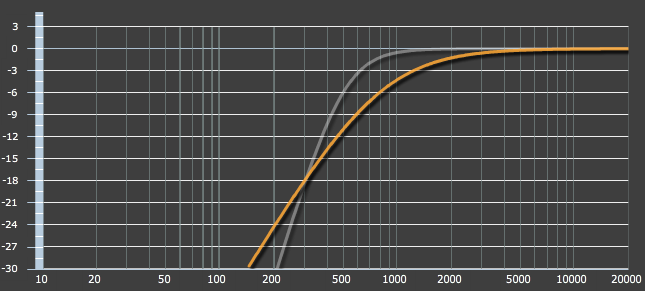

I just afraid to destroy membrane with 600hz @12db crossover
Manufacturer recommended maximum cutoff at 500hz @24db
well, in that case 600hz might be pushing it a bit.

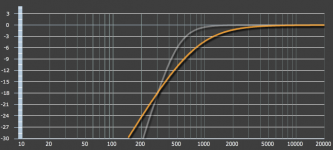

i have added a picture of a 500hz lr24 curve and a 800hz lr12 curve.
i dont know how much of a beating the radian can take, so it might be fine, might not. i dont have much experience with lr12 crossovers that low to be honest. 😱
if you are worried, i would start out at 1000hz, as that would hit -30db at the same spot as the 500hz lr24 curve, then work your way down after listening to it for a while.
or just go the extra steps and make a passive 550 or 600hz lr24 XO 😎
