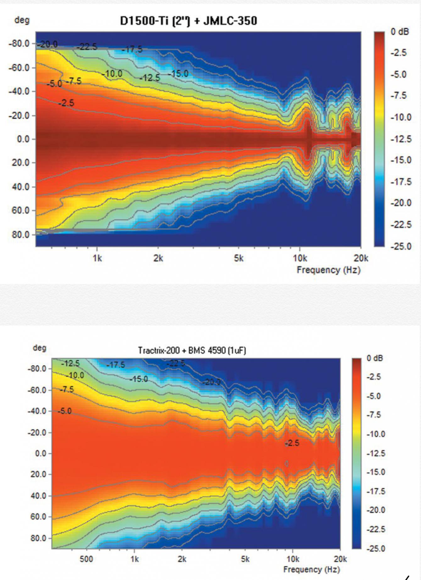

Do you care about getting the throat angles to match?
A modern driver like yours has a throat entry half-angle of 10.3°, see here:
Radian 950 pb exit angle 10.3° (20.6°)
The perfect jmlc horn would be one that has a throat that matches this angle.
These would not be perfect:
Azurahorn -Le Cleac'h Acoustic Horns - Products
...because these jmlc horns all have a T factor of 0.8 or lower. This means they have a throat entry half-angle of 5 to 6°. This angle is an excellent match for many vintage drivers, but not for yours.
Auto-Tech and other sites don't seem to state the T-factor or throat angles of their devices. Doing a guesstimate based on the length of the JMLC-350, its throat entry half-angle would be about 4°.
For your throat entry half-angle of 10.3°, the ideal throat continuity would be achieved with a jmlc horn having a T factor of about 1.4 - which dictates that it would be a rapidly opening horn, of about 19cm depth.
I was asked to design Iwata 200 for Radian 950. This is my proposal based on JMLC spreadsheet with built in adapter. It makes horn longer.
