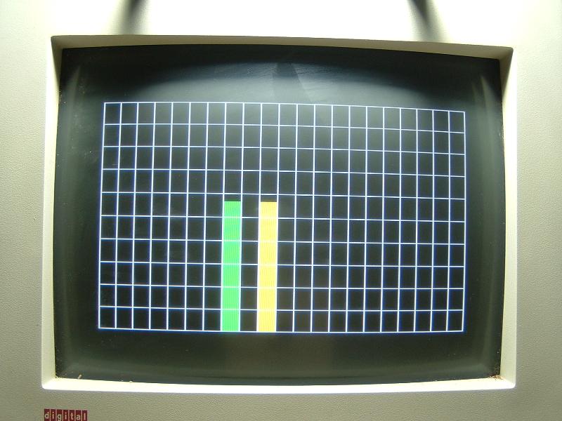

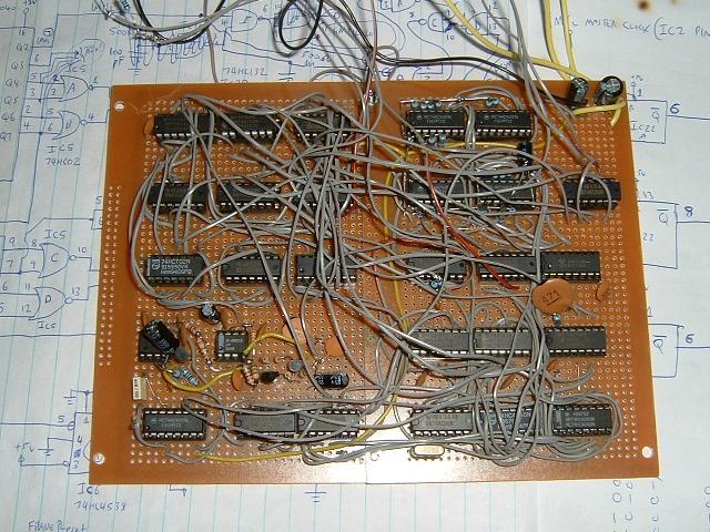

The prototype video generator is complete and working 100%. A photo of the screen is attached. With the design proven, all I have to do now is layout a proper PCB and assemble the finish product.
I have also updated the 20 second video:
http://users.picknowl.com.au/~glenk/VGAASA1.AVI
This time it is a little more exciting as I wired the potentiometer to two level bars inputs, so there are two level bars dancing on the screen this time in unison. Note that the flickering in the video is an artifact of the frame rate of my camera strobing with the frame rate of the SVGA monitor, and does not exist in real life.
The display will look much more dramatic when I have completed and wired in the 21 band filter/detector board, with all 21 level bars dancing on screen to music
Glen

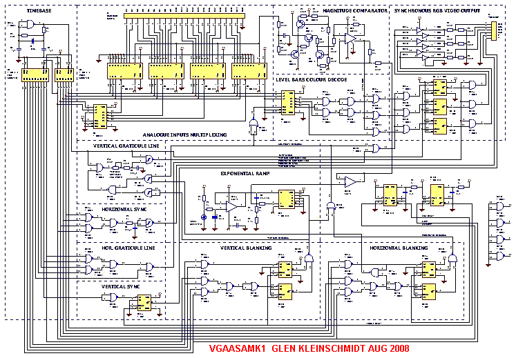

Well now I’m just going to make myself look like a liar. However I’m just posting an update because things are progressing much quicker that I said they would.
If anyone is itching to get their soldering iron working, here is the complete video generator schematic. The band filter / peak detector board will follow on my website this evening.
Glen

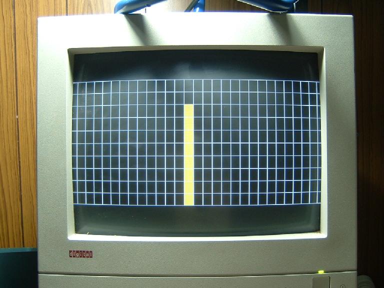

Glen,
Looks great! Presumably we can use this unit to look at the spectrum of a signal. Is there any way to bring this picture into a PC for documenting things? Is there a regular video signal that can be connected to a PC and stored?
A personal comment, not meant as a criticism: if the 'bars' would be narrower with some space between two adjacent bars, wouldn't that look more, ehh, professional?
Jan Didden

Thanks for the compliments guys.
Jan, I originally had the graticule signal blanking the level bar video, producing a space between the bars, but then I decided that the white graticule looked better
The display could only be imported by a computer with a video capture card that accepts VGA video. Don't know if such a thing exists.

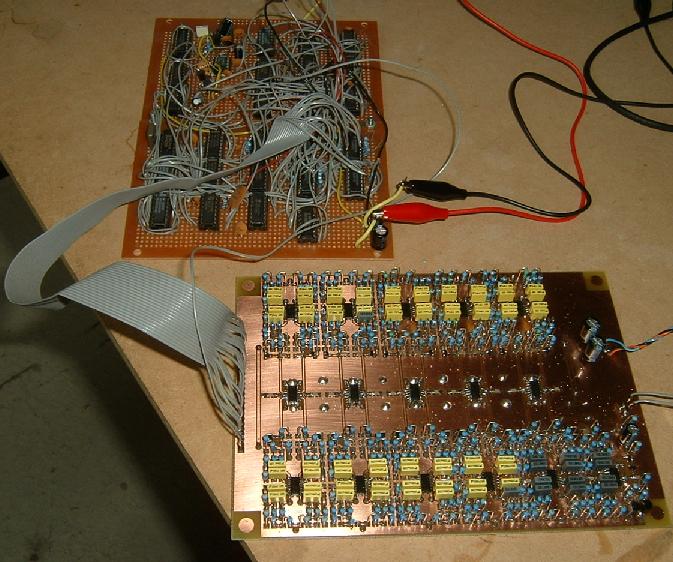

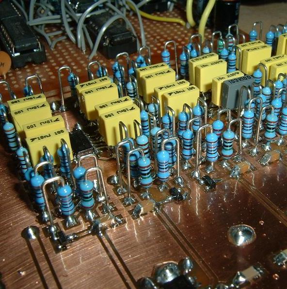

Anyway, today I finally finished loading the 21 band filter board and wired it into the video generator (still in rats nest prototype board form) and got the whole thing up and running.
Here is the coolest part - I have updated the video of the unit working in final form - The *.AVI file link again:
http://users.picknowl.com.au/~glenk/VGAASAMK1.AVI
In the video the analyser is connected to the audio output of a CD player, playing ‘Devils Dance’ by Metallica .
Full/finalised/tested circuit details of the half octave unit are now up on my Web page here:
http://users.picknowl.com.au/~glenk/VGAASAMK1.HTM
All I have to do now is etch/drill/load the PCB for the video generator and rebuild the unit, all neat and tidy into a 1U-rack case along with a power supply.
I intend to add a write up the circuit operation in the next week or so.

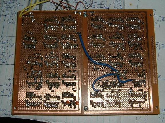

Oh, and the fully functional prototype as featured in the video:
