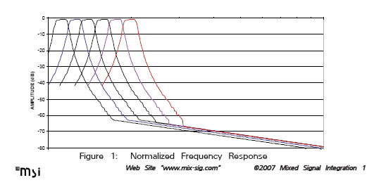

jackinnj said:
That is a really nice part. With 10 of them I can whack up a really simple no fuss analogue board for a 60 band (20Hz-20kHz) audio spectrum analyzer with excellent resolution, without having to buy an expensive DSP eval. board.
If they are not too expensive I'll order myself a bunch for the next analyzer.
Thanks!

G.Kleinschmidt said:
Being no listed distributor here in Oz, I did what the datasheet says and emailed MSI yesterday morning for pricing and MOQ.
No reply yet. Slack 😡
Glen
The MSSCSSA is a bank of switched capacitor filters set up in bandpass configuration. You can do much the same thing "in solder" -- but it will be expensive and time consuming to lay out.
I like the skirts on crystal filters better than RC, but the last time I worked with a DIY crystal filter on my own was with a SSB exciter over 40 years ago.
Not too many crystals cut for audio frequencies though! 😀. I guess one could up convert to a MHz or so and xtal filter then, but the last time I had a single xtal cut it was something like $17.
Have you had a play with that MSI chip? The datasheet is pretty sparse. There is no mention of Fclock feed through - which would dictate how much (if any) post bandpass low-pass filtering (and thus, to a large degree, the complexity of a 60 band filter/detector board) is required for a given S/N ratio.
