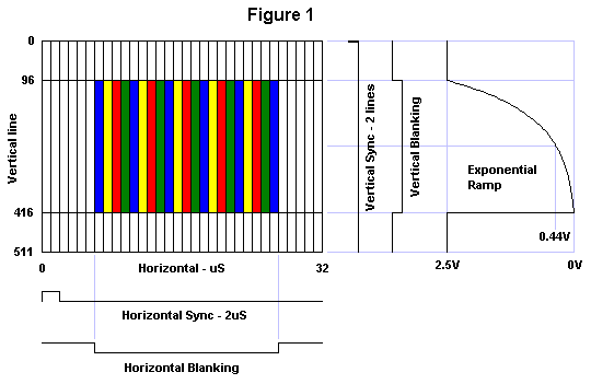

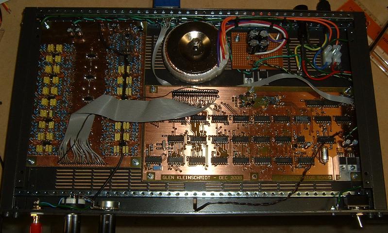

Got the thing up and running in a 1U-rack case today. Still have to etch in install the final version of the digital PCB though. The prototype board version in currently in situ, insulated from the chassis with a bit of cardboard 😀
Have not begun the write-up on the circuit operation yet, but the diagram attached below that I just put together in MS Paint, along with the schematics on my website, should explain everything............ 😕

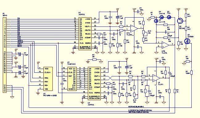

Attached below is a quick teaser pic of how far I got this evening. This is the display module that will plug into the digital motherboard. It contains it’s own little PIC uC (timing functions / sequencing), a pair of 12-bit DAC’s and is responsible for reading out the contents of the double-buffered display/record memory and generating the analogue signals for producing the analysers frequency domain display on an external analogue oscilloscope.

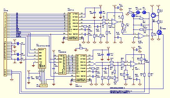

Now that is what happens when I draw circuits late at night. I'm using a SMD PIC micro (SOIC) so that means I'll have to add an ICSP header the circuit.
Here is the ammended schemo for the display module (high res versions will follow later):
