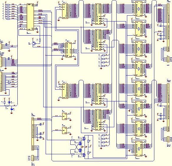

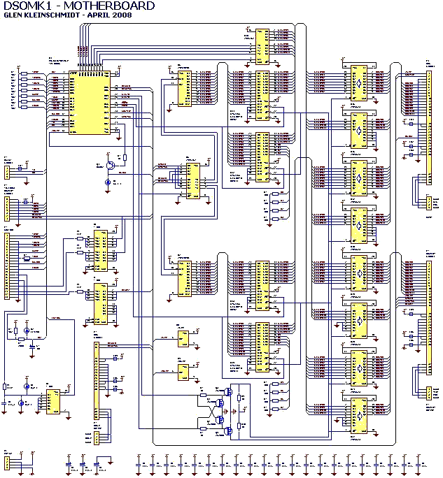

The Mother Board schematic is completed; will have the hi-res version up in a day or two along with the PCB layout.

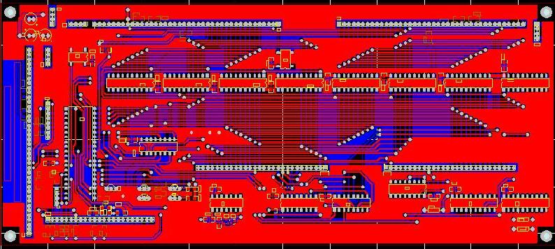

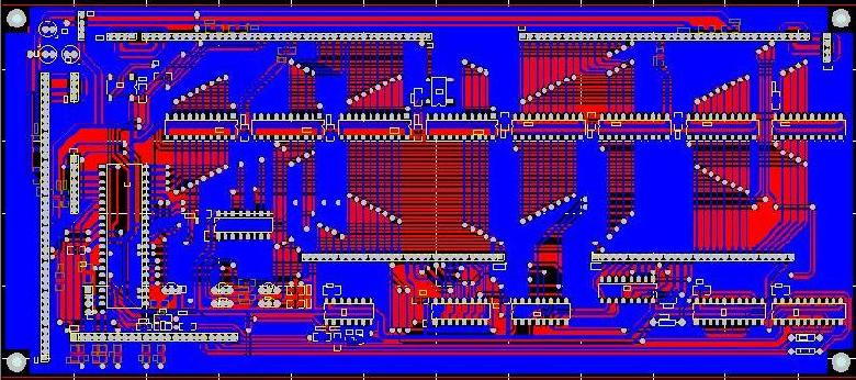

Here is the completed motherboard. I used DIP'ed devices for the IC's and SMD for most of the passives. I could have easily made it 1/4 the size if designed to be manufactured at a board house, but I had to keep it homebrew friendly with tinned wire feed-throughs instead of plated through holes.
There are so many parallel address and data lines that you have to keep to a minimum via size and track width / clearance to ensure success. You also have to return tracks to component pads on the layer that a soldering iron can get too. Anyway, like with the VGAASAMK1 project I’ve erred on the conservative side and this board will be a piece of cake to make / hand-drill and load.
I made a slight modification to the motherboard schematic also, in that the SMD memory chips have been put onto a pair of “memory module” daughter boards that plug in to the motherboard vertically via 90-degree SIL headers. The paralleled address line routing was getting too much of a mess.
There is also another daughter board which I forgot to mention before – the “DAC module” which provides the 0-10V ramp output, synchronised to the recorder section timebase for controlling an external analogue VCO for spectrum analyser applications.
The RS232/comms module and the timebase display module are separate from the motherboard and will mount behind the instruments front panel.
