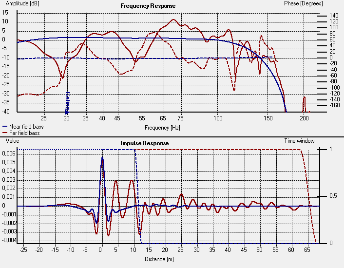

My LF-Dilemma
I'm a physicist of education and it hurts my ideology to guess the response. It can be a reasonable method, but we must distinguish measurements from extrapolations - I mean use the correct nomenclatures. A measurement vs. an extrapolation
I have very good experience making near field (1-5 cm) from LF drivers.
I'm struggling to make time+gain alignment between the LF and the MF (Bass -> Mid with x-over at 100-150 Hz).
My experience here is that we can not and will not neglect the room for LF measurements and alignments. Remember the wavelength at 86 Hz is 4 meters.
We all know that we cannot measure the far field LF without the room. The best we could do is measure at different positions and in different rooms, then we know that the difference is the room.
Far field LF measuring is really hard. In HOLM Acoustics we are correcting bass drivers near field using FIR-filters. Attachment shows a corrected bass near field and far field.
I'm really in a LF dilemma. My speaker sounds awful outside in the garden were there is no room, but in my room the impulse response is so ugly

I'm a physicist too and I have no problem with "extrapolation" of missing data from known data. It's done all the time in cosmology and almost every area of physics that I know. You must, of course, distinguish between the actual data and the extrapolated data and physicists usually put error bounds on these extrapolations, which, of course, get greater the longer the tail, but then the tail is getting smaller and smaller. It has been shown that these "extrapolations" can be very accurate.
As to the room and the source coupling and the use of near field data to EQ the source, I could go on and on (and would love to since this is what I did my PhD on "LF sound field in small rooms" and I have spent decades on the topic), but that would easily go far astray of this threads topic, and I think that what you have done here is important. Should you care to continue with the LF discussion sometime just let me know - I'd be happy to attend.

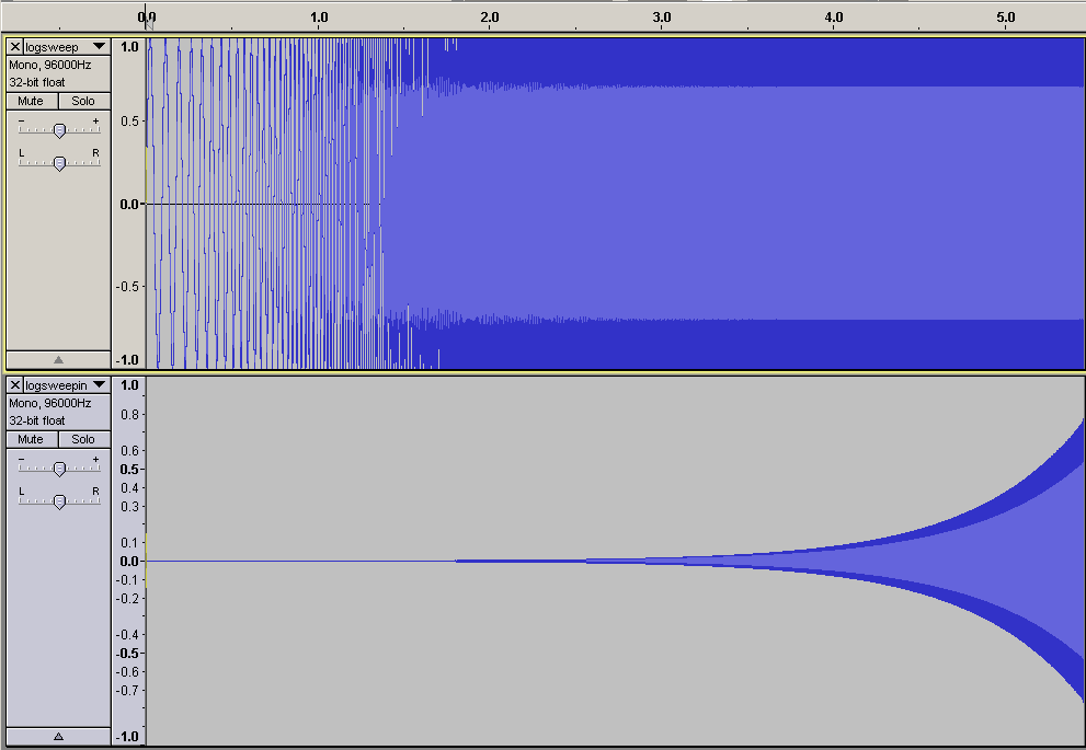

What to do with these wavefiles?
I actually think it's interesting to see the waveform of the inverse correlation - maybe fadein would give a nicer inverse correlatin of the logsweep. Farina and his friends does not seem to care about the inverse waveform, but that might be why they could not explain their low-frequent artifacts.
Attached logsweep and the inverse

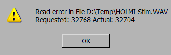

Hi Ask,
At first, again big thanks for your rapid update and the new features, very good!
The inverse imports correctly (32Bit-float, that is what I've tested), but the stimulus doesn't (see attachment). Looks like a header problem.
Samplitude lets me nevertheless save into an new file, and then the sample lengths of both files match (1048576, =2^20).
But both files look funny. The stimulus has something odd at the very end (maybe a result of the above problem), and no raised-cosine fade-in/out (like Acourate's LogSweepRecorder does). The inverse starts with an exp "fade-out" of fs/2 samples leading into sort of a "DC tail" and there is this fs/2 noise on the signal in the beginning part of the wave.
So much for today (tonight that is, uh, it's 3:30AM)... I'll dig deeper tomorrow.
- Klaus
