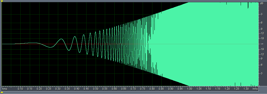

HOLMImpulse: Measuring Frequency & Impulse Response
Sorry Ask, there are still issues, it seems.
The fade-in is exponential, not raised-cosine, this gives a kinky spectrum and the default of 2 times the initial period time is problematic, too. With a start freq of 1Hz this means the stimulus is invalid during the first two seconds. Depending on the length used it may fade-in longer than the whole waveform runs. With shorter fade-in's the problem remains, there is a kink visible in the waveform itself with disastrous effects on the spectrum (and that would give artifacts in the distortion components, wouldn't it?)
Also the inverse still doesn't look right to me. I recognize that you construct the inverse in the freq domain so as to give a dirac by design: after reversing the inverse I get a reasonably (<> fully) perfect dirac when I convolve with the stimulus, no matter how corrupted it looks -- but only if I *don't* extend the stimulus on the ends with enough zeros, otherwise there are strong artifacts (echo pulse). This resulting "loopback" pulse should be artifact-free at any rate and should IMHO resemble the bandpass response used for the stimulus. That's at least what I did in my own experiment and I get a perfect artifact-free IR when loopback folding and the sprectra also are as clean as can be, so I doubt it's a computation artifact from Audition's convolver.
- Klaus

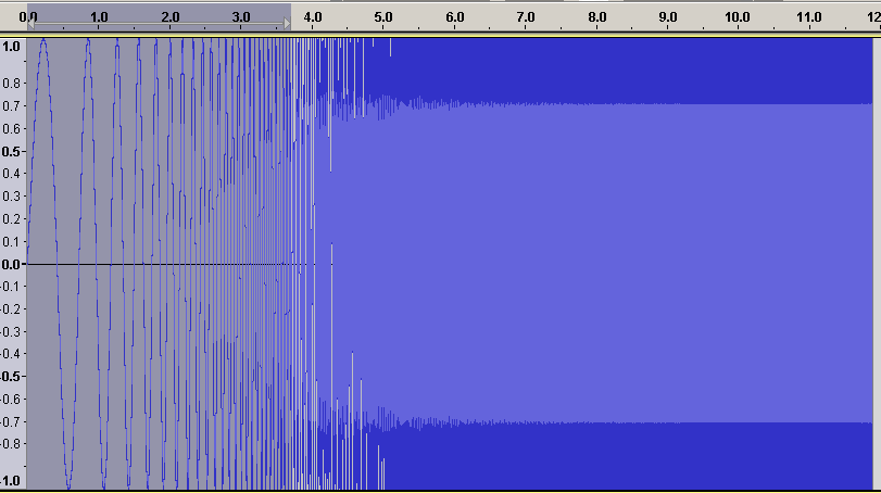

4. LogSweep and starting frequency
Let us say we measure at 44.1 kHz, from 1 Hz to 22 kHz, then 1/3 of the measurement time we are measuring frequencies below 20 Hz - We do not want that. BTW Farina starts at 20Hz - I find a good compromise starting at 10 Hz. See attachment for the 1Hz example
5. The inverse signal - Convolution is circular - zero extension
You must make a circular convolution of the inverse signal and the signal. Extending with zeroes? If you extend with zeroes before and after the signal and the inverse before making the circular convolution - yes then of course you will get garbage.
If extending the signal with zeroes before and after we must recalculate the inverse (HOLMImpulse does this when measuring)
I could add an option with adding zeroes to the saved signal and the inverse. Eg. if we have signal length 2^19 = 524288, then I will add 2^18 = 262144 zeroes before an after so that the new length of the zero extended signal and the NEW recalculated inverse is 2^20 = 2^19 + 2*2^18 = 1048576.
Is this what you want?

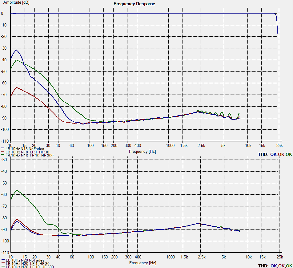

I measured six combinations: Loopback, 48kHz, ASIO, start at 10Hz varying signal lengths (2^18 and 2^20) and the fade-in's and -out's :
a) fade-in 0, fade-out 0
b) fade-in 1, fade-out 30
c) fade-in 10, fade-out 300
The effect on THD can clearly be seen, on both ends. Note that for N=18 the fade-in=1 gives the best result (but still not the known level for the card, which is below -90dB at any from 10Hz to 1kHz). This might come from two things :
1) the kink in the waveform (in case of fade-in=0 right at the start) givensmore than necessary harmonics,
2) to a presumably way lesser extent, the loss of S/N as the stimulus has low amplitude in the fade areas.
- Klaus

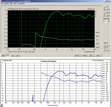

One more thing that I don't really understand (I am still a beginner).
If I compare the HOLM measurements with ARTA's. The magnitude is similar but the phase is very different.
In Holm the phase stays between +180 et -180 but in Arta, in goes from -180 to +180 a lot of times.
I guess there is something I have not understood yet...
Someone could explain ?
Thanks a lot!
domtw said:
When I change the IR unit to time (ms), my choice didn't stay and it went back to the distance unit...
That is a bug - thank you for telling
I am not sure if the latest is feasible but that would be great for time aligning drivers.
I'm working on it...
It's all about time zero
In the attachment I have compared the gain+phase between ARTA and HOLMImpulse (Imported wave-file impulse to ARTA)
In ARTA you will have to set time zero at the impulse peak - please refer to ARTA threads about this
