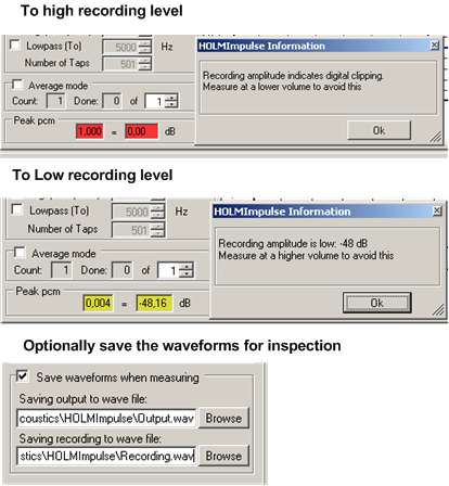

Levels and more
When I measure logsweep I use a full scaled PCM-signal - if you want a lower output you will need to adjust this using your windows mixer.
Thanks again for the feedback

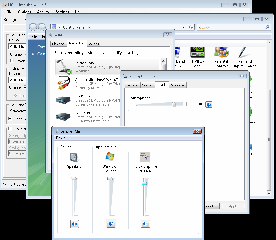

I am aware of the parts of the program that you show, but they don't help really. I think that the software may not be working with the windows mixer in the way that you think or not in my system. I do not seem to be able to turn down the output signal with the mixer. All I can say is that setting levels is really confusiong. It may be an odd part of my system - Vista 64 or sound card, but the input levels cannot be changed in the mixer because the software overrides it every time. You have to exit the software, change the input level and then strta the software again because it will only use the level set when the software starts. It resets it back to this level at every run. This may not be your program as I run two measurement systems at the same time.

Mixer Levels
Output level
HOLMImpulse does not alter the mixer. In Windows Vista you can adjust output levels for individual applications and master. In Windows XP you can adjust master and PCM.
If your other applications adjust the mixer settings (Like audiotester does) while you are measuring, then I also get confused - why I have not included windows mixers.
Input level
The PCM wave I record is also given by the windows mixer level
I have tested this in windows XP and Vista - In Vista you might want to check the keep-stream alive box + restart - this way you will have the HOLMImpulse application in your Vista mixer before measuring.
No mixing in HOLMImpulse
Because of OS dependencies and other trouble I'll not implement mixer control in HOLMImpulse - I will leave all the control to you and your OS. Like audacity (http://audacity.sourceforge.net/) does not alter the mixer settings.
