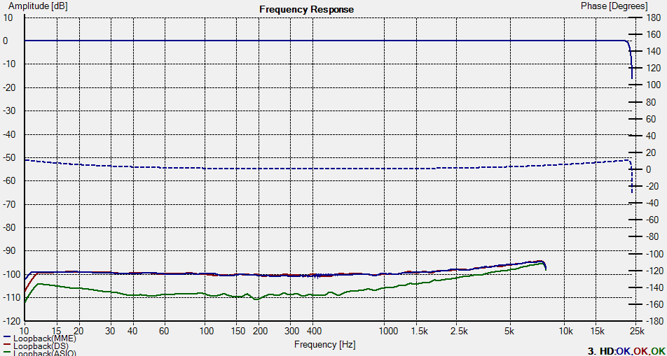

MME, DS (DirectSound), ASIO
I have made a test with my USB soundcard (analog loopback)
It seems that ASIO is slightly better regarding higher order harmonic distortions. (See attachment where the THD is shown)
But MME and DS are the same.
DS is also controlled by the same volume settings, but might have improved latency, which does not matter in this application.
http://msdn.microsoft.com/en-us/library/ms790010.aspx
My measurements were reproducible, but I have no explanation why the ASIO did perform slightly better

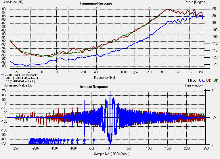

I found the same (internal semi-pro soundcard, so jitter from clock regen in the USB-card is not the cause, it seems). The error term is in the odd harmomics, 3rd especially. It's weird, isn't it?askbojesen said:I have made a test with my USB soundcard (analog loopback)

Bugs an future features
(Notice the harmonic distortion pre-impulses, that are marked)
(Just one filter at a time perhaps)
- 32 bit float wave
- 64 bit double wave
- 16 bit PCM wave (ARTA compatible)
- 24 bit PCM wave (ARTA compatible)
- 32 bit PCM wave
Thanks for telling me
I'll be back with a fix soon
Not at any zoom? - Try the dB scale in the impulse domain and scale to lets say -130 db and zoom out like I have done in:panomaniac said:Thanks very mmuch for the new features! You've been working hard. I like the DS and ASIO support. Below you will find my M-Audio USB Duo in loop-back with all 3 modes. Don't know why the THD shows lower in ASIO, as the impulses look identical - at any zoom.
