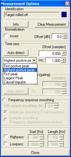

I have some problems with phase meassurment. To make things simpler i have made a lowpass filter of an inducter and a resistor. L = 850uH and R = 5.6 F3 around 1Khz
The phase shown at 1Khz is about -15 degrees. It never gets bigger than -36 degrees and about 2 Khz it start to go positive again being 0 degrees at 7 Khz.
Finally being +170 degrees at 20Khz.
Am I an idiot or is there something wrong.
The absolute phase depends on what is called "time zero" this can be adjusted in Holm and if done automatically it does not always find the proper zero. Go and adjust the time zero by small amounts and you will see the phase change. At some point it should be close to reality and this is the 'true" time zero.
Yep, what Earl says.
There are several ways for HOLM to find "time zero". It can be don automatically with the measurement, or after the fact in the Options button of each measurement. See below.
Highest Positive peak usually works best. Chose one of the methods from the drop down and click on "auto Detect". You may have to invert your measurement good results if the impulse is mostly negative going.

Causal Impulse gives me much more phase rotation, especially in the HF. Is that real? I'm comparing it to Largest Peak, which works for both positive and negative going impulses. There is not much explanation of the Causal Impulse time zeroing in the manual. Can someone explain the difference?
Time zero is a question of definition and what your're looking for. Causal just means the phase reference point should be right at where the output signal first starts, emerging from the noise floor.
Oftentimes more useful is to use the center of high freq signal components ("largest peak" with any normal speaker/driver) as the time zero because this minimizes phase wrap at HF.
You can find the zero delay point for HF by converting the whole signal to minphase externally, reload it and try match HF phase rolloff of the original pulse to it, at least overall rolloff behaviour, and if you can't get a in-detail match you also know your HF is not minimum phase (in the sense that it is plagued by very early reflections, mathematically it is still minimum phase unless the echo pulse/s is/are exact same shape AND level as the primary pulse).
Thanks... so, largest peak should work. It does work, I was just curious about what causal impulse was doing.
Did not follow your last paragraph. What do you mean by matching rolloff of original to the min phase version?
The problem is for HF we know that the phase must roll off corrsponding to the rolloff of magnitude shape, but we don't know how much in detail. We know that a speaker cannot have a phase going more positive while the response falls at the same time with the correct time zero, as well we know that the phase cannot roll off negative like crazy when we see a moderate response rolloff. So we can only eyeball correct time zero (much easier to see a dead-time related rolloff in linear frequency scale, btw, as it becomes a superimposed slope on the real phase response). Only way to find the exact point (for academic interest, that is) is to covert to minphase which makes the HF start at the first sample, reload it without auto zero detection and move the original pulse in time in 1/10th sample fractions until you see the same rolloff at HF. Largest or first peak is typically very close so that should do in most situations.
