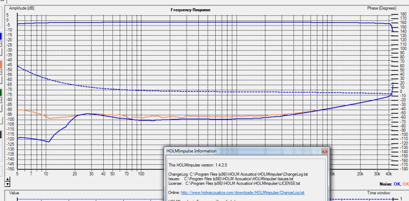

Oh, I just discovered something strange. If I start the graph lower, like 2Hz, the distortion displays lower. Odd.... will do some testing and report back.
My configuration file (zip attach)
Thanks for the config file. I can't load it because you have a later version of HOLM than I.
Yours reports V 1.4.2.6 and mine is 1.4.2.0 I didn't know there was a later version. Is yours for 64bit?
Anyway, the config.xml looks different enough not to work. And maybe it's a version difference between mine and your that is at the root of the differences we see.
...the differences we see.
ok, now i try the old version and yes i have a 64 bit (on Windows 7)... 😉
That may be the reason. I might be able to test it on Win7 64bit on Monday or Tuesday.
today i've tried the old release, this is the screen grab...and the .zip config file.

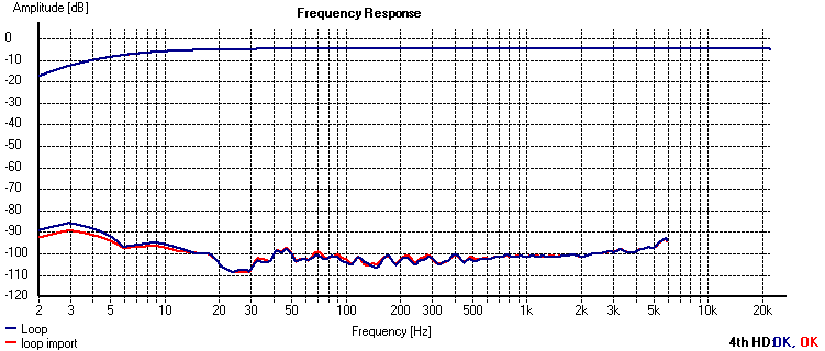

In first I want to congratulate You - amazing project!
I use Speaker Workshop. In SW pattern signal for left channel is compare with signal from Right channel (signal from microphone).
After this compare You get chart in your screen. Before measurement you must calibrate Speaker Workshop - inpute amplitudę must be about 16k.
Could You tell us how it's work in HOLMimpulse?
