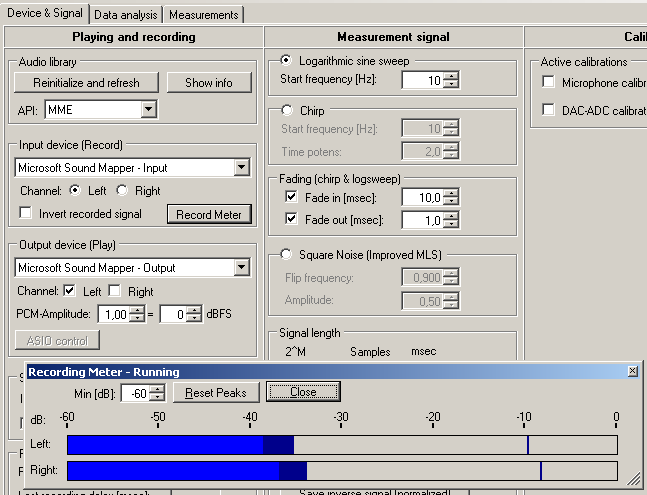

The record meter can help you adjust the volume - Now I guess we need a sound generator (pink noise) while adjusting volume in the windows mixer or the soundcard hardware

Nice meter! Would it be possible to have i selectable to linear for greater accuracy?
Recording meters are usually linear for that reason.

Linear recording meter?
HOLMImpulse can't do.
Well you are not able to see the noise floor at eg. -60 dB = 0.01 = 1% using a linear recording meter... If you adjust the minimum to - 20 dB you will have the same accuracy. I guess what you want is a aboslute scale depending on your hardware - we need a pistonphone abolute callibration of the microphone.
(Or a voltage meter calllibration when measuring electric signals)
