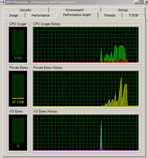

Found a bug.
The rectangle that you use to zoom in to a graph eats up 100% CPU when moved around. It also moves a tremendous amount of data though memory. (memory usage goes up and down very fast, looks like "noise" when graphed. It also keeps the memory usage some time (depends) before it is dumped after a while, which is also little random.
I have not looked into it that deep.
Found a bug.

You mean the adjustable rectangle for zooming?
I have tried all zooming possibilities while checking CPU activity and didn't notice anything strange...
You are right!

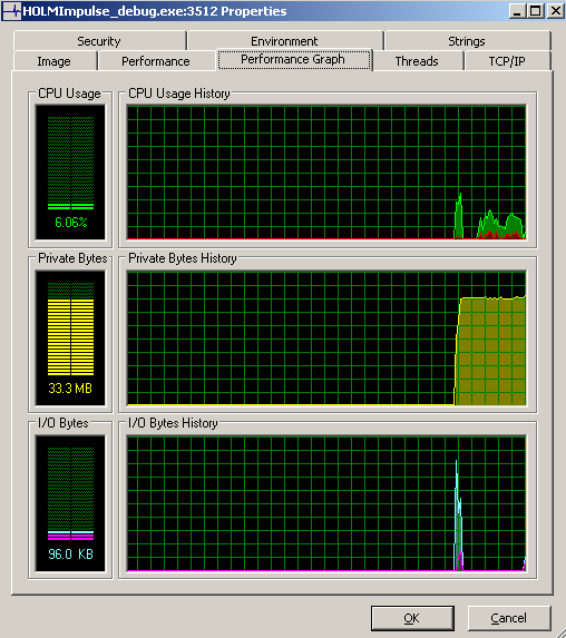

You are right about the memory usage. Below shows memory usage up to 400 MB when moving the rectangle around - The memory usage drops afterwards - The .Net garbage collecter works - and I don't have any referenced objects.
So It's not a real bug ;-)
The other memory profile shows usage after I improved the code.
(It will be there in next version
Bad code:
DrawImage(Drawing::TextureBrush(bitmap).Image,0,0);
//Each time a TextureBrush object is created
Improved code:
DrawImage(bitmap,0,0);
