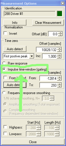

If you slide the gate's dotted line toward the left (in the impulse window) you will see the Gate marker appear on the FR plot above. It will move to the frequency that corresponds to the gate time. Watch out, it moves fast! It moves in the opposite direction.
Try it and you'll see.
That's just it,the gate marker never appeared ! :eek: You know Pano I come to the realization that me and measuring don't mix ! Or my equipment just sucks period.We have found out that it isn't the soundcard,Mic,cable, the only thing left is my computer.I have followed the instructions to no avail what's left.

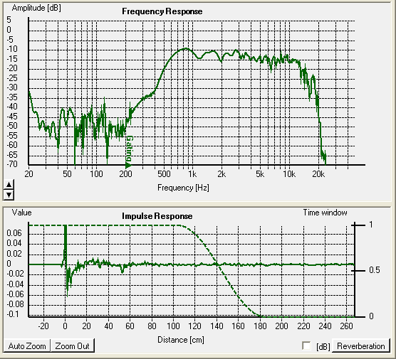

My Freak'n Head Hurts !! You know the measurements look fine it is just the distortion in the bass region from 30Hz to 150 Hz and then it drops like a rock ??
Can you post a screen shot of the response and distortion? I looked through the thread a bit but couldn't find anything... Have you tried measuring with the mic close to the woofer and decreasing the signal level to see if the distortion goes down? Better, have you tried doing a loop measurement with just the sound card?
Loopbacks are perfect flatlines,The frequency Res. are of a Altec 288 on a 511E horn and I tried this one with Mic 2" from front of horn Thanks !!
Administrator
Joined 2004
You need to try a close (~6") to the woofer measurement to see what's up. When I checked your soundcard, the distortion only came when there was a driver/windoze problem.
If the loopbacks are good, the measurements should be, too. Try a close woofer run - watch your levels - and post it here. Who knows? Maybe there is something odd about the amp or connections.
OK these look fine the Mic was 6" away from Dust Cap.I also tried the gating and doesn't show marker I took a screen shot to show you.:(
But the woofers look good only the HF drivers are what show the high distortion as John says though it looks normal.Herb from Cross Spectrum said the same as long as it isn't in the drivers passband not to worry. Here's the screenshot Thanks Guys !!!

Yeah, that's better. The distortion does head north below 55Hz, but I suppose that's to be expected. As my stuff is not set up, I can't confirm.
Don't know why your gating is not showing up. Should be at about 100Hz with the line where you have it. :scratch: Maybe unlock it and try the "auto detect".

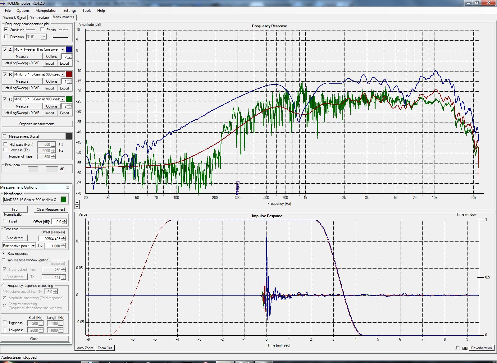

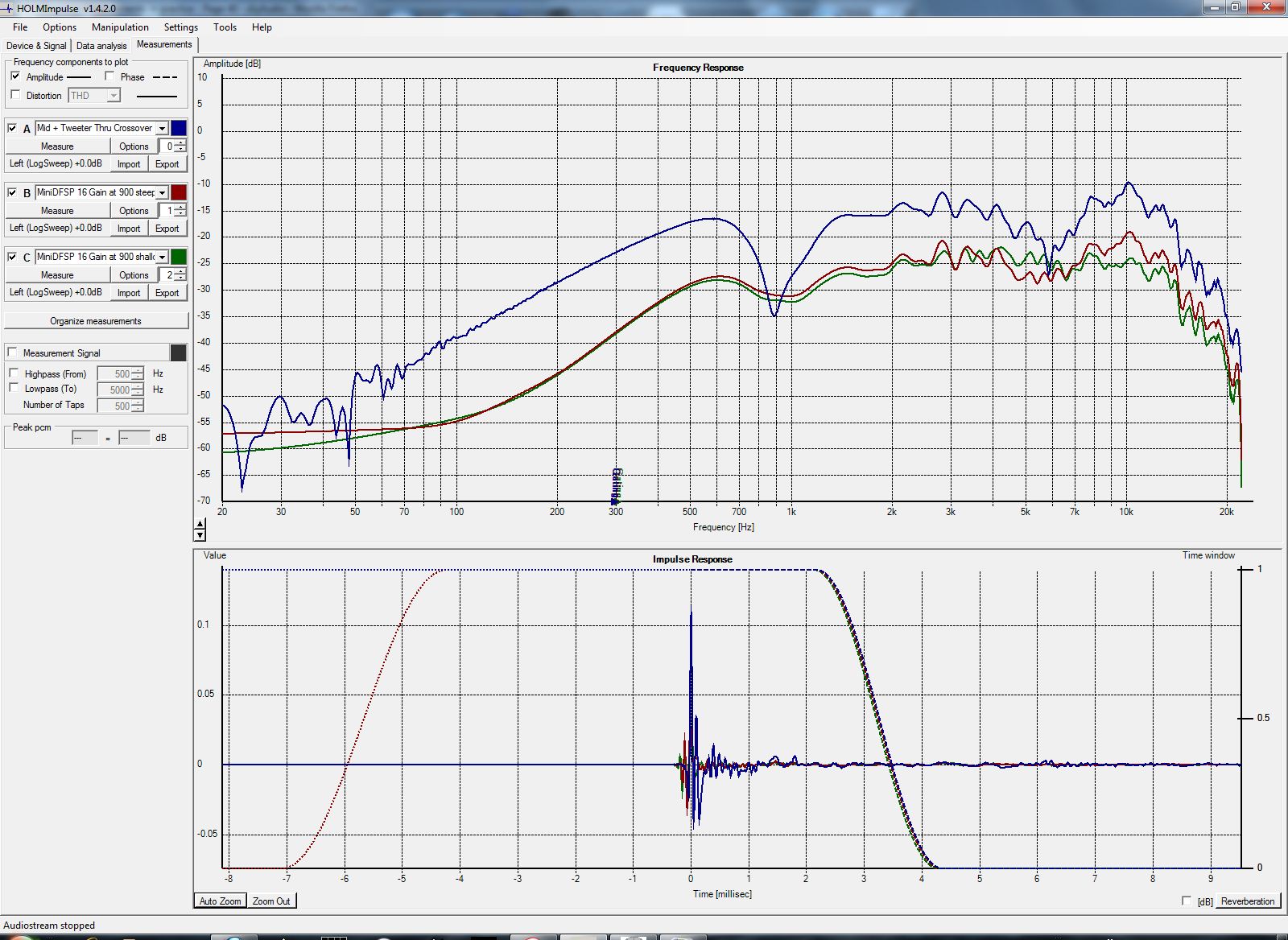

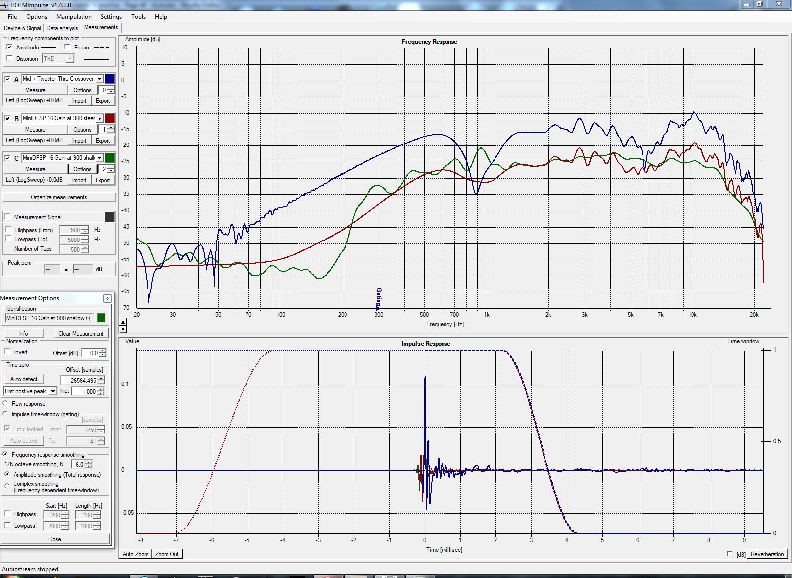

Well I had my first play with the MiniDSP today, it almost did my brain in getting it set-up though. I set it up so I could measure (using HolmImpulse) the response of my Tweeter & Mid against a measurement taken through there passive crossover.
I think I have made some improvements, the blue line is the passive crossover measurement showing the major dips at 900hz & about 6000hz.
The red line is the measurement through the DSP, I had to make a rather large 16db peak at 900Hz to get any real effect, it also had to be done with a steep slope to get it to work, the dip at 6000Hz is also levelled out somewhat.
The green line is basically the same as the red with minor adjustments.
If you compare the green lines in the three jpegs it gets confusing.
What confuses the hell out of me is why the response looks so different when is is smoothed (1/6th), basically the dip at 900Hz turns into large hump. the raw data agrees with the smoothed response.
So which one should I be working to, gated, smoothed or raw?
