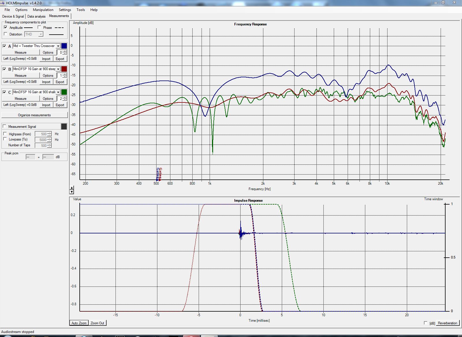

The dip shown in the blue line (my SABA mid) is always there, with passive crossover or without any crossover, it also appears when the terminals are inverted.
For the the measurements I did in post 400, I way using one amp, one channel to the mid & one channel to the tweeter. The Red & Green lines are thru the MiniDSP as the crossover & my attempt to eq out the dip.
My problem is, HolmImpulse shows the dip, (Green line) at 900hz, only as a dip if you view the gated measurement. If you view the measurement Raw or Smoothed it is a riser.
So which one is correct, Gated, Smoothed/Raw?:confused:
The gated response isn't accurate below 1000 Hz:
The time graph shows that gating stops at about 2 mS, and a correct curve starts at half this time = one millisec which is equal to 1000 Hz.
The most accurate is the raw curve.
What happens if you increase the Gating time to 6 mS?
It depends on your measurement conditions and what you are trying to see. If you want to see the anechoic response and are measuring in a room, you must use gating and the response will only be valid above a certain frequency (indicated by the gating note) which depends on when you have reflections arriving at the mic. If you are looking at a raw (ungated) response and then smoothing it, of course those two measurements will agree.
I set the gating to before the first reflection should arrive, I thought that was what you where suppose to do:confused:
See below for gating at 6ms, it looks like dipole baffle effect?

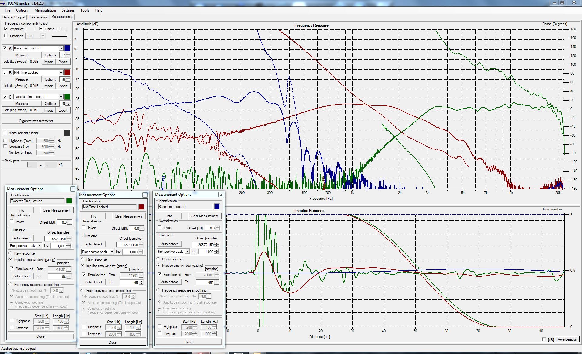

I have tried to take some time measurements of the new speakers, so I could apply a delay for the Mid-Tweeter drivers using the MiniDSP, as expected the Mid & Tweeter appear to be aligned well enough (from my reading) but the bass driver appears to be in the next room
I would say the physical horizontal distance between the MT & bass driver is about 40mm (bass behind MT). Does anyone know how to interpret these measurements.
Oh and I have no idea what the phase is trying to tell me so some help there would be greatly appreciated.
David
David
When you connect the output to the input of your soundcard you see the perfect phase what also your speaker shout have. thats easy for comparison.
DQ828: Your phase looks quite right for a 3-way.
Every crossover point with a 4th order filter, makes for a phase shift of 360 degrees. The phase response starts to change approx. 10x below and 10x higher than the attack frequency.
Normally all frequency analysers anticipates 360degrees = 0 degrees, because you have moved to the same point at the next cyclus. Your signal will actually be delayed 1 cycle, which means that the delay in mS will depend on the actual frequency.
Normally the phase shifts are not directly audible, so you should just base your choices for level of delay on each frequency area, on the impulse response. Even that looks nice allready on your graphs. How does it sound?
