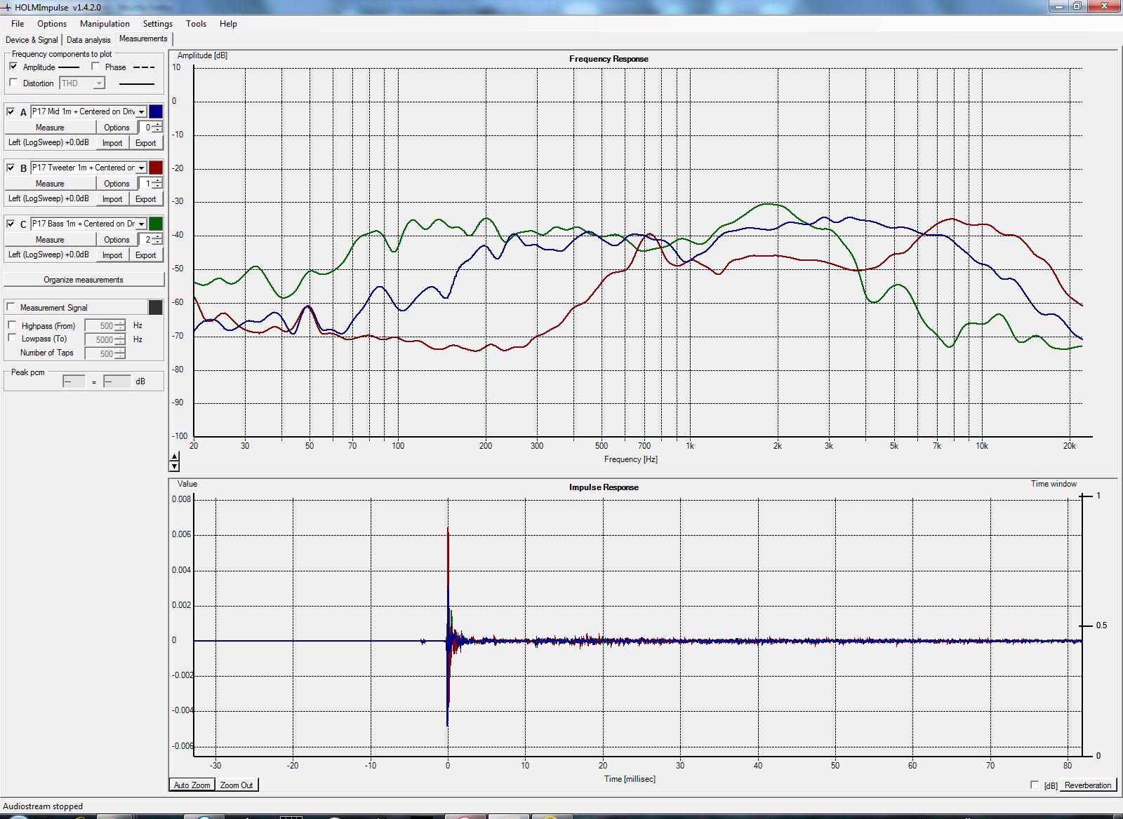

Well Iv'e measured all of the speakers with no crossover, I am working towards trying out a MiniDSP setup for these speakers as a trail run until I build my new speakers.
It looks to me that I should be crossing them over at about 250Hz & 6.2kHz
Given that the speakers are too heavy & difficult to take outside, I'll just have to live with the distorted room measurements.
Is there a better way to measure the bass driver or shouldn't I bother?

Polarity of the mid will depend on your crossover and distance between drivers. You can check that with the phase plot. You'll have to lock the time, tho.
It looks like you are getting there. Just bring your measurement levels up some, they are very low. Maybe you should be doing your sweeps louder? "Torturing Aliens" my wife calls it.
Either that or bring the mic gain up.
Otherwise you are on the right path, bravo!

Yes I agree I am getting there still lots to learn though. I will raise the volume as the setup starts to clip if I raise the gain to much. I have been sick all week & doing the mowing/gardening today almost killed me, so I dont have any energy left for the fun stuff. Hopefully I be back in the saddle tomorrow.

When you say it clips, where does it clip? At the mic preamp? Or in the playback side? Obviously the digital side isn't clipping, you're 40dB down. (is your record volume set to max?)

Its been a combination of the M-Audio Pre clipping (flashing clipping light) & last tiime I did the measurements HolmImpulse told me it was clipping & I needed to turn the volume down. I use my daughters laptop to do the measuring so I have to also fit it in around her.

Well if the M-Audio is near clipping, then the volume most be turned down somewhere. You should not be getting traces at -40dB.
Do you watch the VU meter when you do a sweep? That might tell you something.
Altec Best has been having a similar low end distortion problem. I found that it was software related. Make sure the M-Audio control panel is set to 16 bits. Use the ASIO drivers if you can. I've had to reboot to clear the distortion. I think some other software (or Windoze) has a handle on the card and can cause problems. Just don't know exactly what, yet.

Bass drivers are usually measured in the near field. That is, move the measurement mic to within about 1/4 inch of the woofer's dust cap. Turn down the gain from that used for your far field measurements.
You can splice the near field with the far field afterward.

Here's how you set the gating. First, it's done after the measurement.
Then click on the auto zoom button down in the impulse response window. The smooth impulse response curve will appear and also another, dashed line curve. Click on the dash line curve with the curser on it and you will be able to move it left or right. At the same time your moving it notice the gating lines moving left and right and the shape of the response curve changing accordingly. Ideally, try to get the gating located around 200 hz. Then, the data above 200 hz will have been gated and represent a quali-anechoic response.

Thank you. the major bit I was missing was the "First, it's done after the measurement." Everyone, everywhere just says set the gating, so I spent lots of time trying to work out how to set it before a measurement was taken

Room mode effects on far field measurements kick in below 200 hz which is why the gating is done.
Nearfield measurements on the woofer simulate 2 pi measurement conditions (as if the woofer was installed flush with the ground outdoors facing up) where the room modes can't become part of the measurement because the volume is so low for the NF measurement.
