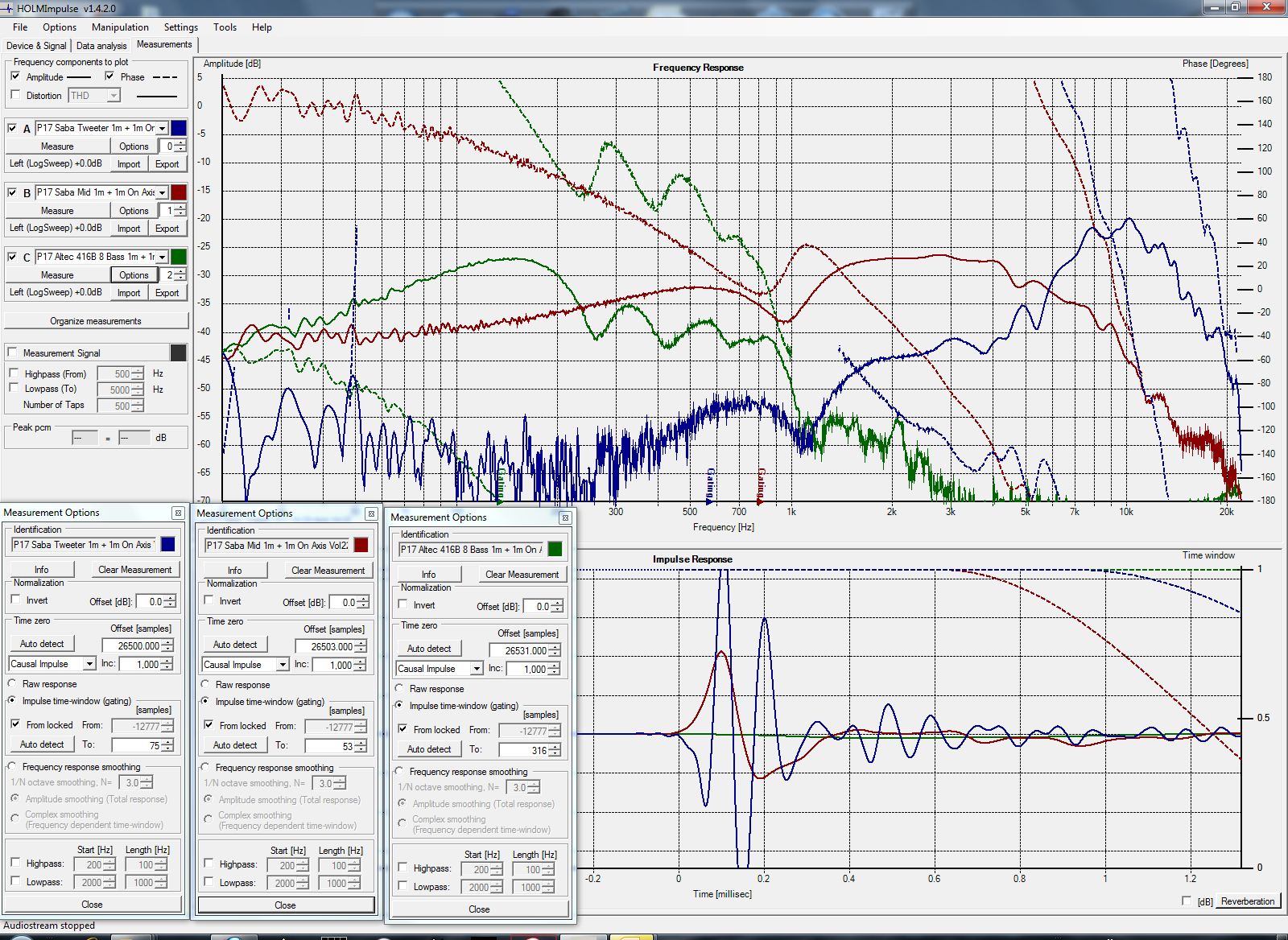

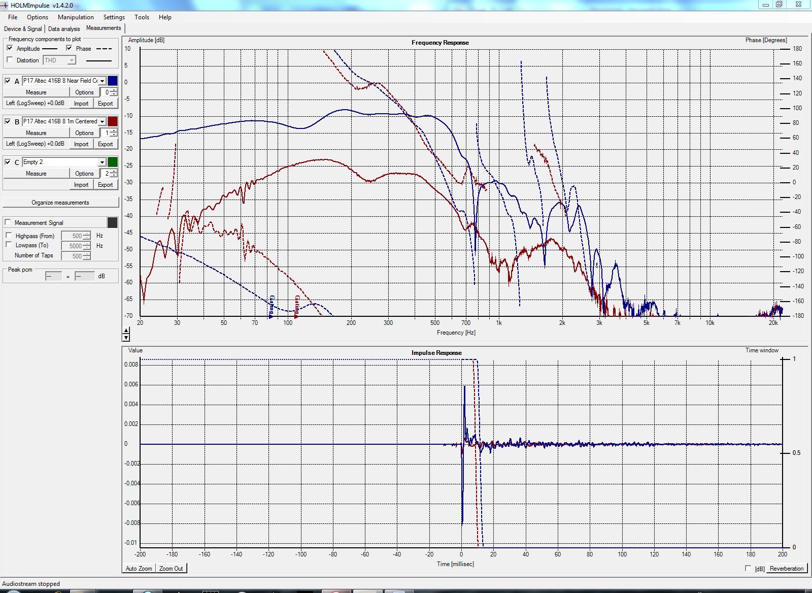

This is my first attempt at measuring speakers properly. I have measured the Lukasz Frikus P17's. I placed one of the speakers in the middle of the room, 3m clear front & back & 2m clear on both sides. Mic is at 1m on axis 1m above floor, about in line with the tweeter.
One jpeg shows the three drivers done separately, but still run thru the crossover, I just unplugged the appropriate drivers.
The other shows all drivers at once.
The Bass driver measured much better near field, which is shown in the last jpeg, one is near field & one at 1m
The Mid doesnt look like it has a high pass filter?
The tweeter is higher than the rest which tally's with my hearing, While listerning I have previously lowered the output on the tweeter via the reciever,
Doesn't look pretty, I'm not sure what the MAJOR dip at 900Hz & 4.5K is all about on the combined sweep. And these are the speakers I think sound great😕
Once again I'm a complete beginner at all of this so maybe I'm doing something wrong?
Any thoughs guy's

...the three drivers done separately, but still run thru the crossover, I just unplugged the appropriate drivers.
no, no, no, no......in this situation (where you're also measuring the effect of the crossover) you need dummy loads at the disconnected locations. Use a resistor equal to or a bit greater than the rated impedance of the disconnected driver. So, for an 8 ohm nominal driver, use an 8r to 10r resistor!
Also, the plots are cluster-f#*@^s. I would uncheck the phase and distortion options and forget about those for now...just focus on getting a clean impulse and FR
I think your measurements are still contaminated by something (as Earl pointed out in post #303). Have you tried making a soundcard calibration ? If so, what does that look like?
I agree. Start from scratch.
Clear you measurements and do a loopback test of your soundcard. Uncheck the Mic and DAC/ADC buttons. You should get a good, straight line and very low distortion. If you don't, you have problems.
I was doing that with the loopbacks and getting flat lines low distortion and then you go to measure and it was like 100% distortion.And some of the responses had a contamination looked like.
BTW; Pano Thank You so much for your Stellar deductive reasoning ! 😉
Yes I have done the calibration & the line ended up flat thru to about 17-18Khz I redid it many times but that was the best I could get.I am running it thru a M-Audio Pre Mobile. I did have to turn the volume down to get the flat line, which I didn't do when I was measuring.

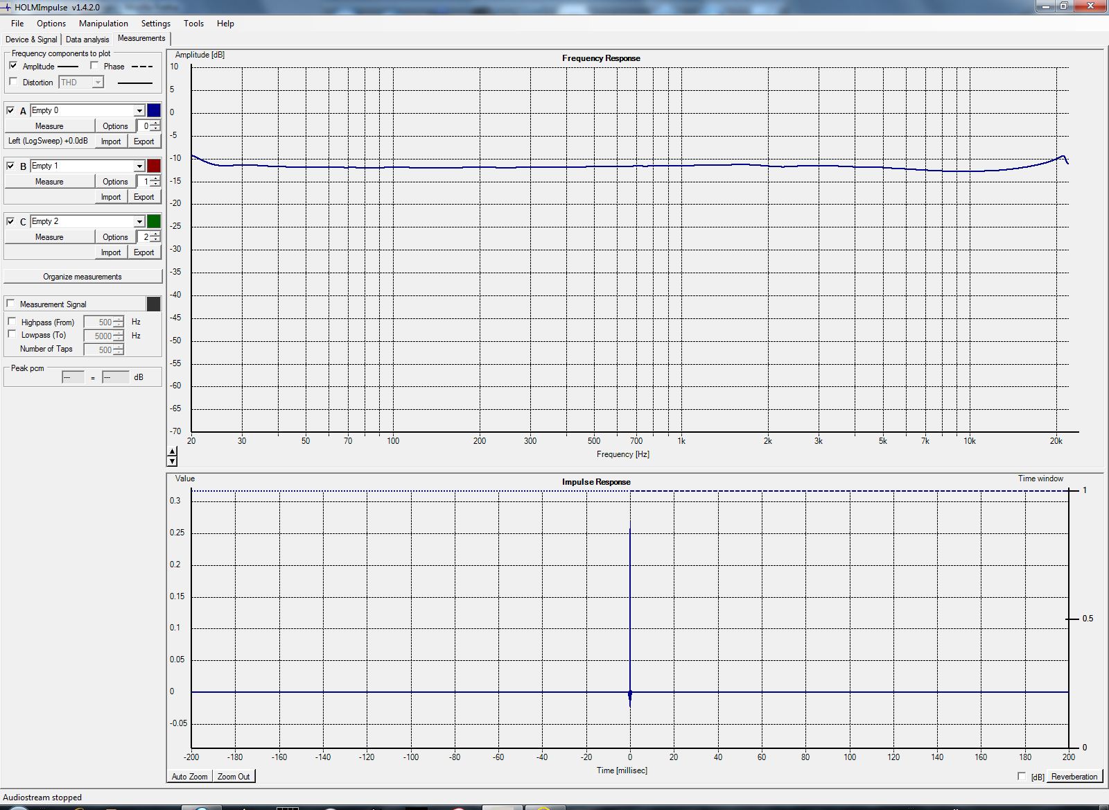

Loop Test
I have done the Loop Test as suggested, you can see it below. It looks sort of OK to me not dead flat but not too bad.
When I was measuring it's possible I had things turned up too high, as I had to turn the input etc down to get a valid measurement.
What do you think?
Thanks for posting that.
Sure, it's not as flat as it should be, but no major problems. If you do the soundcard calibration, you should be OK. Do that and post again, so that we can see. The calibration will generate 3 measurements.

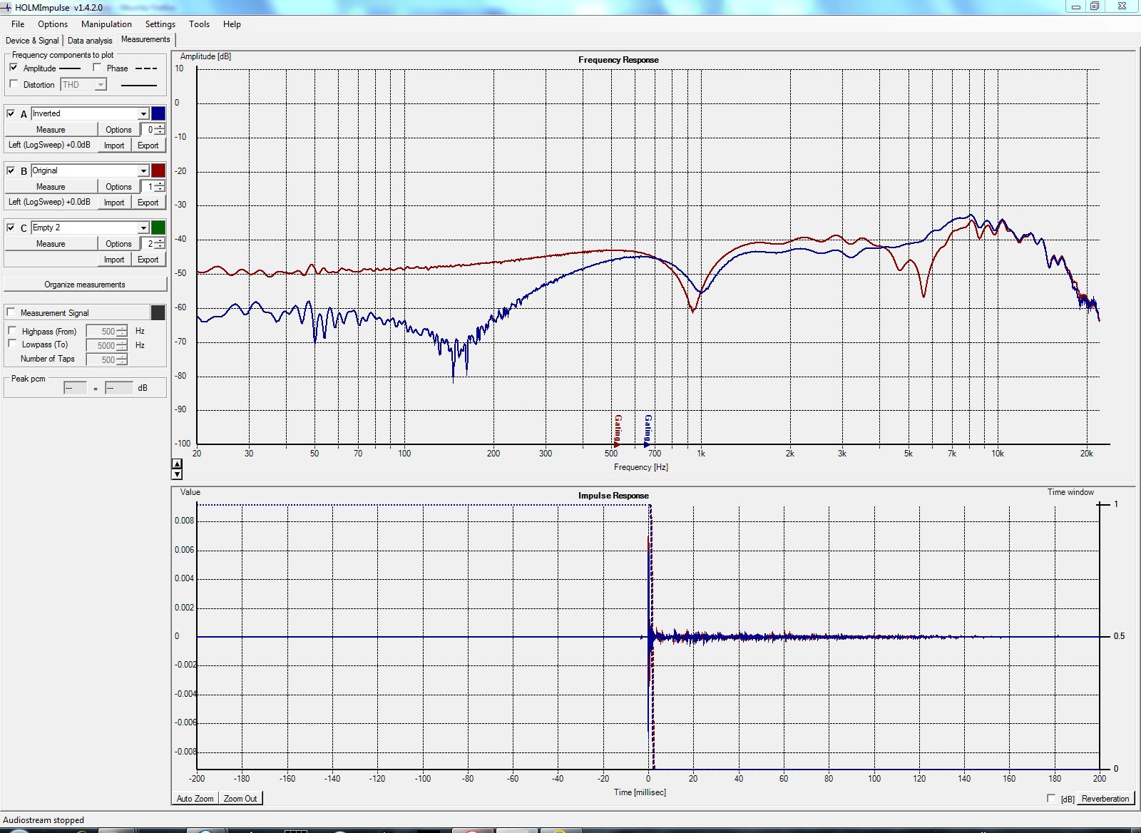

I have been re testing the speakers. I inverted the mid as somebody suggested I show the results below.
The blue & green are the left & right speakers tested with a sweep, the red is the left speaker tested with the mid driver polarity inverted.
What do you think?
Why do you think the bass drops away on the inverted measurement, I redid it many times & they where always the same.
I will redo the calibration next, but I dont remember the last calibration generating three measurements

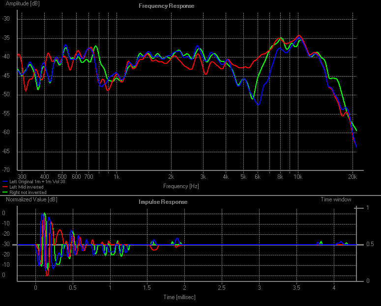

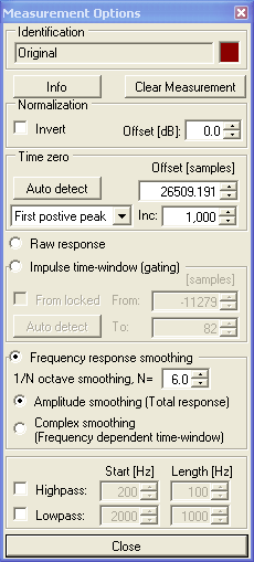

I notice you have the gating set differently in each case. Go into options and set it for all of them the same. You can do it by working out the first reflection manually, or by finding the reflections in the impulse response window.
The number of taps seems to relate to the low end roll off, but in this case you really should disregard measurement below the gating line.

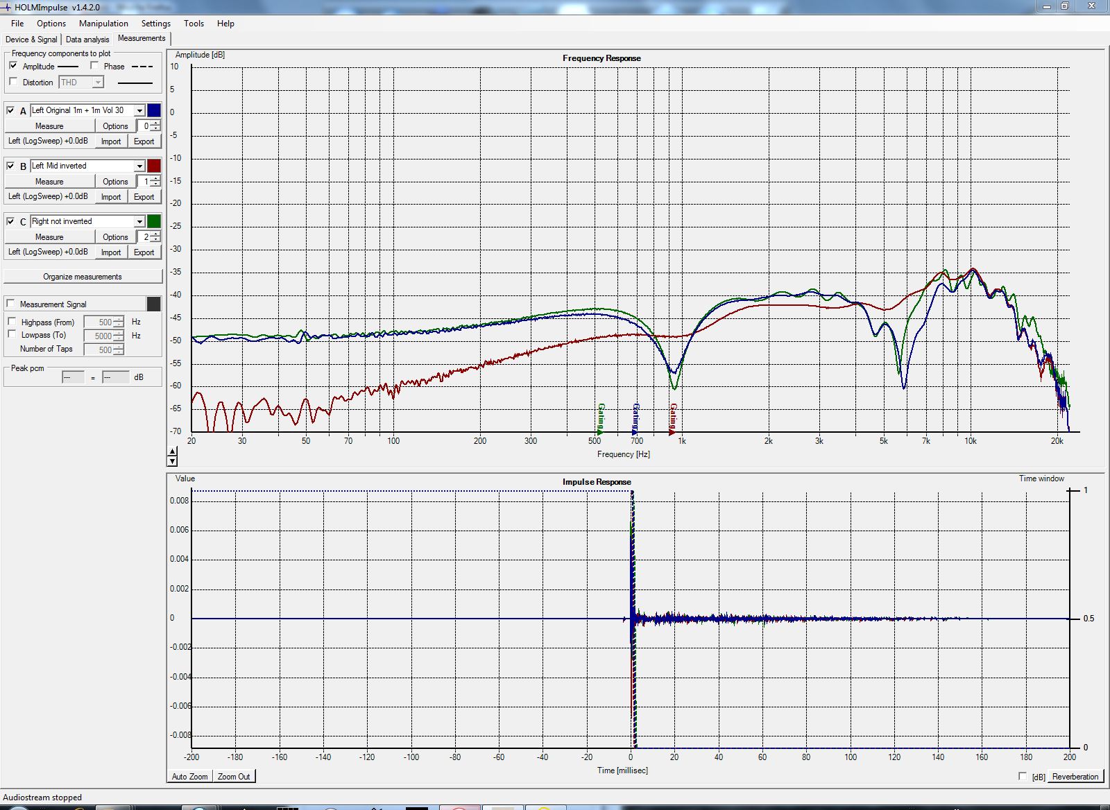

Measured Again
I did the measurements again after the recalibration & it now does not look as good inverted.
It is setting the gating itself, I have not been able to work out how to set it😕
Should I measure on Casual Impulse? or what?
Just go into the Options tab of each measurement and check the frequency buttons so it looks like this. That will remove the gating. Set it for 1/6th octave smoothing for now.
You might also try each driver again alone, to see what you get.

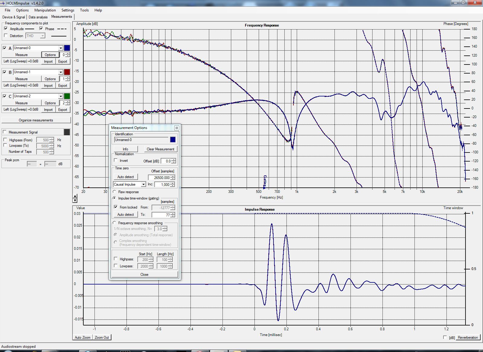

Raw Driver
I have set as advise with 1/6th smoothing.
The measurement is again of the mid in its original configuration & inverted but this time with no crossover.
I'd say the inverted one looks better but not by much.
