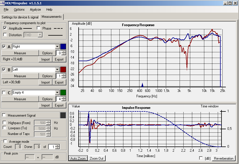

I have attached a measurement of my girlfriend 's speakers (Rega EL8), where the manufacture had the mid/woofer out of phase in the one speaker causing the dip at 4 kHz
(It's of course resolved now...)

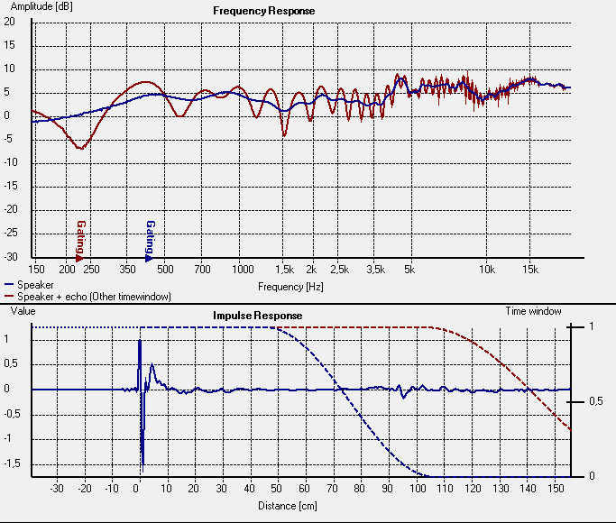

My attached an image, which shows the same impulse-response, but with a different gating. (Notice the floor reflection with 100 cm extra path)

askbojesen said:
Yes, the Realtime gating is learning you what reflections do to the response. Why don't you use a time window / gating on your measurement then?
To see the LF too.
An nice feature ARTA has is that the area wich is not a valid result marked yellow.
Measurement "dummys" will be happy if they put a short gate an have a flat amplitude...

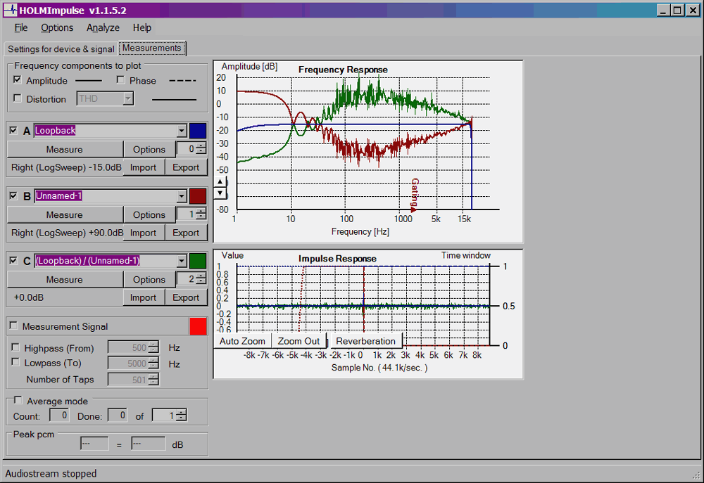

>> I cannot find this big clear (grey) area - please post a screenshot
I had mentioned this also (in the other thread), seems to be related to screen resolution and/or a user specified font size...
(see attachment)
- Klaus

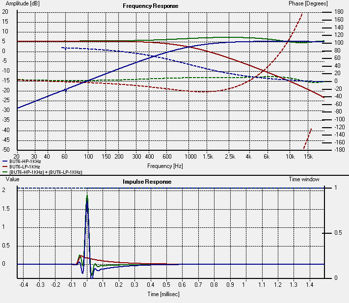

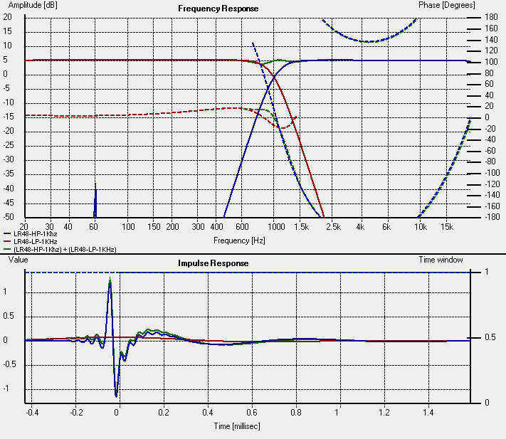

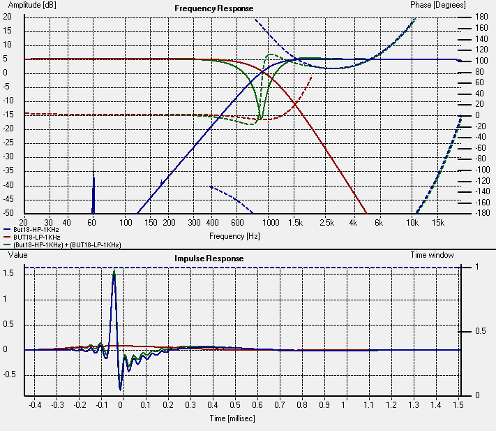

Here are 3 measurements for you.
Signal path = USB>M-Audio Duo>Spdif>DCX-M-Audio>USB
Calibrated on analog loop, but digital thru the DCX looks almost identical. tiny phase shift in the low end between analog and digital.
Here are some sample filters from a stock DCX2496. All from same channel (2). All at 1KHz.
First order below.
