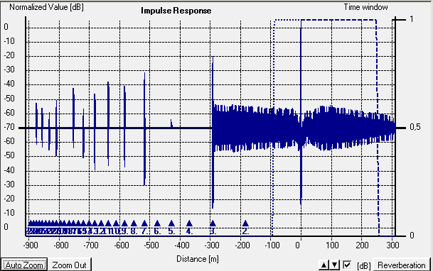

After measuring a few electrical circuits to check if all is well I measured my coax nearfields today at ~25cm distance (but with a VERY crude "measurement" mic and q&d setup, you don't wanna know. Look at the low sensivity and the ~3% THD which is 2nd-HD mostly, dominated by the "mic pre" -- there wasn't any, that is --, the speakers themselves are not *that* bad, same for the mag response😉 ).
Looks pretty nice, the 360° deg phase shift (centered to ~1.6kHz, which is the XO freq of these 2-ways) is clearly visible.
Some small issues I found:
- Impulse start estimation goes wrong. But then again, the shifter works well (a bit slow, though) and is a needed feature anyway. You have addressed that already, I see. EDIT: Sample offset isn't remembered between runs, although the display is fine. No deal, since it's a "relative" value anyway.
- I'd prefer to have a "not always in foreground" option, regarding some displayed windows.
- A initial delay would be a nice option (say 10sec, checkbox) to get out of the room etc before the sweep starts.
All in all, thumbs up! Stuff like the markers to locate the harmonics is really nice.

Yes! Exactly my point 🙂 even with a Quick and dirty measurement you learn a lotKSTR said:Looks pretty nice, the 360� deg phase shift (centered to ~1.6kHz, which is the XO freq of these 2-ways) is clearly visible.
Yes I know that... I have a new version ready later this evening handling this issue with time zero much better. A bit slow? if you set the measurement save length down it will be faster, but you will loose some data.- Impulse start estimation goes wrong. But then again, the shifter works well (a bit slow, though) and is a needed feature anyway. You have addressed that already, I see. EDIT: Sample offset isn't remembered between runs, although the display is fine. No deal, since it's a "relative" value anyway.
Are you measuring lethal high volumes? - or why do you want to leave the room?- A initial delay would be a nice option (say 10sec, checkbox) to get out of the room etc before the sweep starts.
/Ask
New Release: Improved time zero detection
http://www.holmacoustics.com/downloads/HOLMImpulse/ChangeLog.txt
The time zero detection failures in above measurements made by Klaus and panomaniac should be fixed now.
(Try measure again with the new default settings)

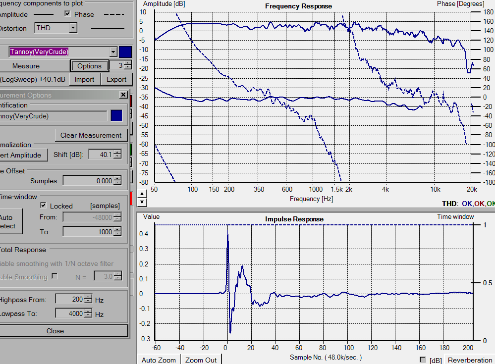

I've been curious, so I tried it a bit today. After some fumbling around with XP and one of the sound cards installed, I got a measurement. The card is a Turtle Beach Fiji (44.1K sampling limit) that I still use with LAUD for measurements. It has a built-in high quality mic pre-amp. I use a dual-boot setup for Win98/XP Home Edition.
I tried to do a calibrate of the card, but could get no further measurements afterwards. Other apps that used the card would not output, either. After unistalling/reinstalling it cleared up. I also made sure that windows was set to no sounds (it was blank in the setting). The card shouldn't need a calibration andyway as it should be down at most 0.5db at 20K.
The driver is mounted on a 2m x 2m baffle with the mic at 0.5m on-axis.
The problem I have is that below 1K, I don't get good agreement. It likely has to do with the window as this area changes more with the window selected. I believe that I used a half Blackman-Harris in LAUD. It would be good to have options for type of window (or have I missed that?).
The measurement capture:
Overlay of LAUD and HOLMImpulse (using Praxis for display only):
Dave

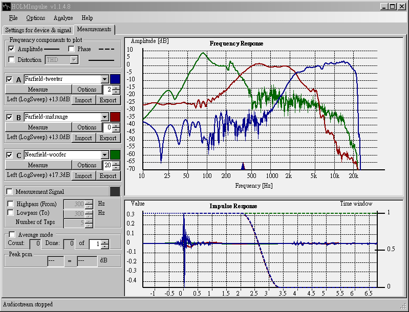

Hi Ask
The latest version is stable under Vista 64 - thanks. But I don't seem to get any of the pre impulses from the harmonics.

No pre impulses from the harmonics
1. The measurement save length must equal the signal length
2. You must use log-sweep
3. Try ZoomOut and the dB scale
NB: In the next version of HOLMImpulse you will get an option to autosave the direct correlation as a wavefile for your own analysis
Perhaps post the graph?
