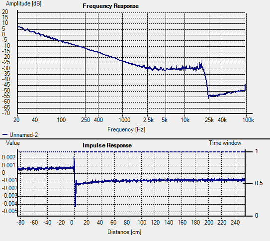

Is this normal?
I need to take measurements of my set of speakers, and I recently started using HolmImpulse for that.
I use the following equipment: a UCA202 USB audio interface.
Without any mic connected I got the response I am showing below. Is this normal?

No this is not normal - I'm not able to see what is wrong in your setup
- Try 'Data Analysis' > 'Save waveforms when measuring' Then you can see what the recorded signal was
- Remember to check your windows mixer settings
- Perhaps try a lower samplerate

I still do not know what is going on, exactly, but after experimenting some more, I found out that the UCA202 is feeding part of the output signal to its input interface... this may explain (I guess) the above results, as well as some other erratic measurements I got, which I thought did not make sense.
Additionally, I noticed that Holmimpulse used to complain about clipping levels of input signal when using the input and output interfaces of the UCA202 at the same time.
It also complained about the signal being too low when the microphone input was the built in line-in of the laptop, and no microphone was connected, but it does not complain when I do not connect a Microphone to the input of the UCA202. I wonder why this is.
In any case, it looks like the UCA202 is either inadequate to being driven simultaneously through its input and output, or my unit is defective...
Using the UCA202 for input and a different device for output seems to produce (apparently) more sensical results.

That is simply when the recorded level has reached 100% during recording
(you can see the recorded waveform using Audacity - then you can see if the signal has indeed been clipped)
