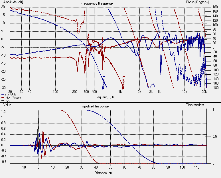

Here's my first two measurements worth uploading
Blue is a 3 way AS classic speaker.
Red is a 2 way AS classic speaker - different brand. Red one'w woofer runs full range w/no series coil. Wonder why all the phase inversions.
Blue one was measured on the floor. Red on was measured a couple of feet off the floor.

Mr. Holm. What does the dash line in the impulse response represent? It curves down from the top of the graph and slopes down to the right.
And, why can I take one dashed line and move it to match the shape of another dashed line if I have taken two measurements?

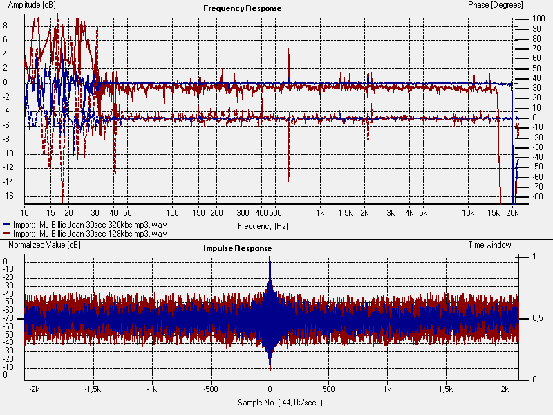

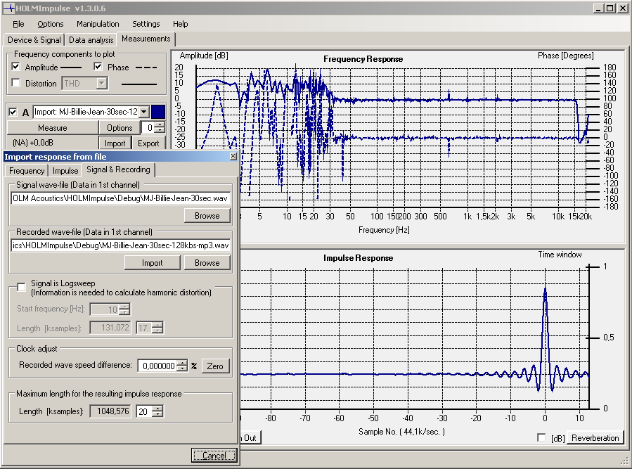

Perhaps you want to try the 2-channel correlation?
Options > 'Import response from file' > 'Signal & Recording'
Signal wave-file should be your original wave file
Recorded wave file should be your modified wave file
Then also try the dB-option for the impulse response
Like I did here with mp3-files:http://www.diyaudio.com/forums/showthread.php?p=1913539
attachment.php
attachment.php
That is how I did it. It's just that I did the invert cancellation prior to the correlation. The correlation on it's own was a little hard to interpret without the inverse cancellation prior to correlation. Basically if I don't do the invert isolation all I get is a perfectly flat FR and PR.
Ok, sorry - did not read enough, Yes you get should get perfectly flat FR and PR. But if you choose dB scale on the IR - and zoom in - you should be able to see a difference in the correlation?
I do remember zooming in and seeing spikes before but I guess it just wasn't looking as easy to interpret as my other method. I am not sure what you are saying about the dB setting. You mean the one under options after you take a measurement?
Anyway here is what it looks like if I correlate without doing the cancellation first.
Thanks for the graphs!
I mean the little dB Checkbox in the lower right corner of the IR
I believe what we see here is the noise floor of the file- this is how much the new file correlates to the original.
If you correlate the original with the original we should not get any noise at all
